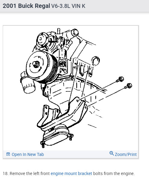

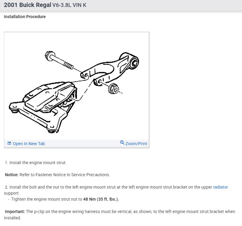

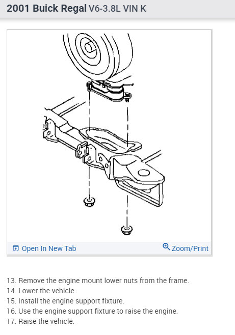

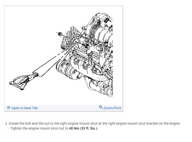

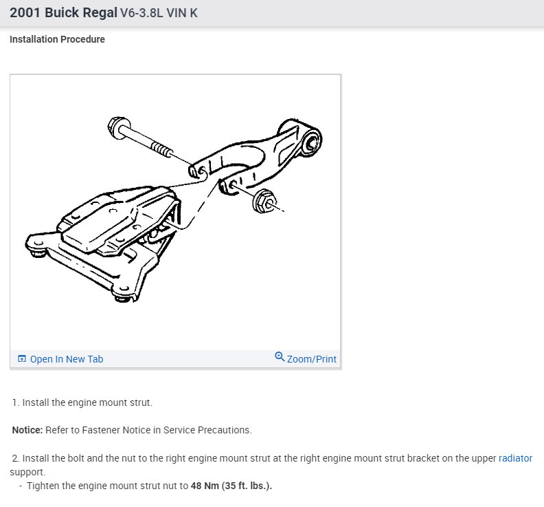

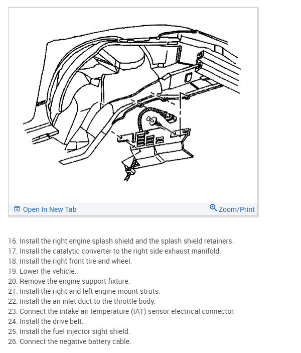

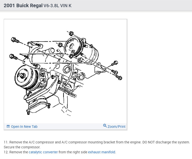

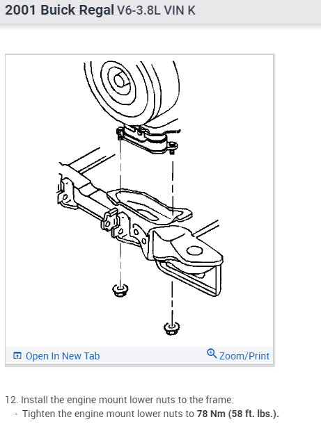

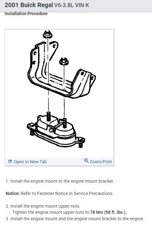

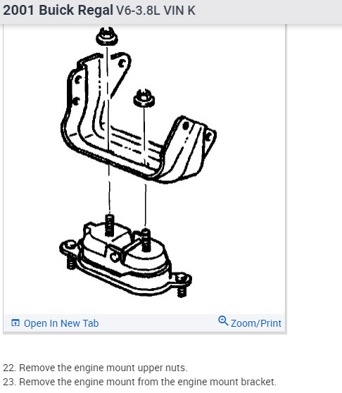

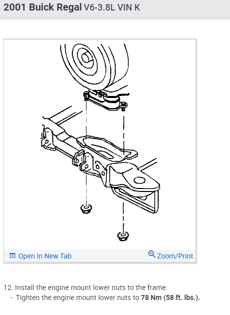

Have never worked on front wheel drive motor mounts. Where are they located?
Jun 23, 2022 at 3:51 PM
SQM
  • 6,383 POSTS

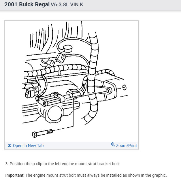

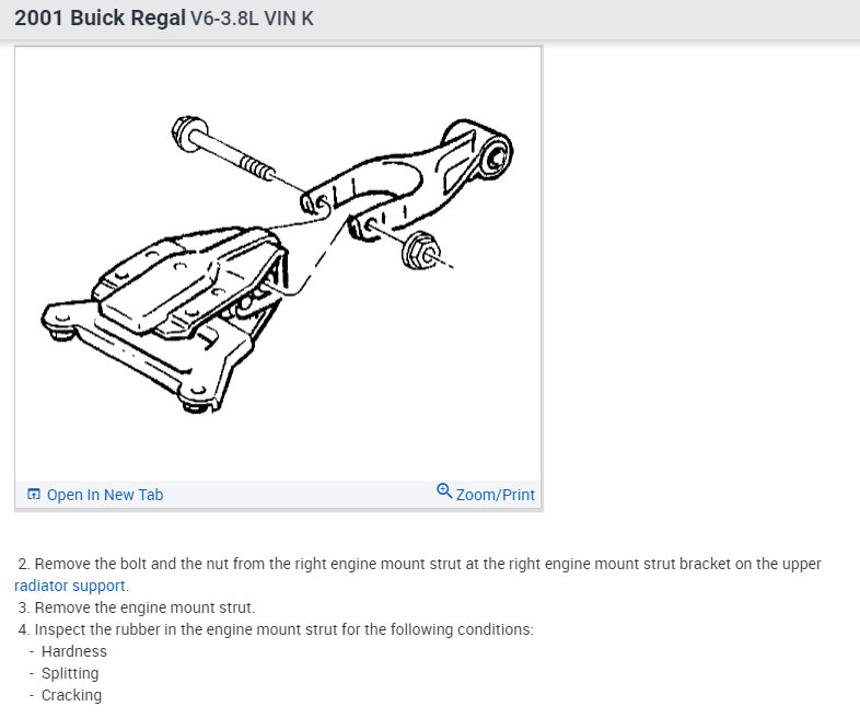

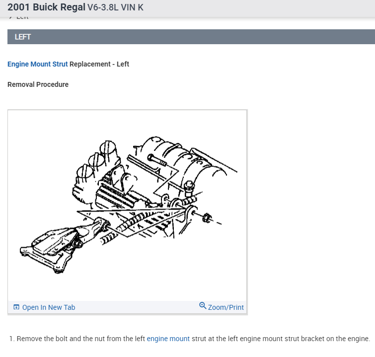

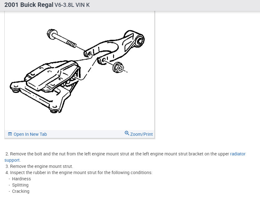

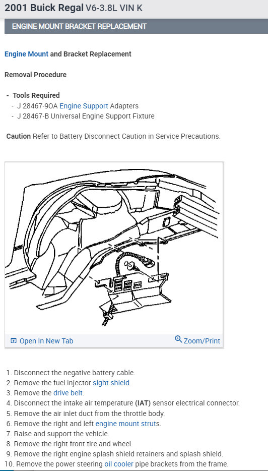

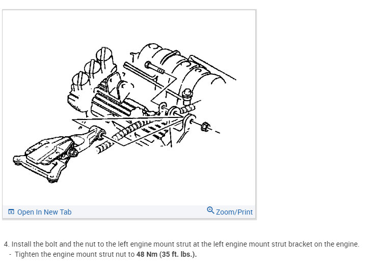

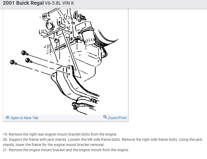

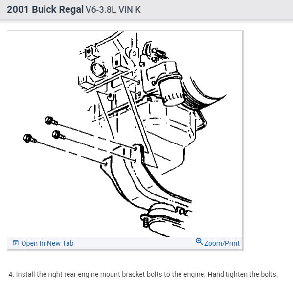

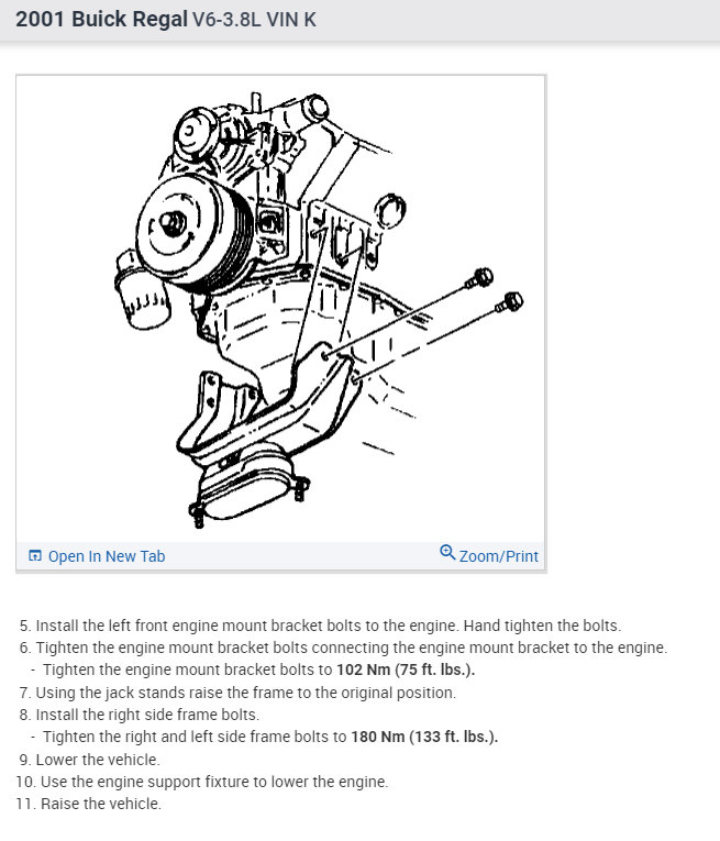

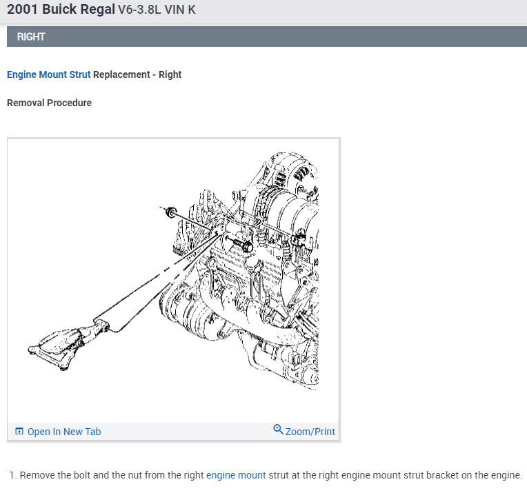

There should be three motor mounts.
One at the bottom close to the oil filter and two on the top, left and right side.
https://www.2carpros.com/articles/how-a-motor-mount-works
Attached are the diagrams for your reference.
Let me know of any questions.
