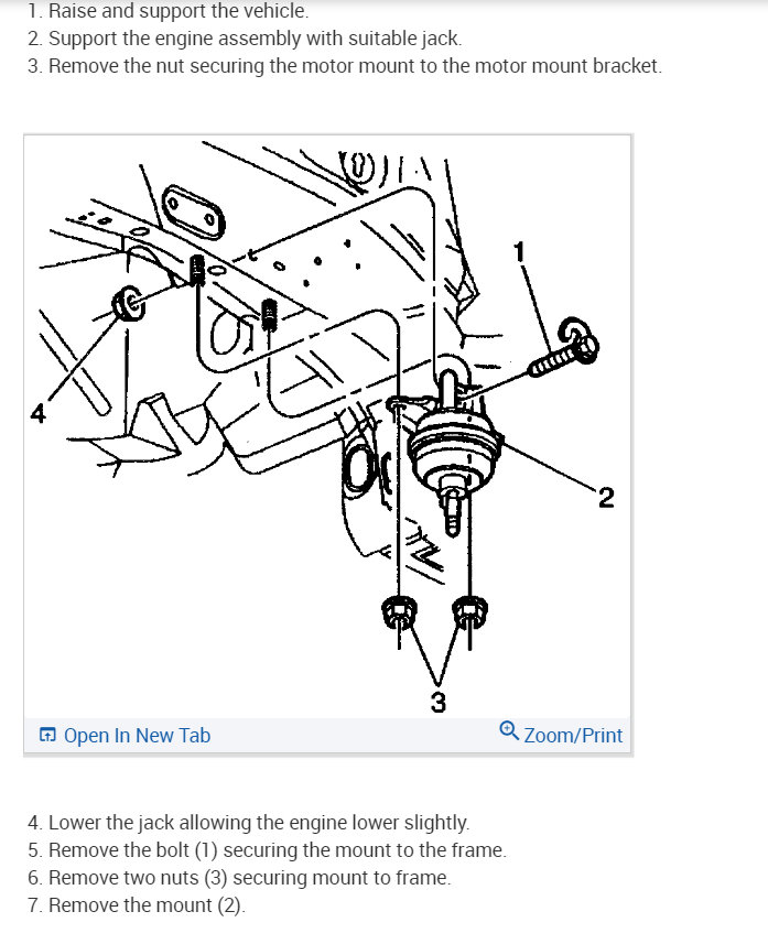

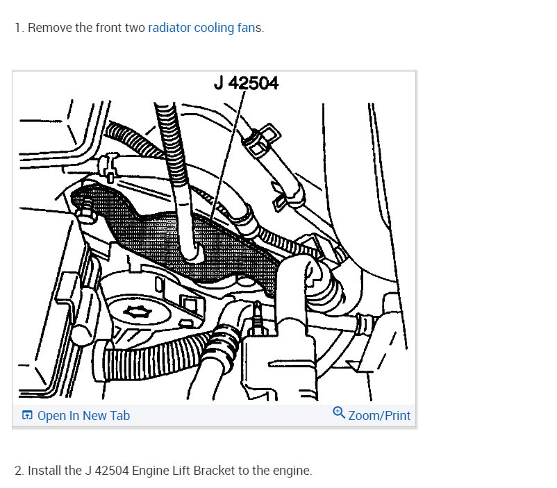

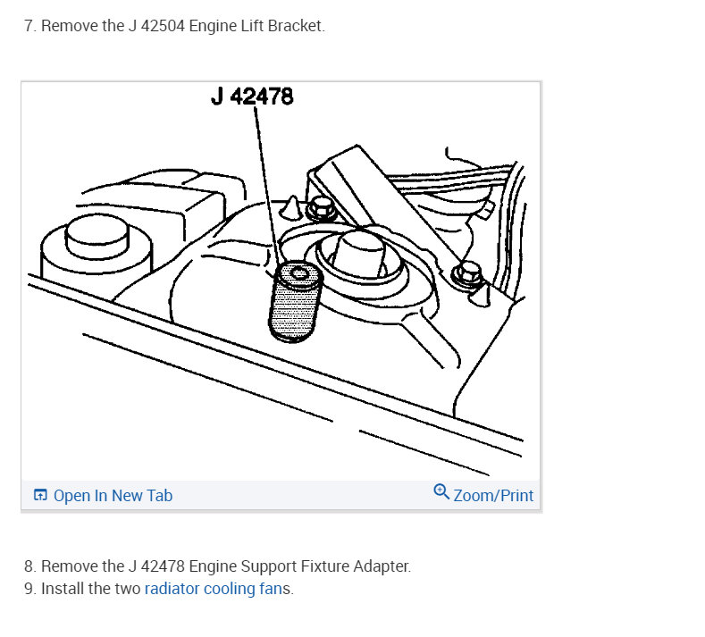

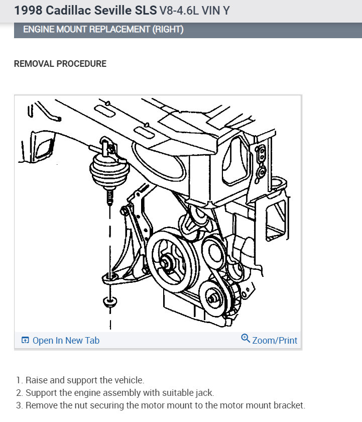

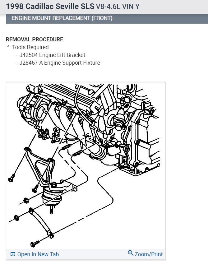

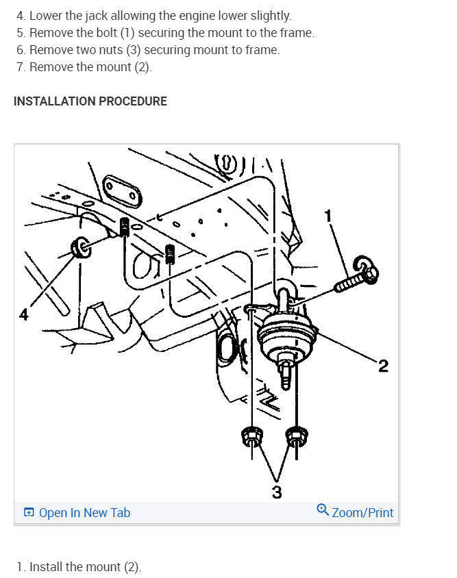

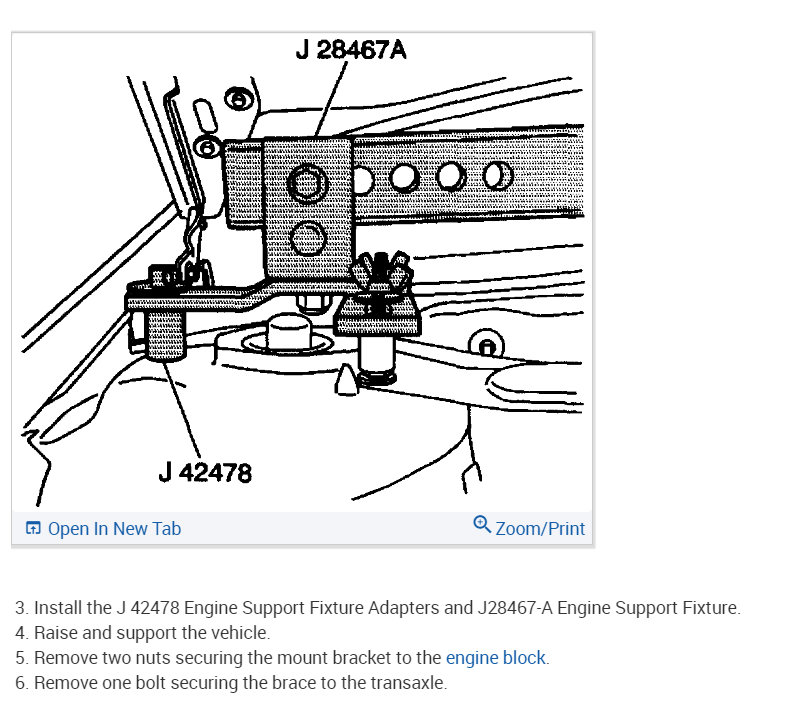

I would like to see a video on how to change the motor mounts on the car listed above SLS.
Sep 21, 2022 at 1:15 AM
Experienced Mechanic
55,583 POSTS

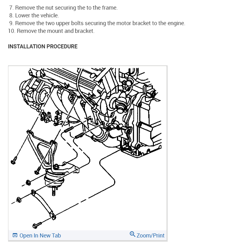

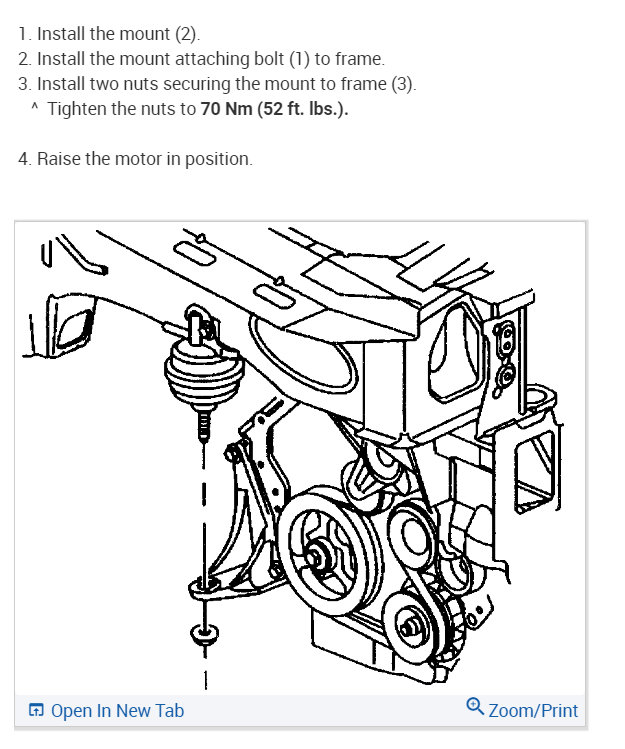

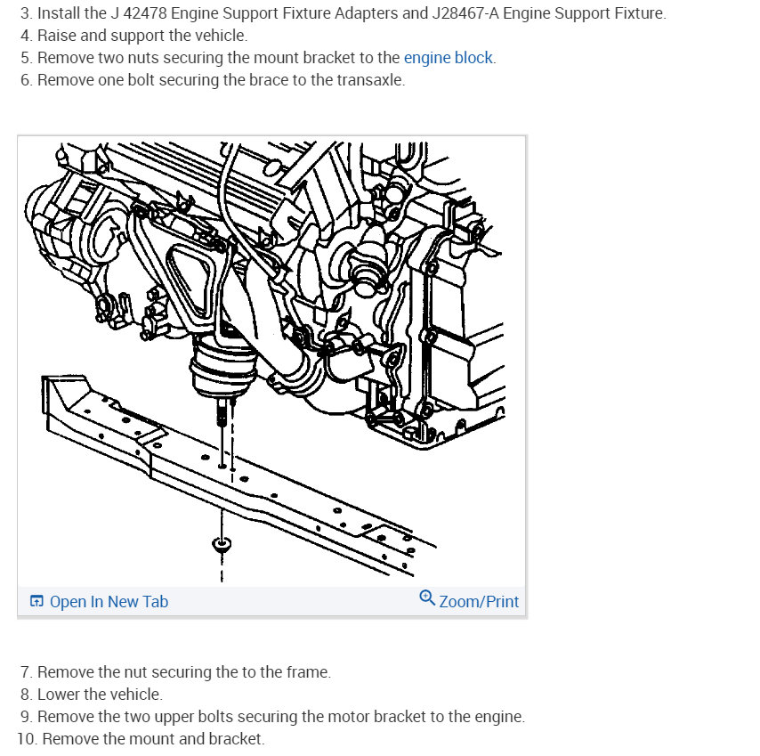

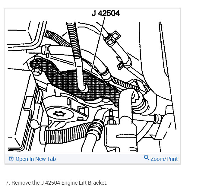

Yep, here you go, I have also included the manuals instructions on how to do the job in the diagrams below which include torque specs.
https://youtu.be/7Dfeo94vX4s
Check out the images (below). Please let us know if you need anything else to get the problem fixed.
