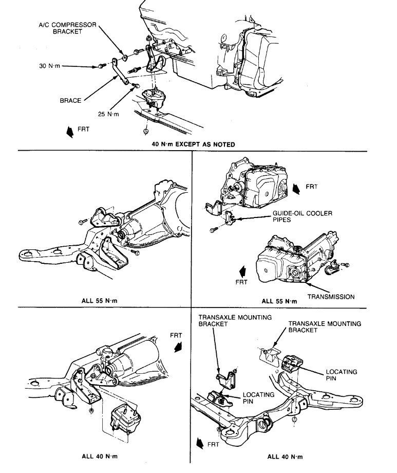

How long does it take to replace motor mounts?
Apr 25, 2025 at 8:34 AM
STEVE W.
Experienced Mechanic
15,384 POSTS
Book time shows 1.5 hours per side, then another hour for the rear transaxle mount.
Image (Click to enlarge)
