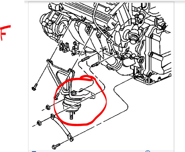

hey guys!! how many motor mounts are in this thing??!! and what is a realistic estimate of time of replacing?? realizing really how intricate these things really are. hard finding people familiar with it....

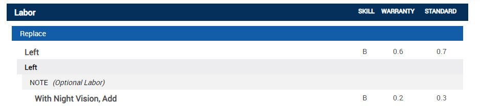

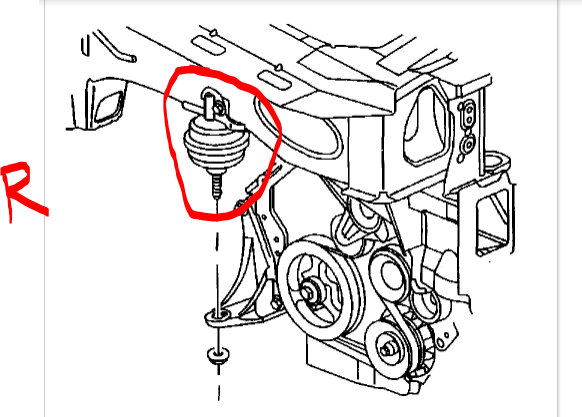

As far as engine mounts, there are really only two. I attached two pics below showing where they are located.
Next, if you look at the remaining pictures, they provide the flat rate time to replace each one. You will need to know what a shop in your area charges to determine an amount.

and it's not showing approximate time for me in pics?
Sep 7, 2024 at 1:00 PM
  • 110,251 POSTS
Pics 3 and 4 are the times. I'm not sure why the parts store is only providing 1.
Right side calls for 1.1 hour. The left is showing 0.7 hour. Note: There is added time if the vehicle is equipped with night vision. I'm not even sure what they are referring to with that one.
