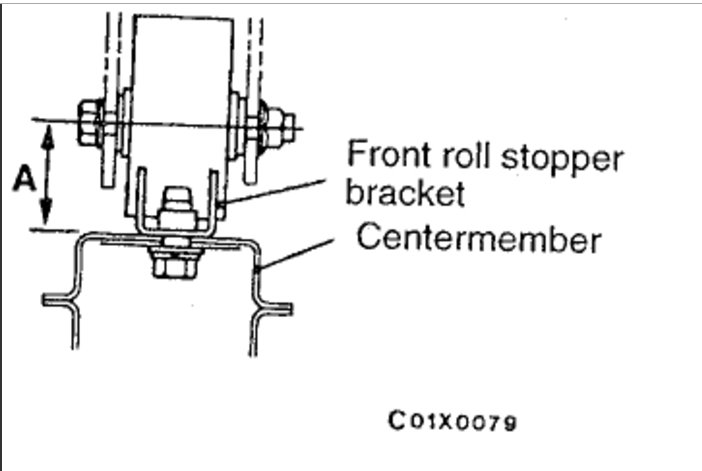

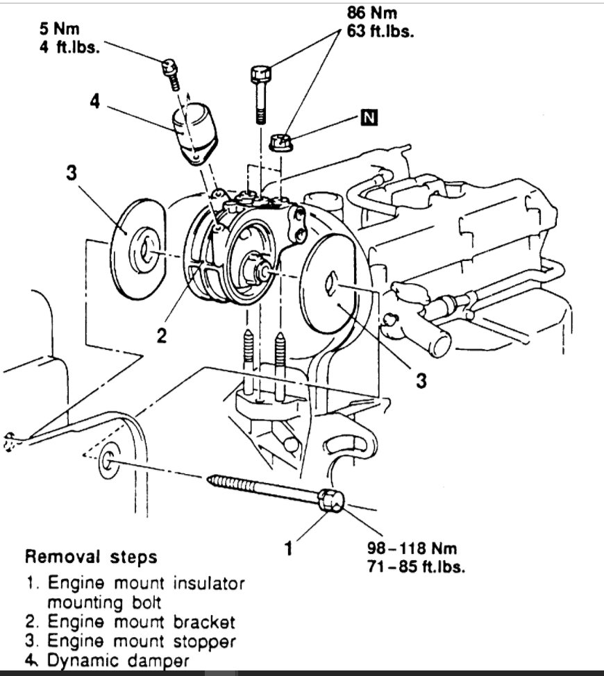

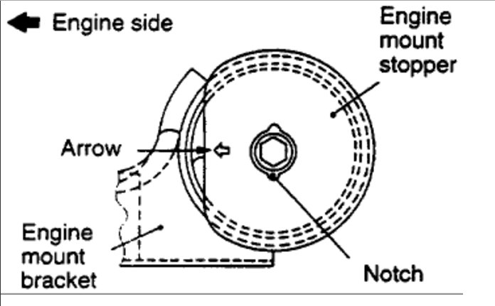

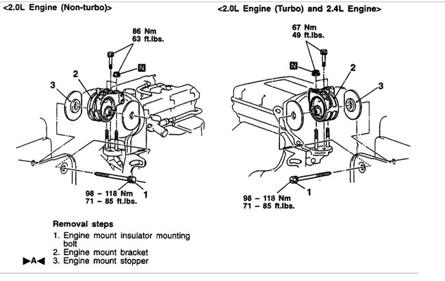

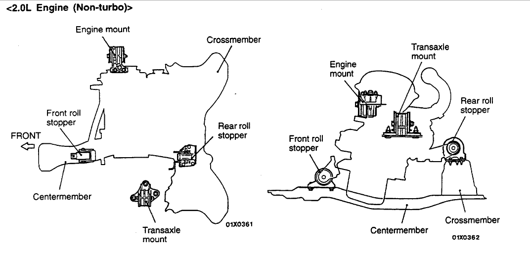

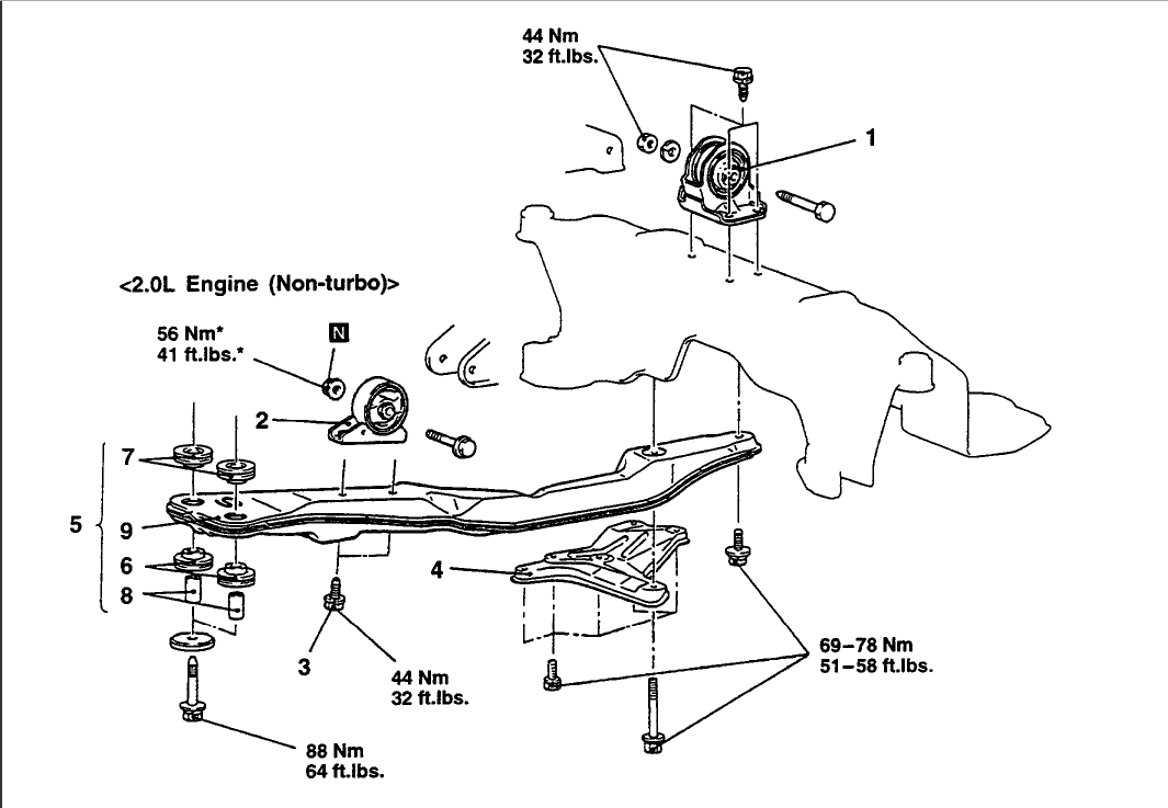

This car is the RS model non turbo. Replacement of motor mounts. What are the torque specs please?
Aug 18, 2017 at 2:52 AM
Experienced Mechanic
55,732 POSTS
The torque specs vary depending on the mount and which bolts you are tightening, I found these diagrams (below) for you so you can do the job right.
