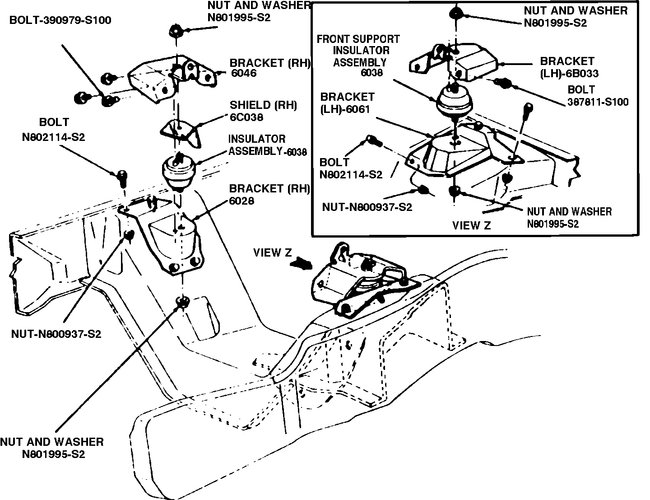

I'm replacing both engine mounts and I forgot to note which way they were before I took them out. I'm putting hydraulic mounts in. Which way do they go?

Here are the directions for replacement. The attached picture is an exploded view. You can tell which way they attach.
engine mount
1993 Ford Truck F 150 4WD Pickup L6-300 4.9L
Front
Vehicle Engine, Cooling and Exhaust Engine Drive Belts, Mounts, Brackets and Accessories Engine Mount Service and Repair Procedures Removal and Installation Front
FRONT
Fig. 3 Front engine mounts
Pic 1
1. Remove insulator-to-support bracket attaching nut and washer. If only one insulator is being removed, loosen the opposite insulator at support bracket.
2. Raise engine slightly using a block of wood placed under oil pan and a suitable jack.
3. Remove insulator attaching bolts and the insulator, Fig. 3.
4. Reverse procedure to install.
