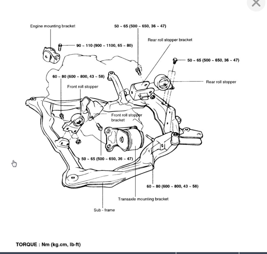

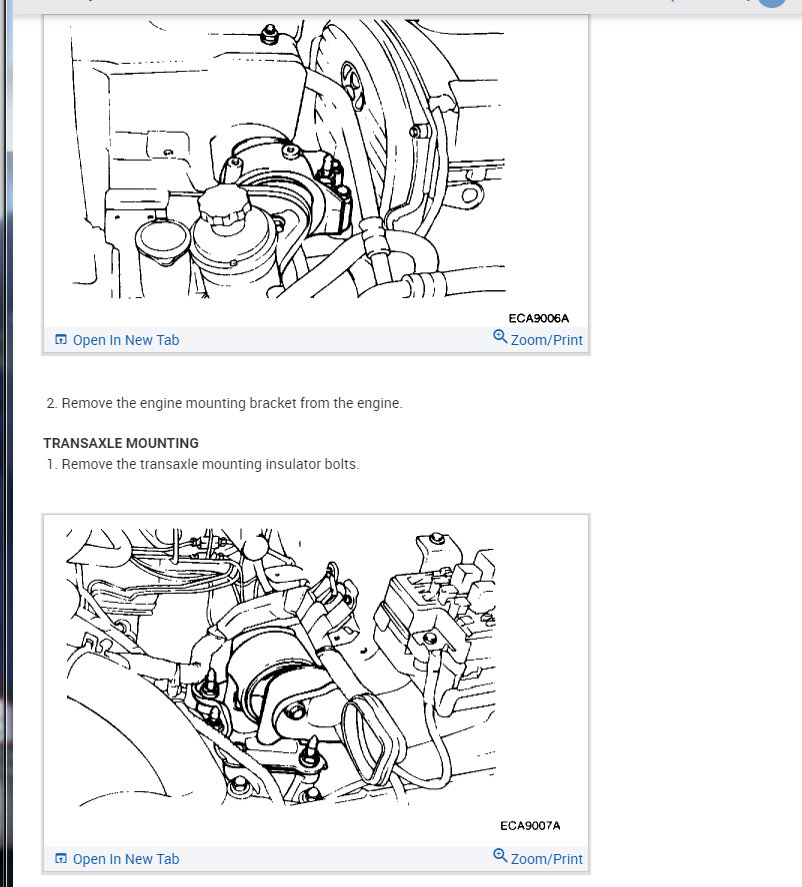

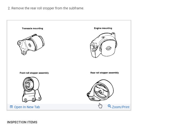

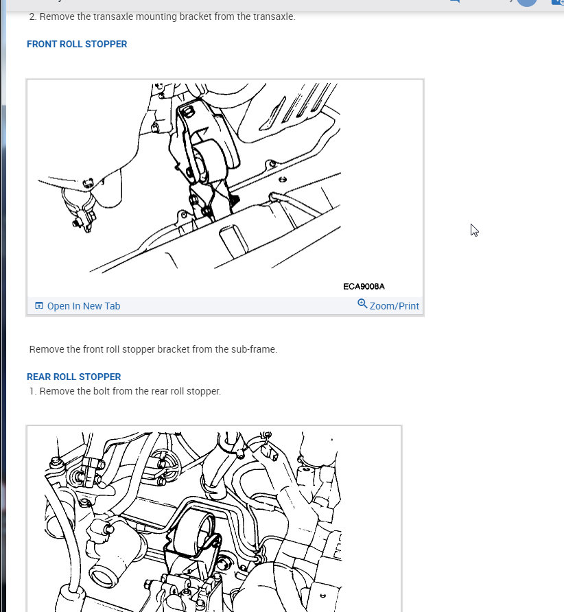

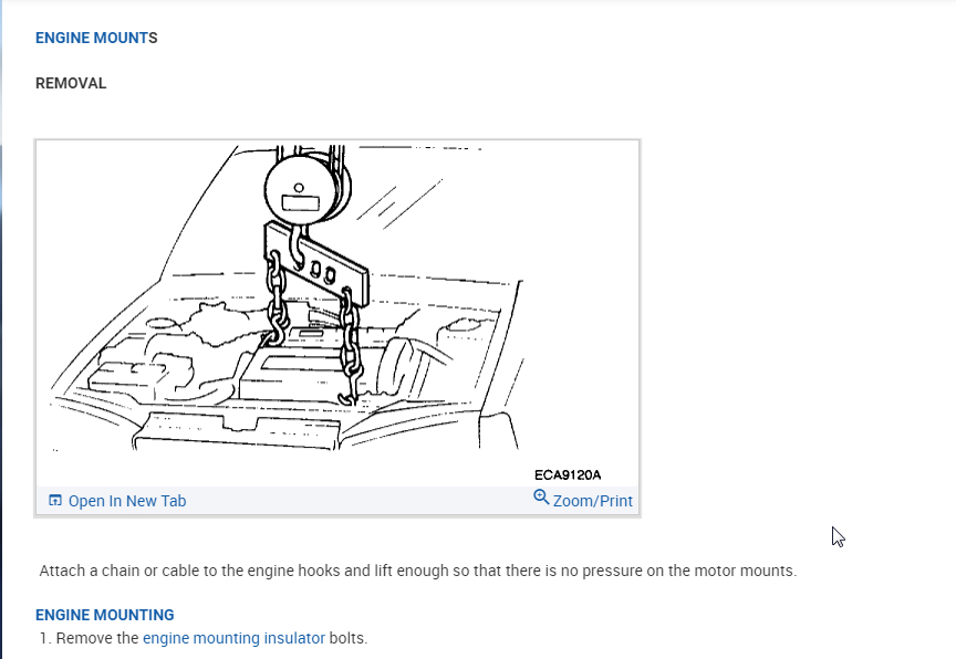

How many total mounts are there?
Vehicle listed above is the GL model.
Is there a diagram with the approximate location of each mount? I think there are 3, F/L, F/R and one underneath. Want to be certain as I need them replaced, but tough to find a full set and I don't want to miss any (all or nothing).
Sep 18, 2020 at 9:42 AM
I am attaching all the info on these mounts. Let us know if you need more info.
Thanks.

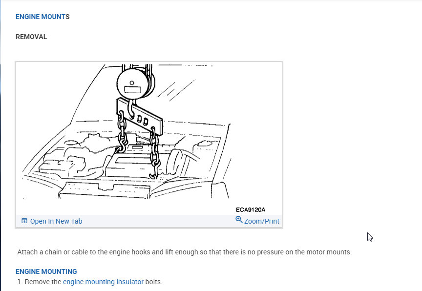

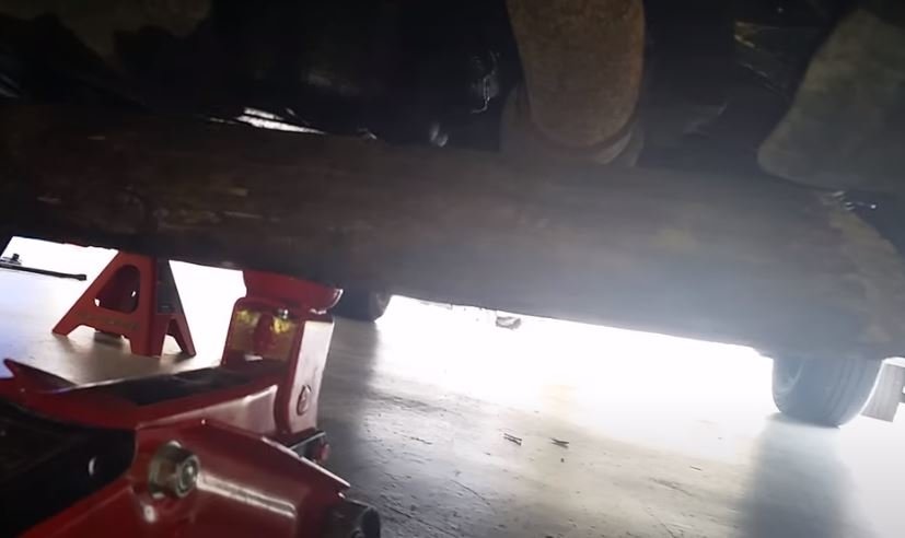

That was quick and awesome. The diagrams also show using a hoist to lift/hold the engine in place. Is it possible to use a jack with a board/2x4 under the engine as show in some videos?
Sep 18, 2020 at 10:08 AM
Yes. That is fine. Just be careful and do one at a time. Clearly we don't want to remove all the mounts at one time. All you are doing is supporting the engine because if you remove the mount the motor will shift and that makes it almost impossible to get the new mount in.
Let us know how you make out. Thanks
