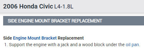

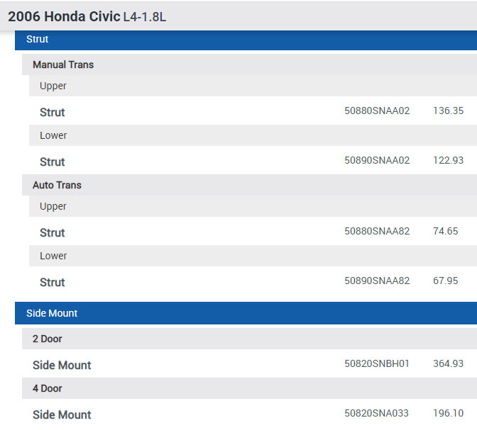

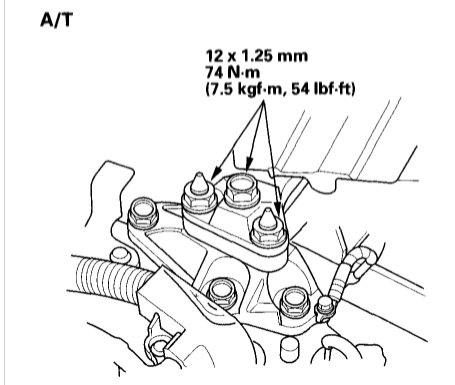

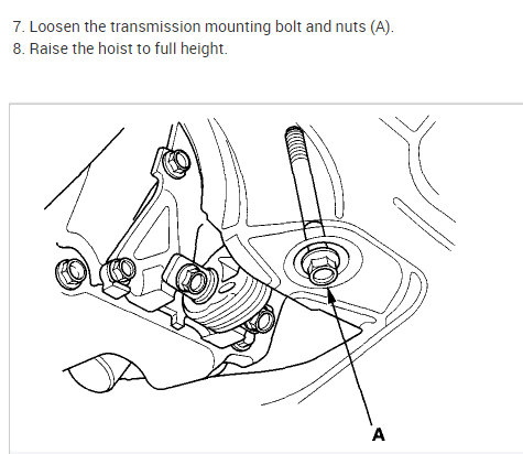

Hello, I'm Danny,

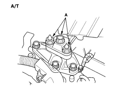

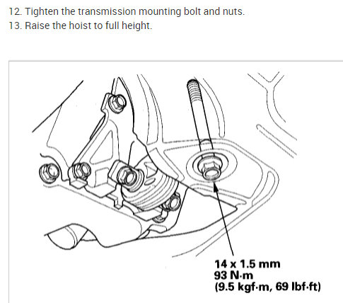

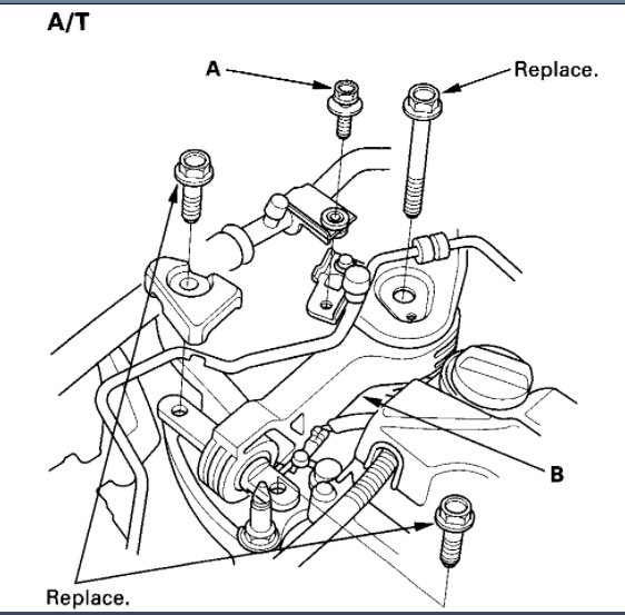

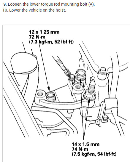

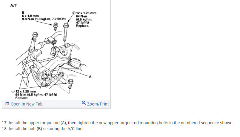

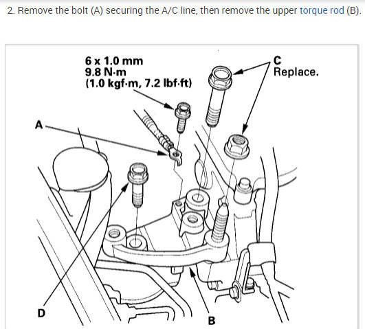

Here is the information you requested. First. Here is a tutorial for you to view showing how to remove and replace a motor mount:
https://www.2carpros.com/articles/replace-motor-mounts
I've attached picture steps below on how to remove and replace the motor mounts on your car and it includes the Honda factory part number for the mounts. Let me know if you have any further questions on this issue. Hope this helps and thanks for using 2CarPros.
