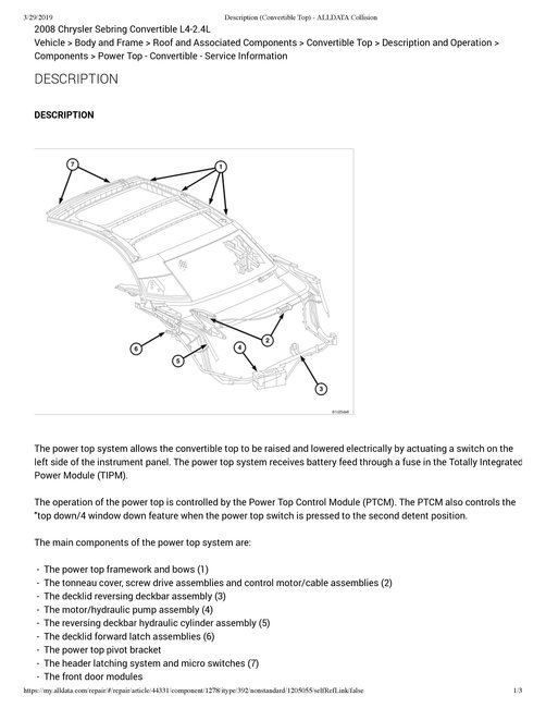

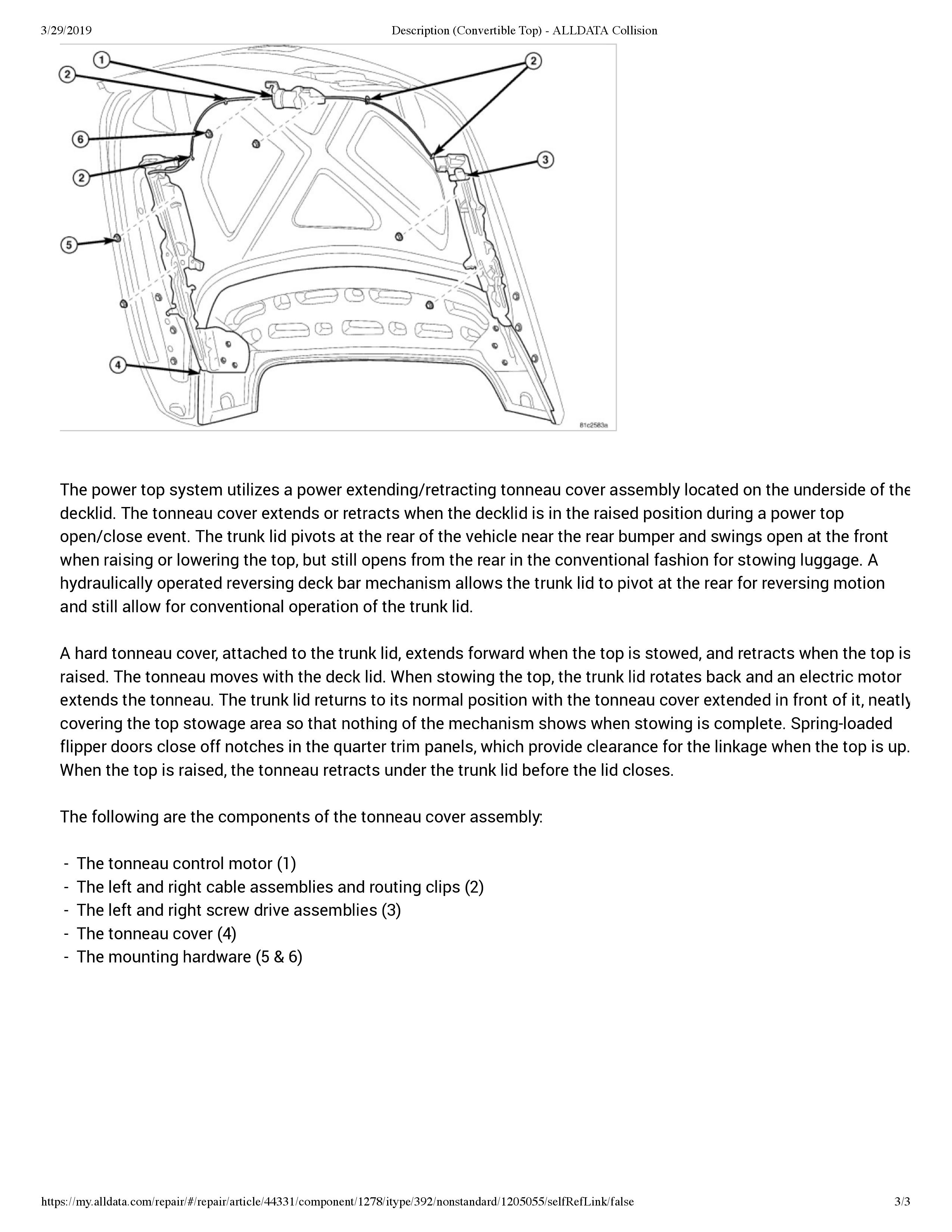

Hey SHOGGARD,
What are the symptoms of the fault you are having?
I have attached below a description of the convertible roof system. Have a read through, there are a few things that can cause the top not to open.
If you can give me a description i can run you through some checks before swapping the motor out if you would like.
Regards, Joe

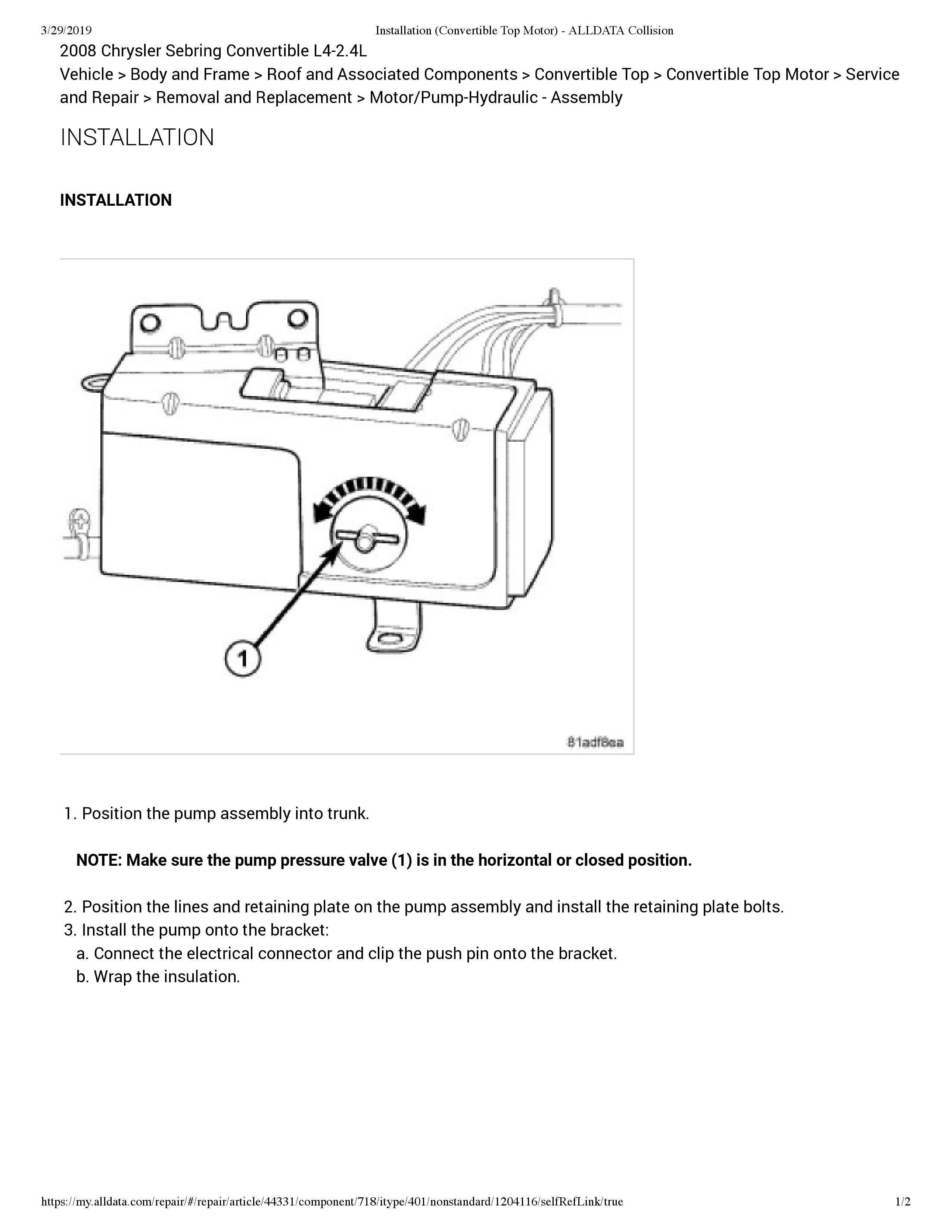

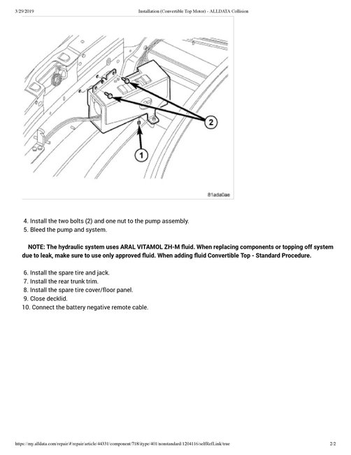

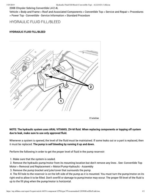

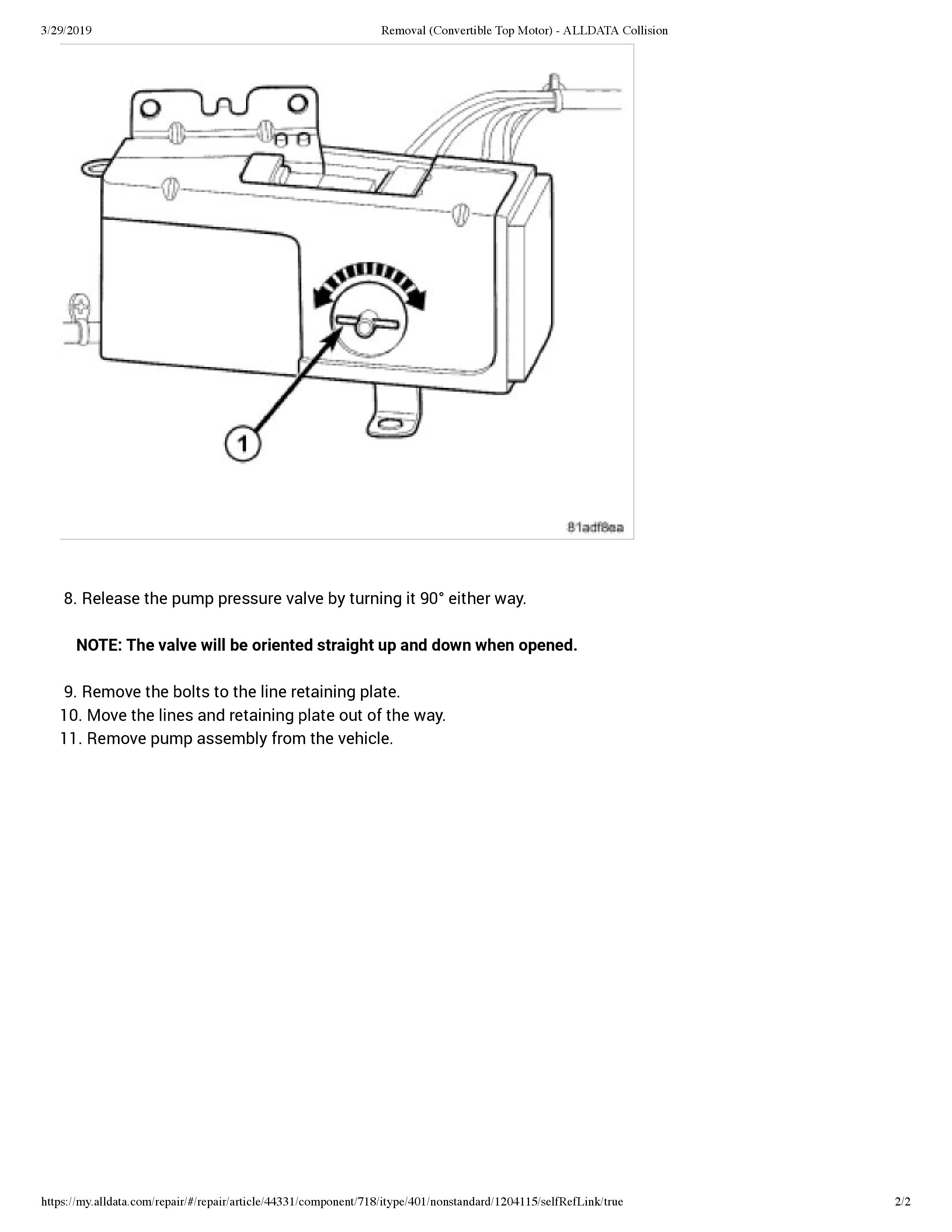

JOETECHPRO
  • 705 POSTS
Hey SHOGGARD,
If you have already diagnosed the motor issue below are the removal/installation instructions.
I have also attached instructions to fill/bleed the hydraulic system.
Hope that helps.
Any further questions please don't hesitate to ask.
Regards, Joe
