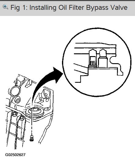

I drove the van 90 miles the previous day with no problems. The next day I started the motor. Oil pressure gauge went right up to maximum and blew the seal on the oil filter. I drained the remaining oil and installed a new oil filter. On start up, same thing happened. Seal on the oil filter blew out and I shut the motor down immediately. Obviously I have a clog in the system which I am going to have to locate. If I had a diagram of the oil circuit, it would help me determine where to start looking. I am hoping it will be external in the cooler or the cooler lines. Obviously the oil pump and pressure gauge are working. I am going to star with seeing if oil will pass through the cooler of the lines. If the cooler and the lines are clear, this is not going to be an easy one to find. Any suggestions on what or where to start looking. I could really use some help and luck on this one.

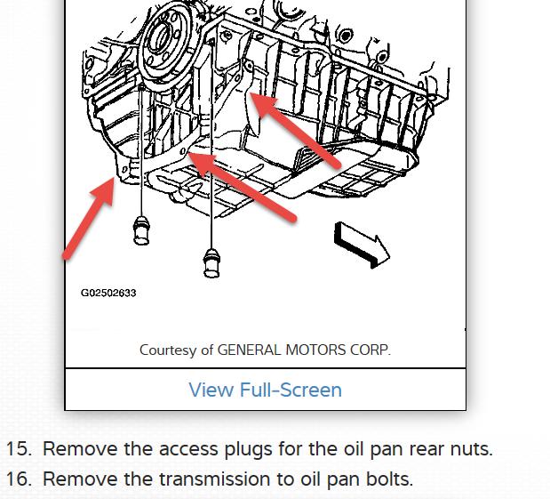

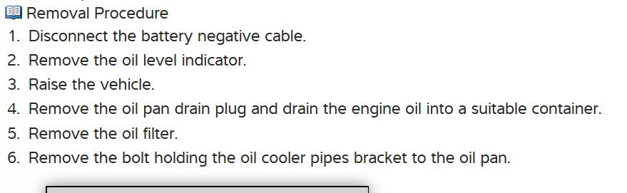

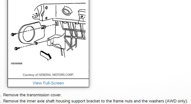

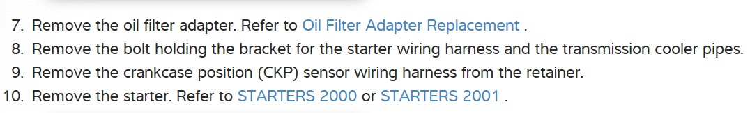

You explanation of the stuck pressure relief valve seems like the most likely suspect. The pressure should have been released even if there was blockage. It did peg the needle and it blew the seal on the filter almost instantly. The pan does not appear to be too difficult to remove. My Chilton's book is a little off from the model type oil pan I have (cast aluminium). The only thing that seems to be in the way are the lines to the oil cooler but that is just a little more time and not too difficult. It will have to sit until Monday and I will start in on it. Crank timing mark set to the 6 o'clock position fro pan clearance during removal. The book says remove the lower bell housing but I don believe I do that on this model. Starter appears it has to come out as well but again just some extra time and not to difficult.

while you are at it you might want to replace the oil filter by pass valve it's right above oil filter. see pics
