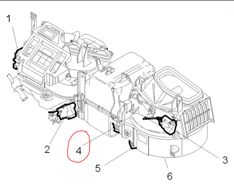

Where is the location of the motor blower?
Dec 15, 2019 at 12:15 PM
DANNY L
Experienced Mechanic
5,648 POSTS
Hello, I'm Danny.

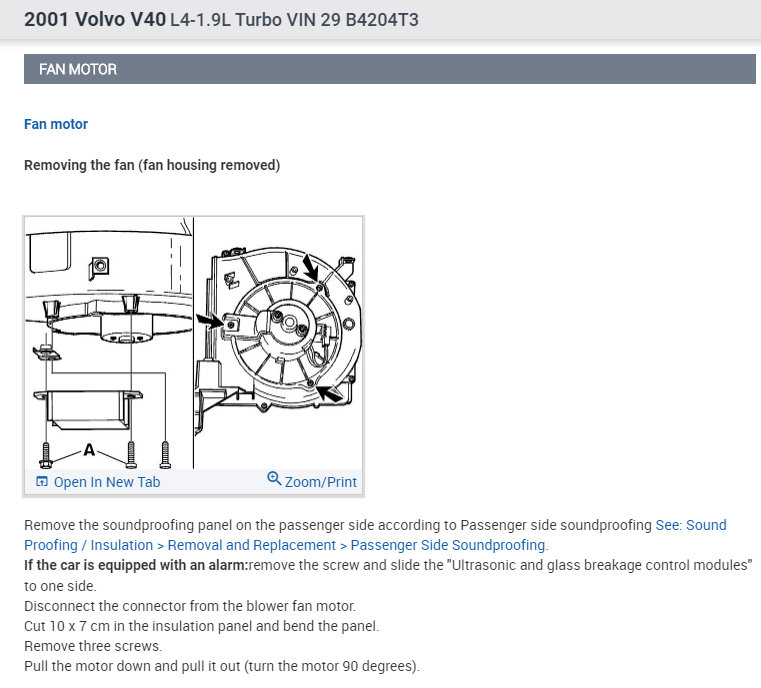

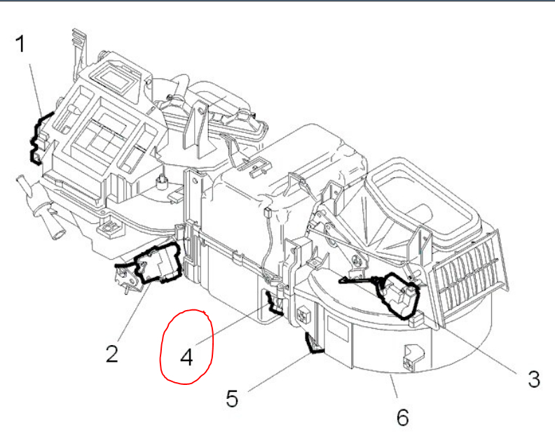

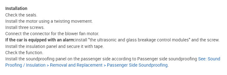

The blower motor is located in the HVAC unit under the dash board. Here is a tutorial showing how to replace a blower motor:
https://www.2carpros.com/articles/blower-fan-motor-works-on-high-speed-only
I've attached a picture of its location and steps on how to replace below for your Volvo.Hope this helps and thanks for using 2CarPros.
