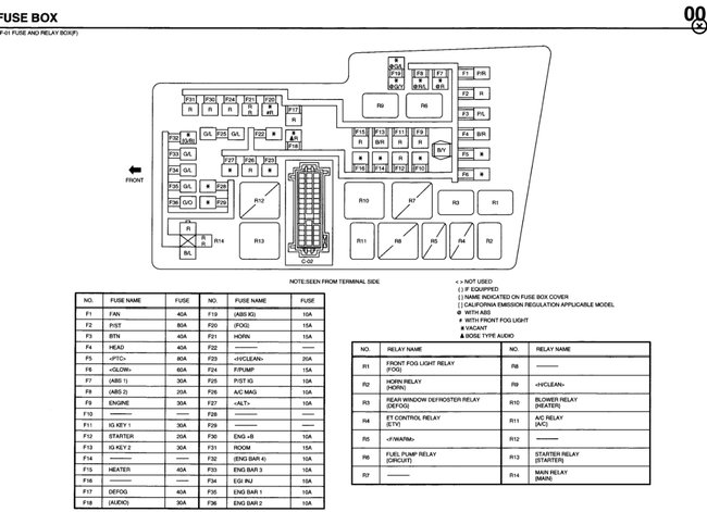

Hello again, my car have problems with the fan. i put 12 volts directly to the fan and it works perfectly, but when it's on the car it won't work properly. it has a control module. How i test that module? And i notice that it try to work, but it slow or try to operate start slowly and stop. The car have fan and coolant sensor or it works with the coolant only?
Where it's or it located? Can you show me? it also have a relay.
Where i start?
Thanks.
Att. Juan marin

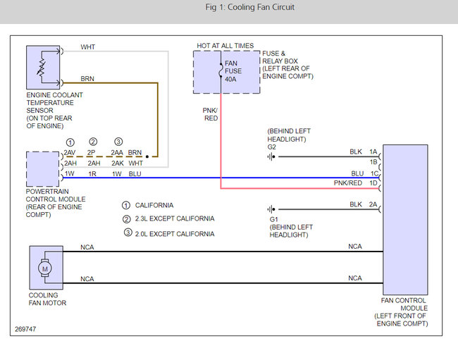

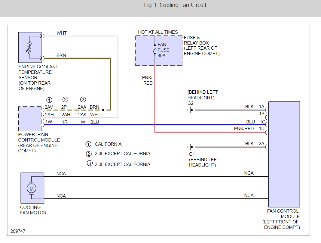

So you do have a cooling fan control module. The control is either from the Coolant temperature sensor on an input from the A/C.
With the engine running A/C on does the fan run?
With the engine running A/C on can you please unplug the fan and test for voltage between the two pins on the fan plug?
Let me know what you have.

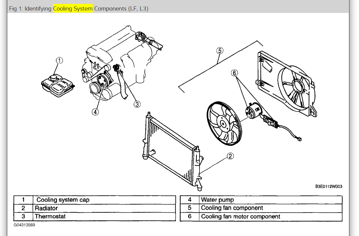

  • 55,433 POSTS

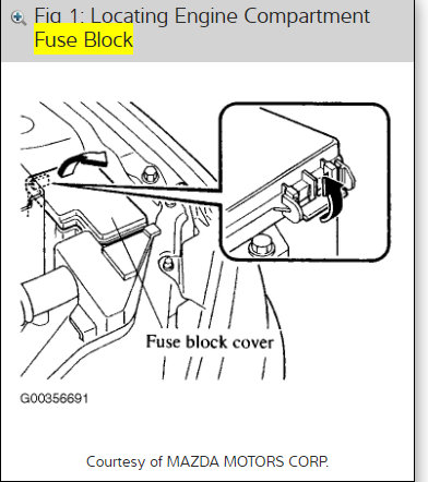

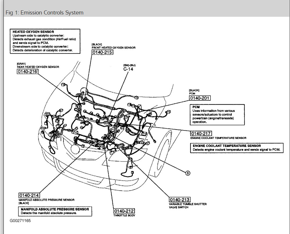

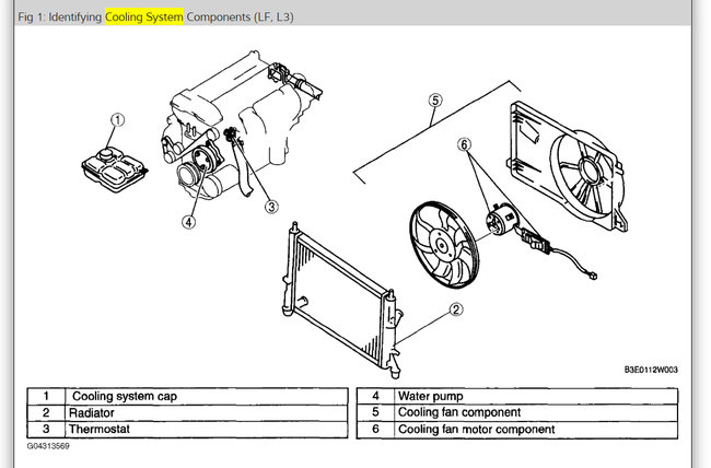

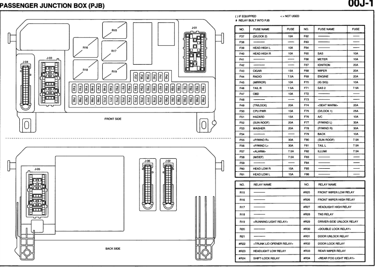

There are fuse and fan controller that run the system here is a guide and the cooling fan wiring diagrams so you can see how the system works with the fuse and module locations as well. The module is next to the fan motor
and
Check out the diagrams (Below). Please let us know what you find. We are interested to see what it is.
