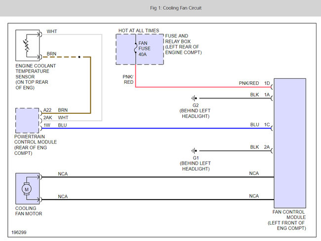

Hi NotTooBad,
You must be losing power somewhere there is a 40 amp fuse that runs the system can you check to see if there is power at it?
Here is a guide
Here is a wiring diagram so you can see what's going on. (below)
There is also a temperature switch that could be bad as well. Also check the grounds for the control module.

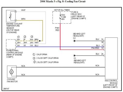

Hi virach, Since the problem is intermittent, it most probably is caused by a faulty sensor, fan control module or bad ground connections. Remove the ground wires behind both the headlights, clean and reinstall and retest if symptom goes away. I have the schematic here for your understanding of the circuit.
https://images.2carpros.com/forum/automotive_pictures/192750_CoolingFan06Mazda3_1.jpg
When problem happens, did the Check Engine Light come on while driving? You mentioned the Mazda SC reset the ECU, were any codes retrieved then?

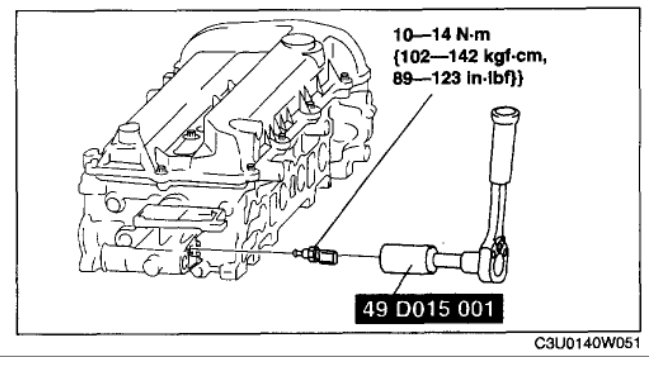

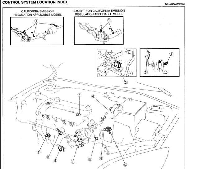

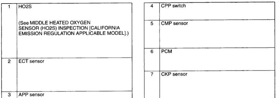

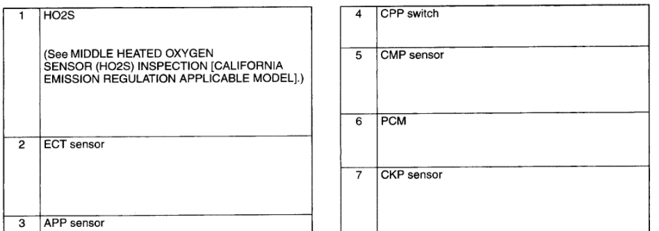

where do i find the sensor reply wit photo if u have one
Nov 3, 2017 at 6:01 PM (Merged)
  • 54,837 POSTS
Sure the sensor is located at the rear of the right side of the cylinder head. Here is a guide to help you see what you are in for when changing the sensor out.
https://www.2carpros.com/articles/coolant-temperature-sensor-cts-replacement
Here are some diagram (below) of where the coolant sensor is.
