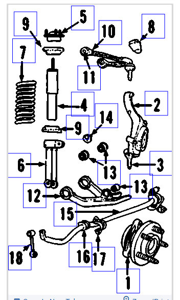

Need to replace strut fork and lower control arm
2006 JEEP LIBERTY
165,000 MILES • 3.7L • V6 • 4WD • AUTOMATIC
SAINT511
Jeep used a clevis strut fork on their suspension to hold the strut to the lower control arm and to go around the axle on both sides. They discontinued this because it's terrible. So my strut fork snapped when my lower control arm snapped and now I can't find anywhere that has or can get a replacement clevis fork. How do I fix this?
Dec 17, 2020 at 4:18 PM
Are you referring to number 6 on the attachment? If so this is the yoke/clevis and the part number is 52088748AC.
If this is what you are referring too, you are correct that they are hard to find but there some Mopar overstock sites that show an inventory.
Here is a link to a site that appears to have one:
https://www.moparpartsoverstock.com/p/__/CLEVIS-Front-Mounting--Right-or-Left-Shock/13731122/52088748AC.html
Let us know how you make out. If this doesn't pan out then you will have to find one at a salvage yard or a totaled vehicle. Thanks
