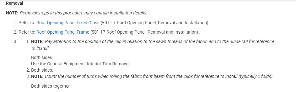

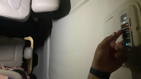

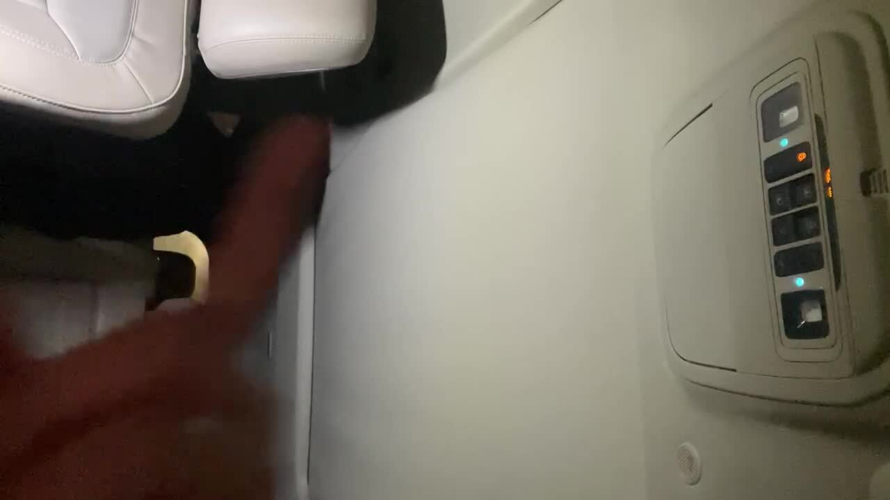

Greetings,
I have the panoramic moonroof that has like carten wining in when open as the shade.
this shade does not retract when open.
Could I get some help with how to get to the roller behind the ceiling lining as I knew that I would break all the clips if I go ahead without some research?
Research got me nowhere but here we are changing from research to inquiry.
Jan 26, 2023 at 10:58 PM
  • 110,244 POSTS

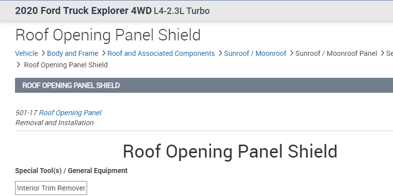

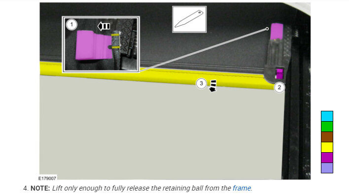

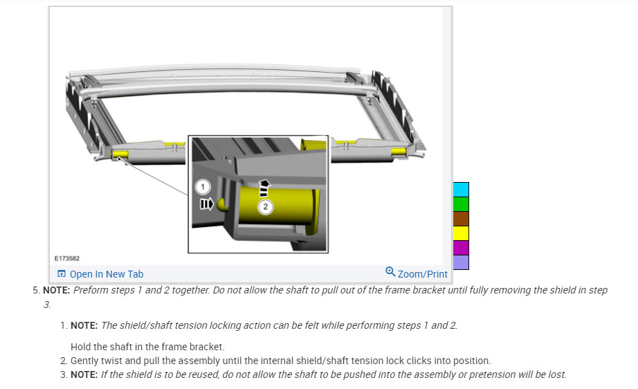

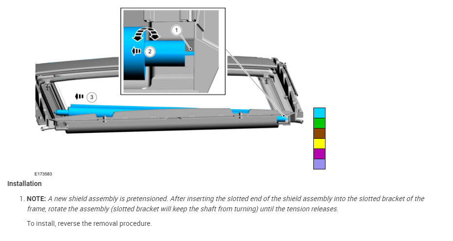

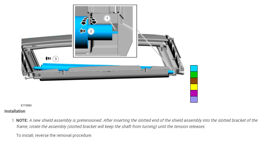

I watched the video, and it appears the pretension has been lost. I have directions for the removal and replacement. Take a look through them.
Also, the vehicle should be under 100% warranty at this point. You may want the dealership to repair it in the event it needs to be replaced.
Let me know. Also, let me know if the directions help.
