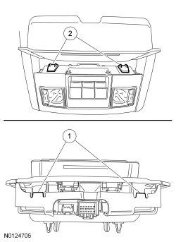

My moon-roof on my SUV listed above (Sport) works sometimes and sometimes it doesn't. The shade part of the moon-roof seems to always work however the tilt and open part does not. Now, somehow it has managed to open all of the way but will not close. I need to figure out someway to get it closed before it rains. Any help would be greatly appreciated. Thank you

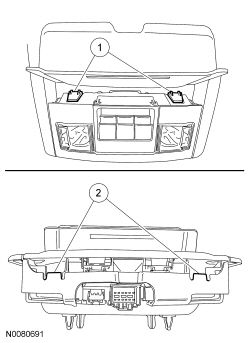

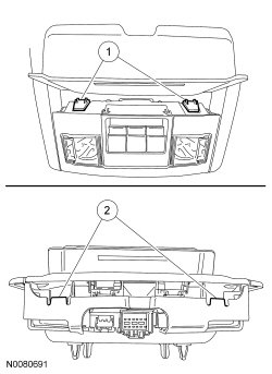

When you try closing it, can you hear the motor running? If not, suspect it is the switch. The switch simply changes the polarity of power to the motor causing it to change directions. If it works one way, the motor is good it just isn't getting power.
___________________________________________
Here are directions for replacing the switch. The attached pics correlate with the directions.
2015 Ford Truck Explorer 4WD V6-3.5L Turbo
Roof Opening Panel Control Switch
Vehicle Sensors and Switches Sensors and Switches - Body and Frame Sunroof/Moon-roof Switch Service and Repair Removal and Replacement Roof Opening Panel Control Switch
ROOF OPENING PANEL CONTROL SWITCH
501-17 Roof Opening Panel 2015 Explorer
REMOVAL AND INSTALLATION
Removal
Remove the overhead console. Refer to Section 501-12, Console - Overhead .
Remove the light assembly from the overhead console.
Release the 2 rear tabs and rotate the light assembly slightly away from the overhead console.
Release the 2 front tabs and remove the light assembly from the overhead console.
see pic 1
Disengage the 4 tabs and remove the switch from the light assembly.
see pic 2
Disengage the 2 tabs and remove the switch bezel from the switch.
see pic 3

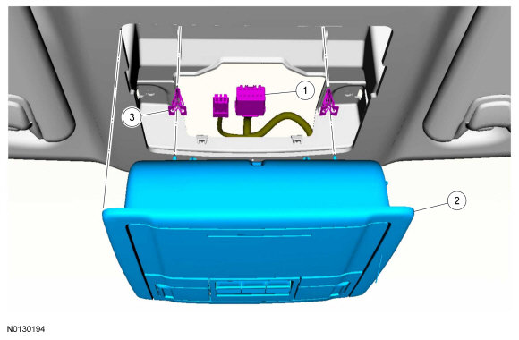

Here are the directions for removal of the overhead console:
Console - Overhead
Console - Overhead
CONSOLE - OVERHEAD
501-12 Instrument Panel and Console 2015 Explorer
Console — Overhead
pic 7
Item Part Number Description
1 14334 Overhead console electrical connector
2 78519A70 Overhead console
3 — Overhead console clips (2 required)
Removal
Pull the rear of the overhead console downward to release the retaining clips.
Disconnect the electrical connectors.
Installation
To install, reverse the removal procedure.
