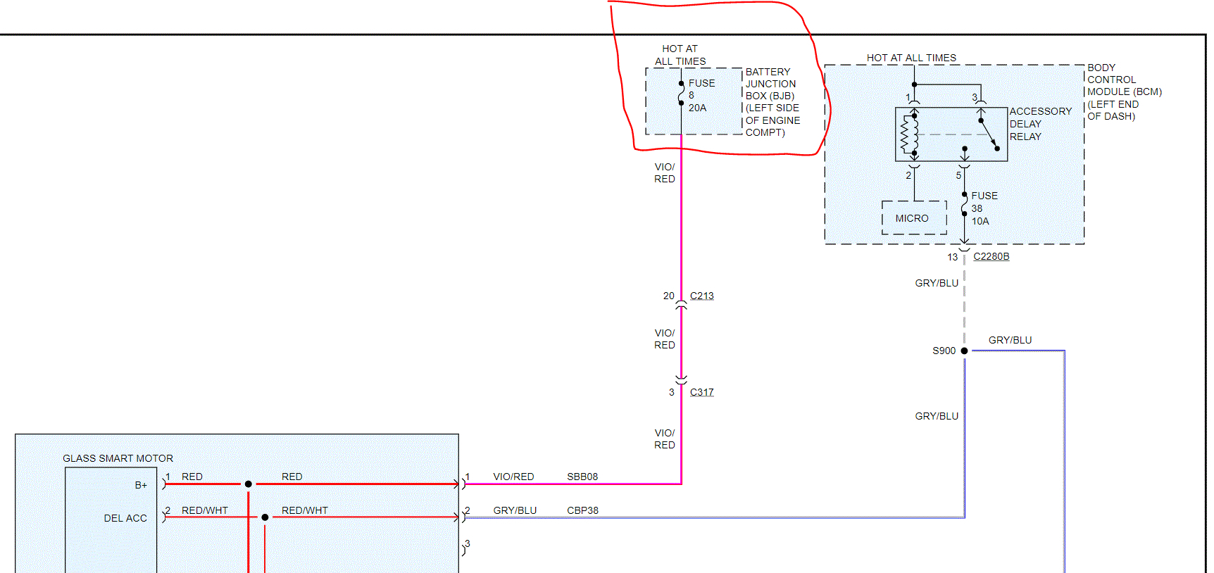

Does not open or tilt.
Oct 27, 2020 at 6:38 AM

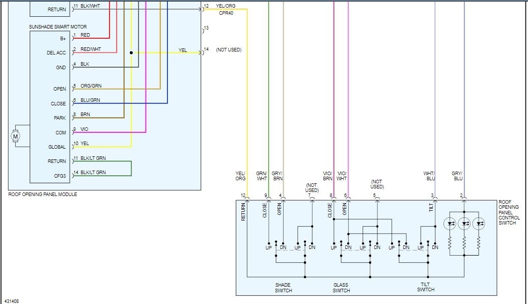

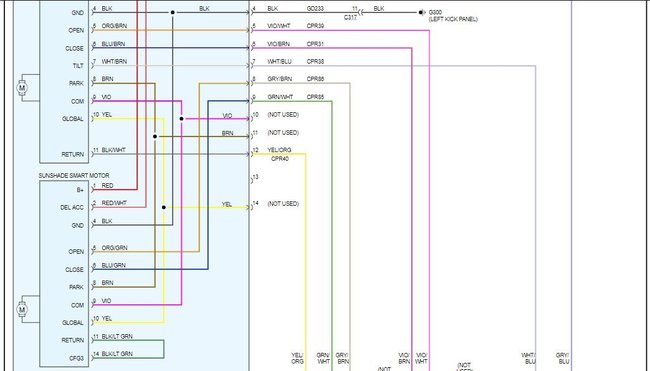

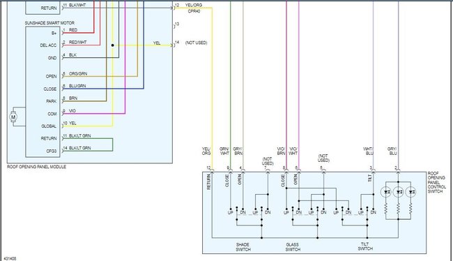

Good afternoon,
I attached the wiring diagram for you to view.
We need to do some testing starting with the fuses to be sure there is power on both sides of the fuses.

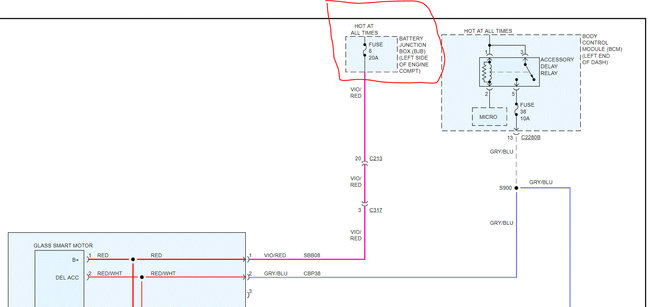

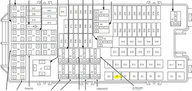

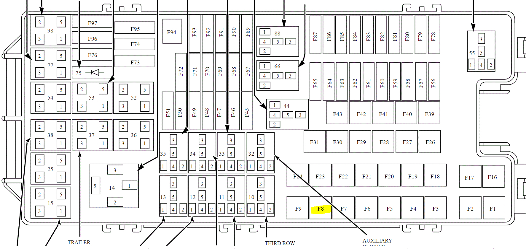

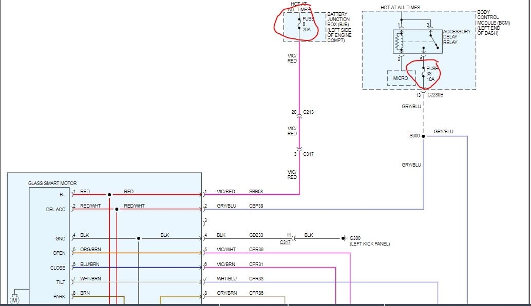

The first thing to check is the fuse that supplies power to the motor. I attached two pics below. The first shows the fuse in a schematic. Pic 2 is of the under hood fuse box. I highlighted the fuse to check.
In addition to checking the fuse's condition, make sure there is power to and from it. Here is a link you may find helpful:
