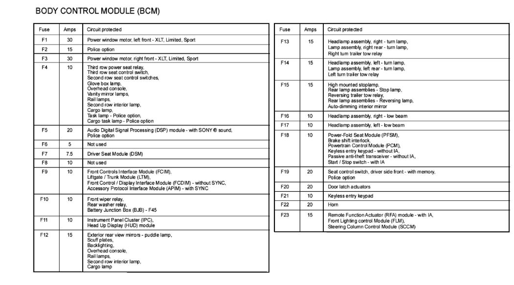

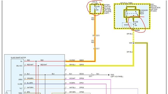

Moonroof won’t tilt or open. Sunshade works fine.
Tuesday, June 2nd, 2020 AT 9:08 PM
MECHANIC
52,797 POSTS
Good morning,

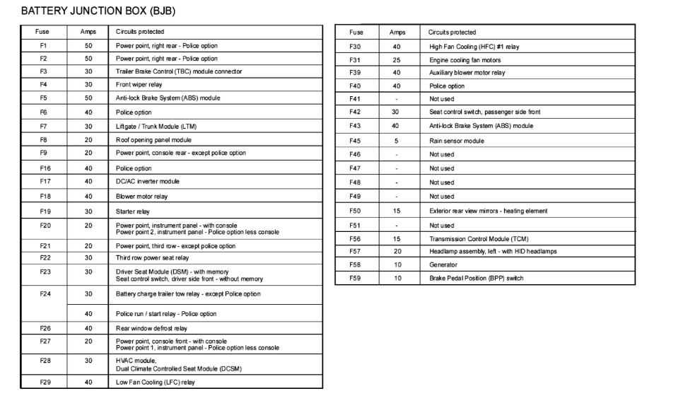

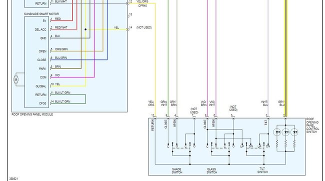

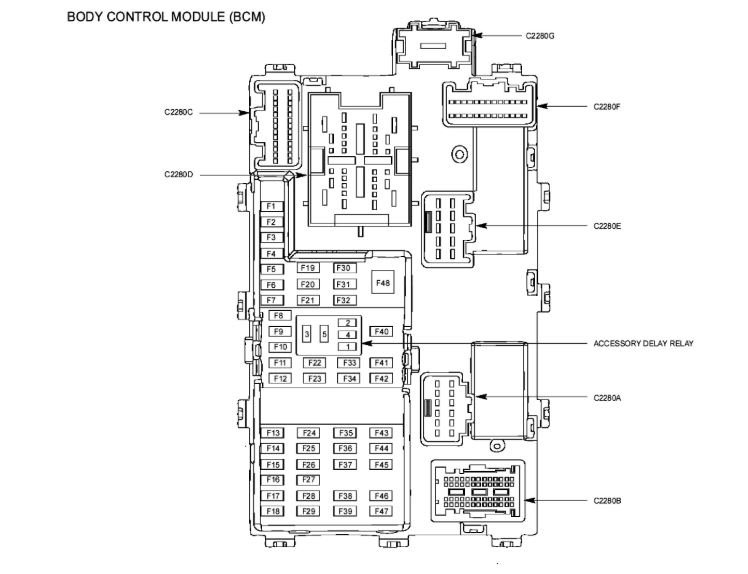

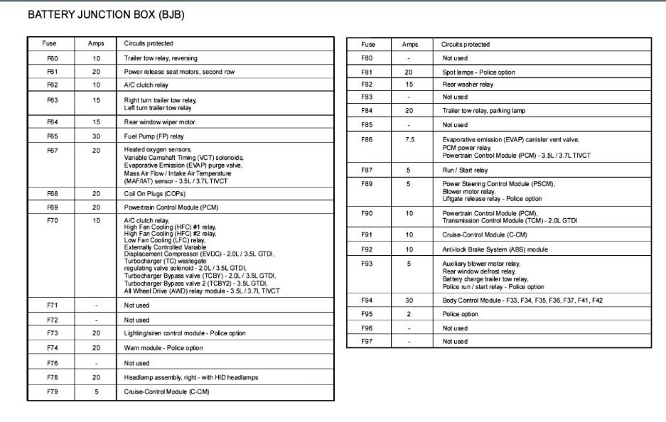

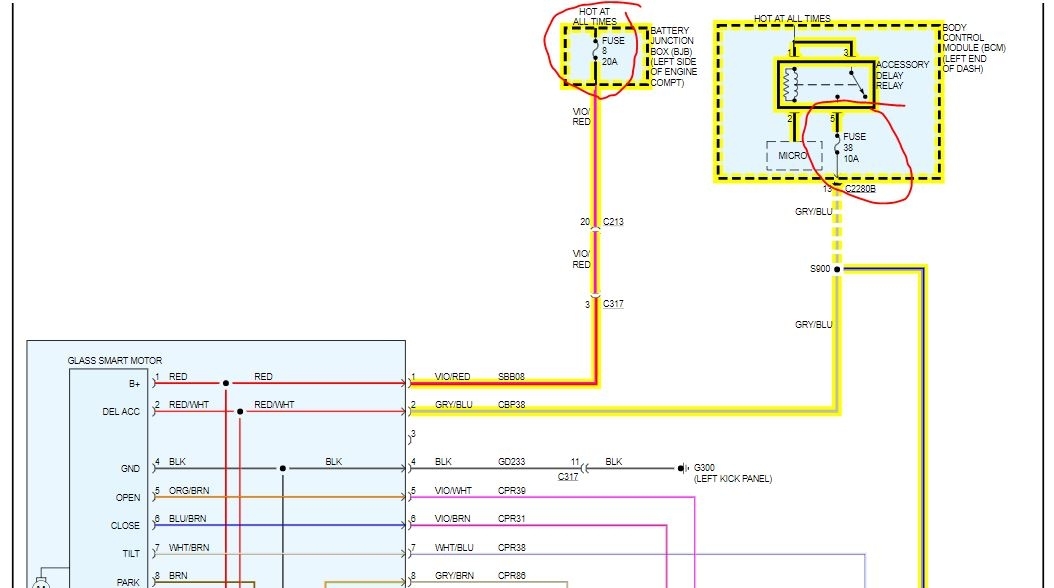

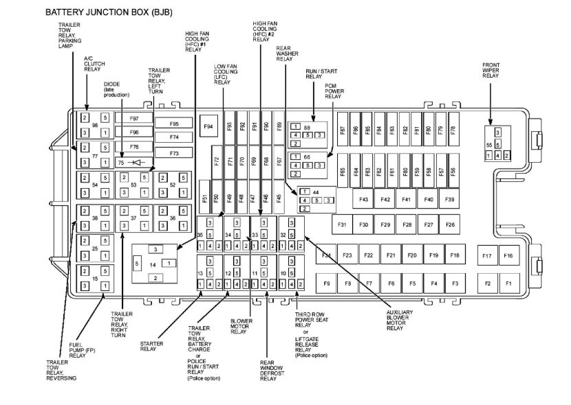

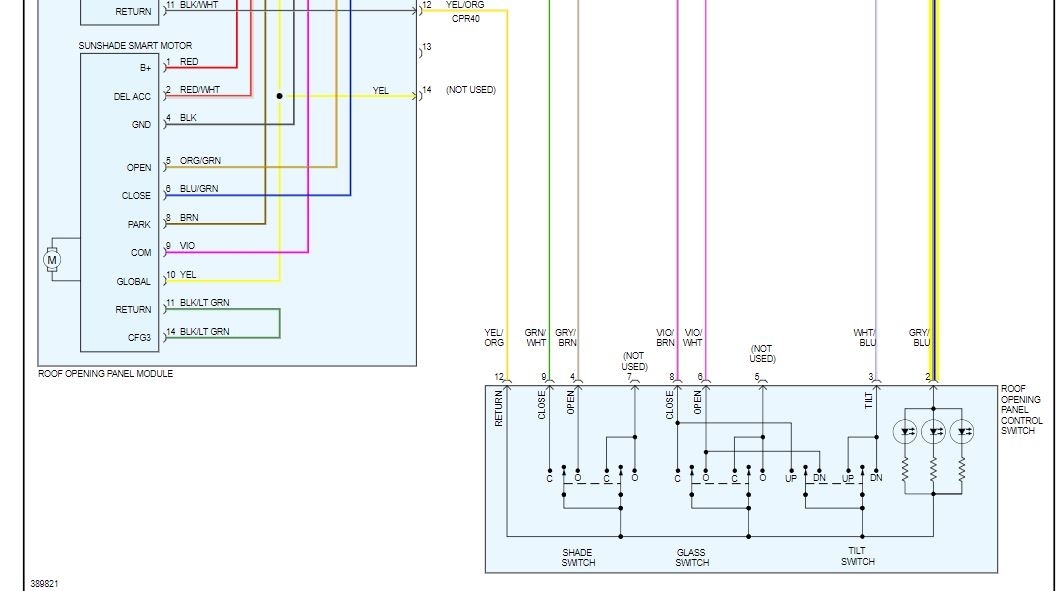

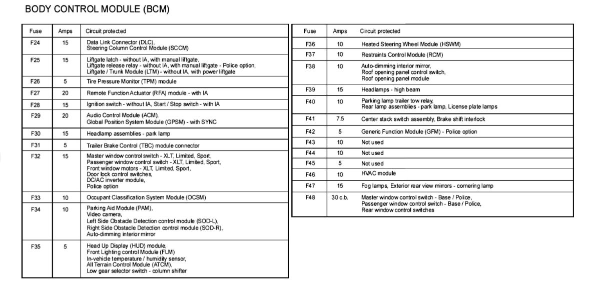

I attached a wiring diagram for you of the system. There are 2 fuses for the system. Check these fuses for power on both sides with the key in the on position.
This is a power test, not a visual test. You will need a test light or voltmeter to do this procedure.
Let me know the results.
