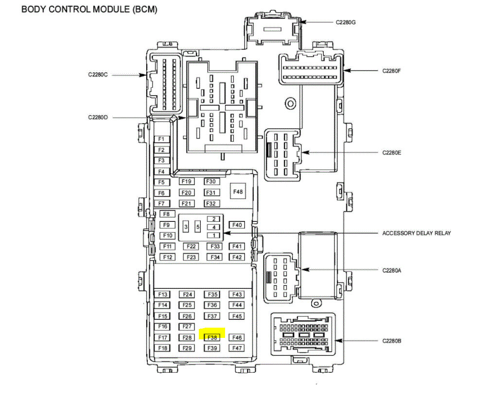

There is a fuse on the body control module to check also. It's fuse 38 under the dash on the driver's side.
If that fuse is good as well as the one you already checked, confirm there is power to both. Here is a link you may find helpful:

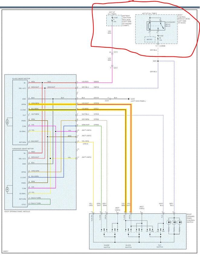

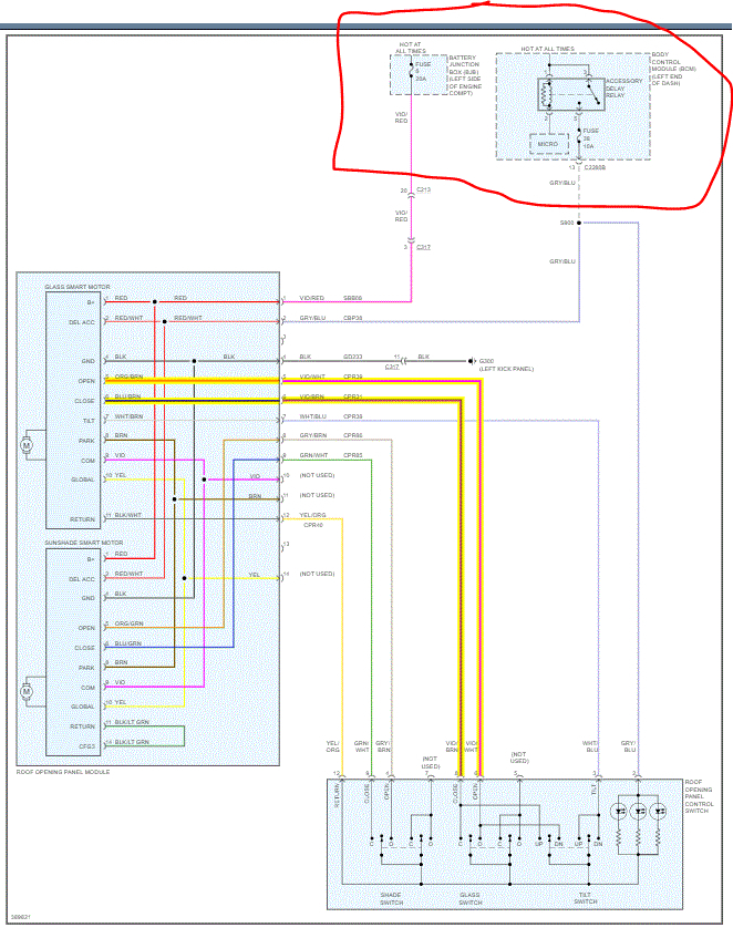

Next, I attached a wiring schematic below if the system. If the fuses are good, then you will need to check for power at the switch and the window motor. I highlighted the wires that need checked. Power will be sent to them one at a time based on if you select open or close. See pic 1.
Pic 2 shows the location of the fuse I'm suggesting be checked.
Let me know what you find. Also, let me know how much water came into the vehicle. Something may have shorted at the motor.

I removed the moon roof motor (drivers side) and pull the electronics off. The assy. was wet and i put power to the motor direct and it ran. I'm going to dry (contact cleaner spray) and reassemble and plug in and see if it dried the electronics up. I also ordered a motor assembly.
Is there a part number just for the electronics module part of the motor assy? The motor works , just need the electronics.
Fuse, 38(10A) (under the drivers side fuse box, ) operate the moonroof, auto dim rearview mirror.
The shade switch part works and in the early attempts to close the moon roof the tilt switch clicked when I pushed open and then later if stopped. I'm just going to change out the fuse.
I'll try to put together the motor with the dried electronics and plug in and try again . I know the motor works with direct 12 volt, I'm wondering if there is a electronics part to buy , rather than the whole motor assembly.
