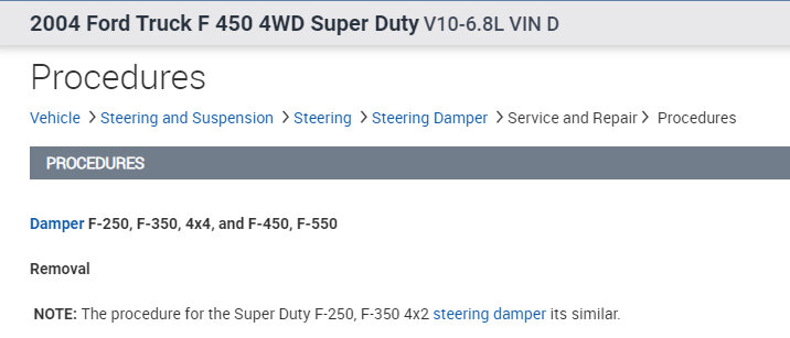

Is it a mono or twin beam? Replacing steering damper.
Oct 27, 2022 at 9:11 AM
  • 110,251 POSTS
I'm not sure what you are asking. If you are referring to a Twin I Beam suspension, I believe they used that on the 2wd vehicles.

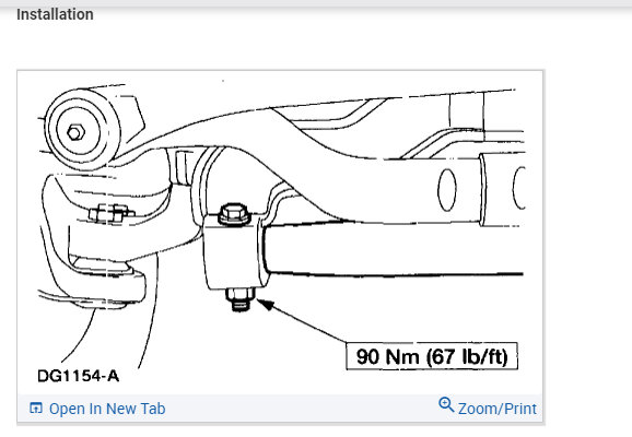

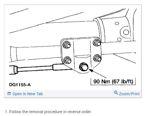

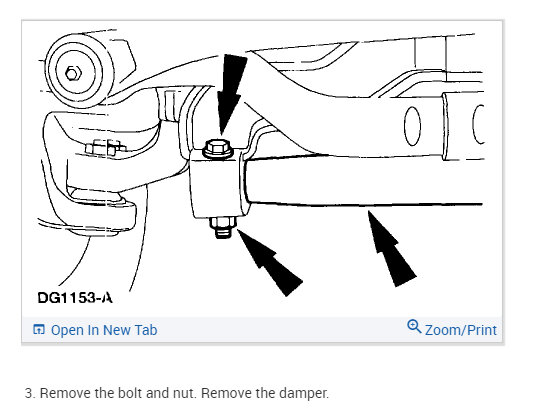

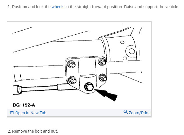

As far as the damper is concerned, I attached directions for replacing it.
Let me know if this helps.
