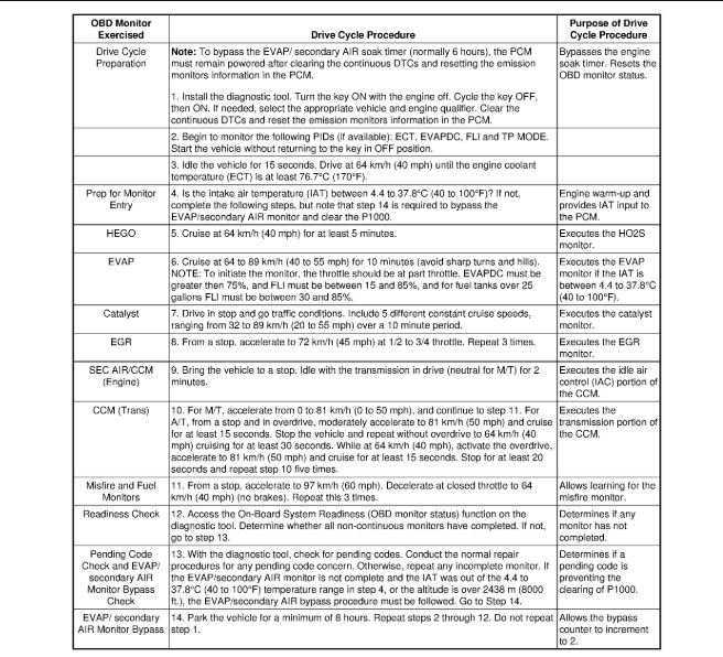

Changed battery and now the catalytic converter, o2,and 02 heater monitor will not reset.

Drive cycle is a very specific way the truck has to be driven in order for the monitors to run and pass. I attached the drive cycle below for you to follow.
