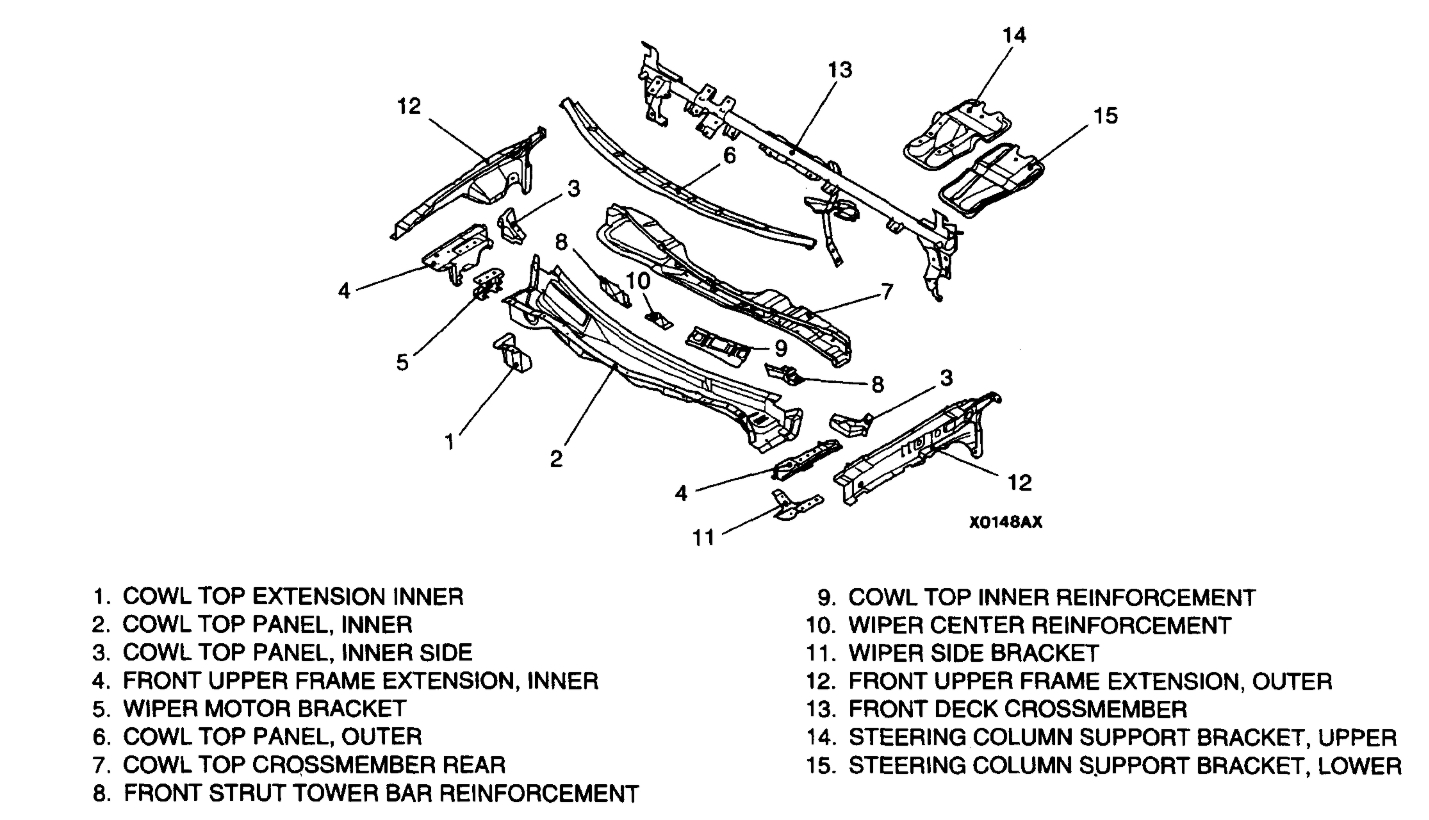

I watched about three videos about cleaning out the windshield cowl drains and the underlying drain around the door jamb and wheel well splash guard. These were for multiple cars other than my own. So I was wondering if you know where I need to get into in order to clean out the lower drain area that exits from the windshield cowl drains? One video showed opening up the back part of the splash guard in the wheel well. Another video showed opening the door all the way open and reaching inside the door jamb. Do you know how to get access to this drain area on my 2001 Mitsubishi eclipse GS?

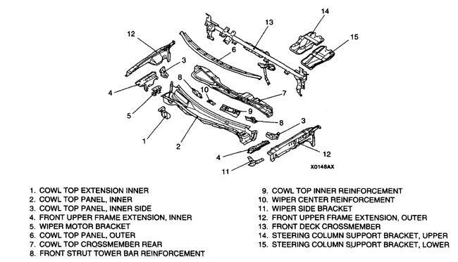

Yep, chances are the the windshield sea is leaking but it is worth cleaning the cowl drainage out. So the cowl spills over each side of the cowl ducting, here is a diagrams for you so you can see how it works.
