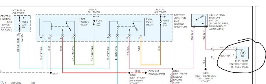

Where is it?
Oct 2, 2019 at 9:36 PM
Good morning.
There are many modules in the car. I need the specific module you are looking for.
Oct 2, 2019 at 9:48 PM
JOBOBBITT
Fuel pump.
Oct 2, 2019 at 9:52 PM
It is the fuel pump. It is referred to as a fuel pump module.
It is inside the fuel tank. The sender and pump are in the module.
Fuel Pump Module
The fuel pump (FP) module is a device that contains the fuel pump, fuel pressure regulator, and fuel sender assembly which is located inside the fuel tank in a reservoir.
