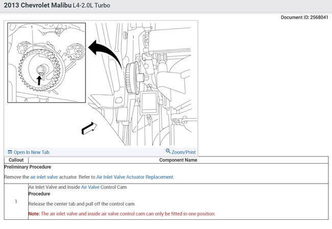

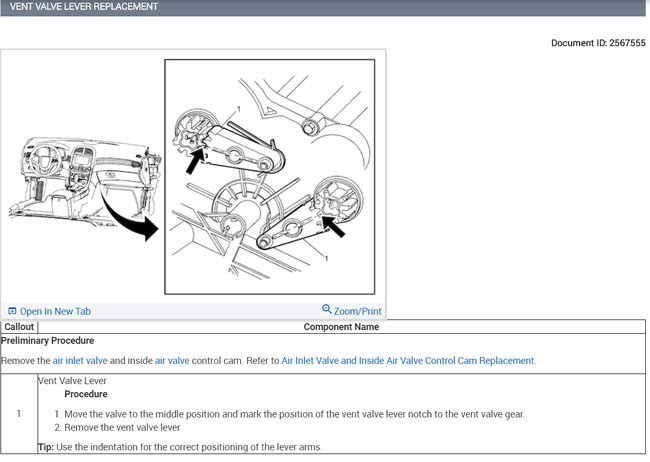

The Heat and cool air work on all speeds. The air blows best out the front vents and not so well on the feet. I switch the mode to defrost and you hear it shifting over, but never gets there and then blows hard out the front vents. I don't hear clicking like many people hear when the mode actuator is bad. Please help. I need the defrost before winter. Thanks!
Sep 3, 2019 at 10:17 AM
  • 55,748 POSTS

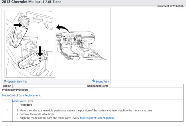

There is a gear and lever set up that when something get put down the vents like a ink pen or stick it will break these parts. Here are diagrams to help you see what I am talking about and how to fix the problem. Check out the diagrams (below). Please let us know what you find. We are interested to see what it is.

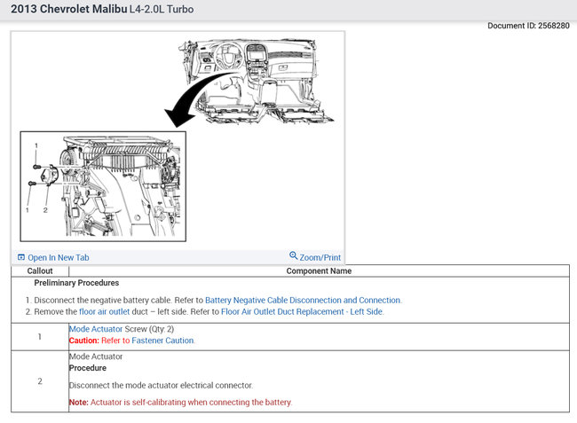

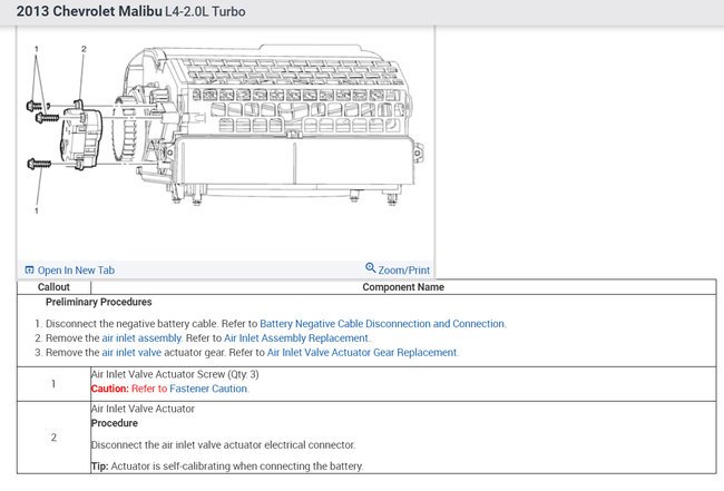

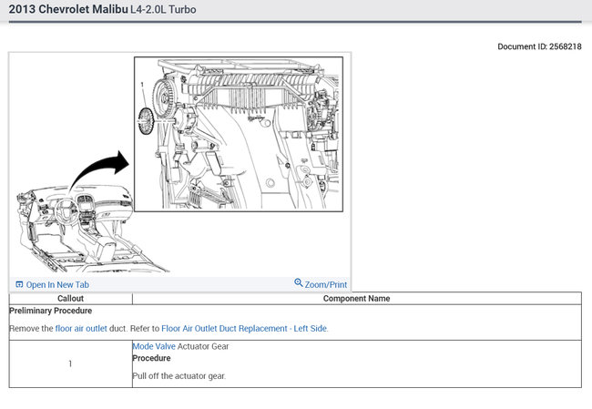

Yes, it looks like it is on the drivers side. The actuator moves the gears and levers you need to make sure they all work when you move the climate control.
If something is caught in there, changing the damaged gear will only let it break again.

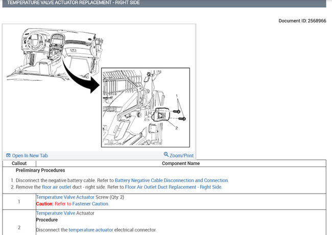

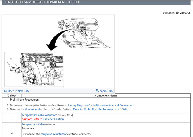

Can you please shoot a quick video with your phone so we can see what's going on? that would be great. You can upload it here with your response. Here are the other blend door actuators and gears so you can see how the system works. Check out the diagrams (below). Please let us know what you find.

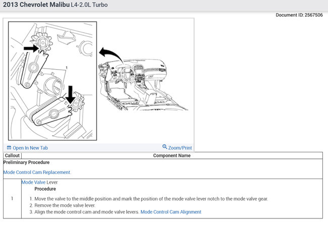

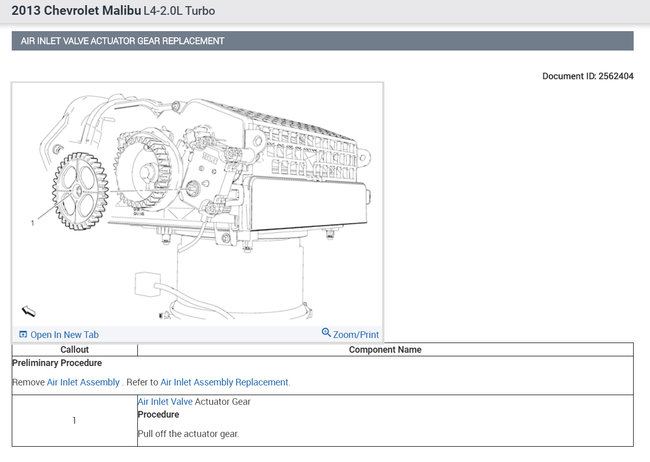

Please check out the first response it shows where the defroster blend door actuator is and the gears that go with it. Can you please shoot a quick video with your phone so we can see what's going on? that would be great. You can upload it here with your response.
Feb 15, 2021 at 3:28 AM
STEVE W.
  • 15,418 POSTS
As Ken said the gears and the cam on the defrost doors are a common issue. They are made of plastic and only take a bit of flexing to damage. Next is the shaft that moves the door itself. Sometimes you can snake an inspection camera in there and see if it's the shaft or the door itself.
