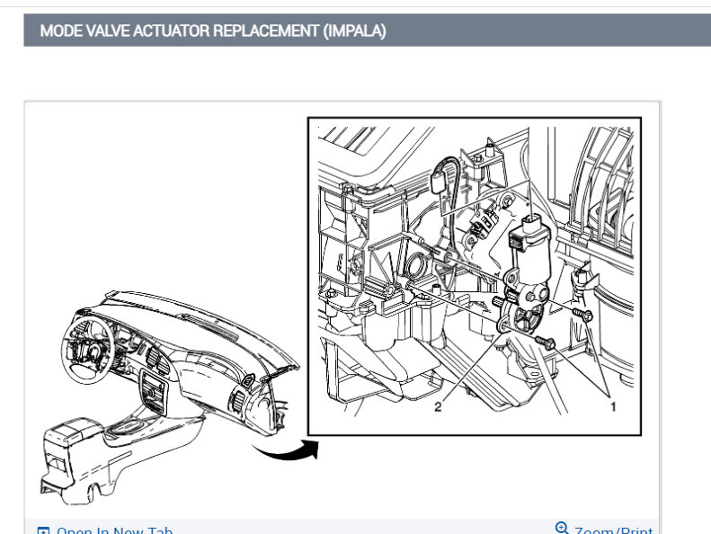

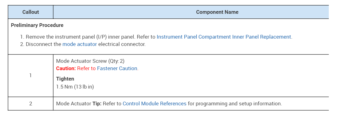

The actuators you mentioned are two different ones. The mode door actuator is for airflow direction and the temp (heat) is a blend air door. I suspect you are referring to the mode door (air flow direction), so I attached the directions below.
If, however, you need the blend air door actuator (air temperature actuator), let me know if it is for the left or right side.

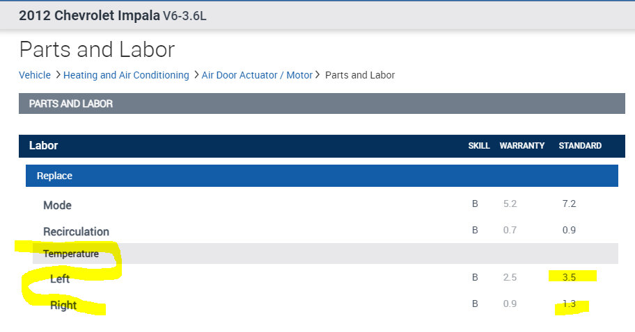

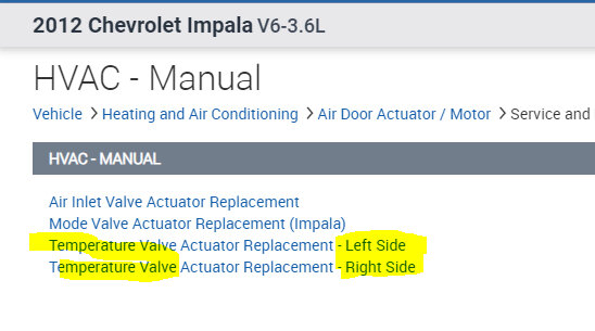

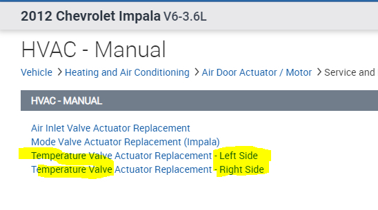

If it is the temperature that is the problem, that is easier than the mode door actuator. Just to give you an idea, take a look through this link:

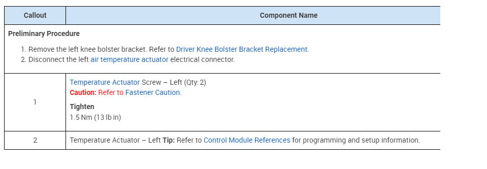

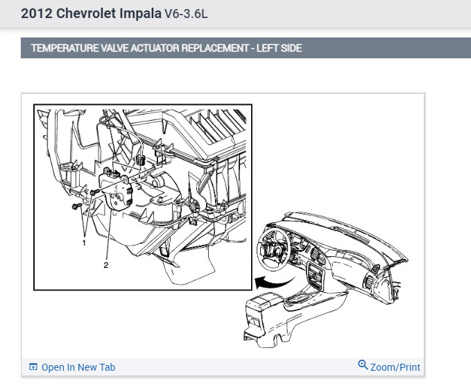

Let me know which side isn't properly working. See pic below.
See pics below. Note: The right side calls for 1.3 hours of labor and the left side calls for 3.5. See pic 2

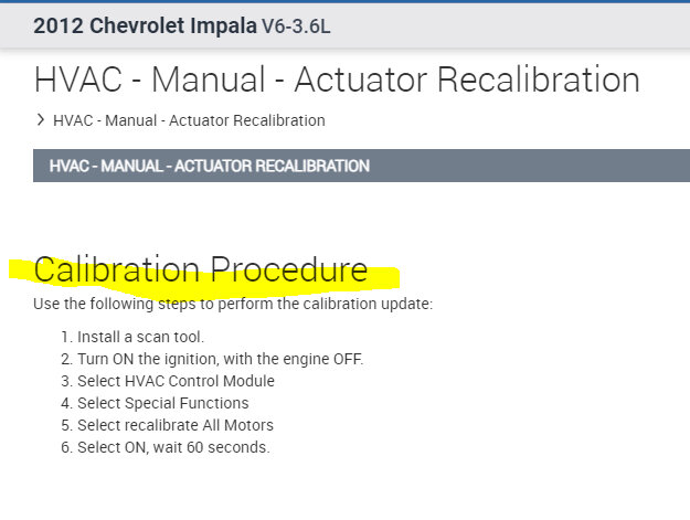

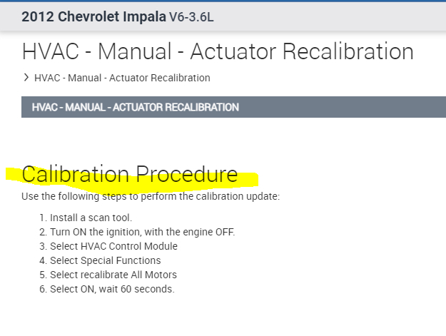

  • 110,244 POSTS
David, I attached the directions below. The only thing I see you may have an issue with is calibration after it is replaced. It requires a scan tool that can communicate with the module. Take a look at the directions. I attached the recalibration procedures in the last pic. Let me know your thoughts and questions.
