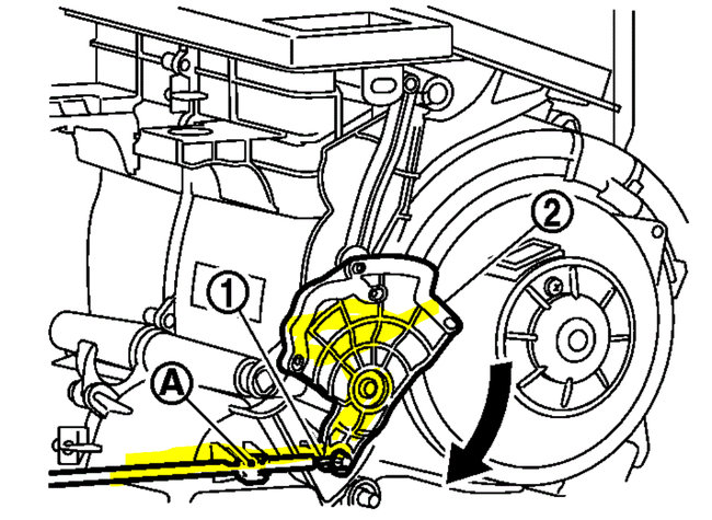

When I turn on my A/C my car makes a rapid clicking noise in my dash. I have been told it is one of my actuators. I was wondering where the placement for each of the doors are and if I have to pull the dash or can they all be done without? I would love to do the repair myself and not have to pay somebody hundreds of dollars when I know it’s possible to do myself.

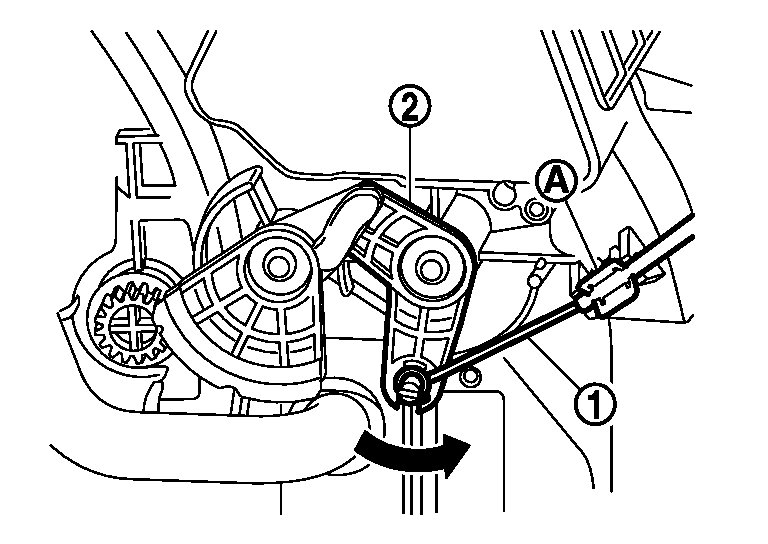

Everything I am showing indicates an electric actuator motor is not used. What I find is cable replacement. That would not cause a clicking. See pics below. Pic 1 is the mode door cable and pic 2 is the blend air door cable.
Does the noise happen under any other conditions?

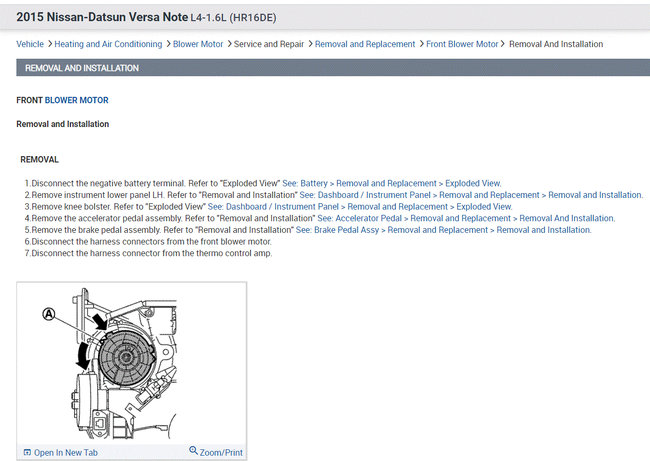

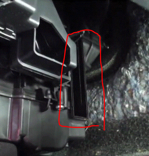

If it speeds up with the fan speed, it isn't an actuator. It seems something is touching the fan blade. An actuator wouldn't respond like this.
The fan could be loose, the blade could be loose, something could have gotten into the blower motor box, or even a mouse could have gotten into it.
Also, there is a cabin air filter in this vehicle. It should be behind the glove box. Remove the filter and see if there is excessive dirt or anything in it.
The cabin air filter is located under the glove box. I found a picture and circled where it will be located. There is a plastic cover that clips on. Remove the cover to access the filter. (see pic 1)

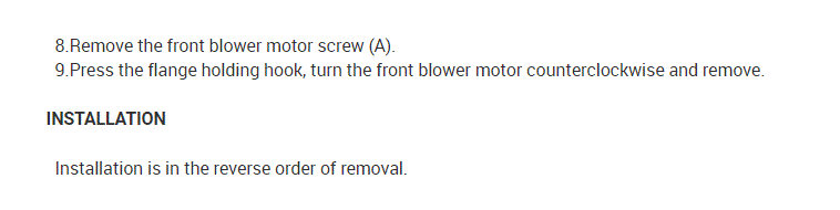

If the filter is clean and doesn't indicate any excessive debris, I need you to remove the blower motor to check if something is lose or in the box. If you look at pics 2 and 3 below, they are the directions for the removal of the blower motor.
