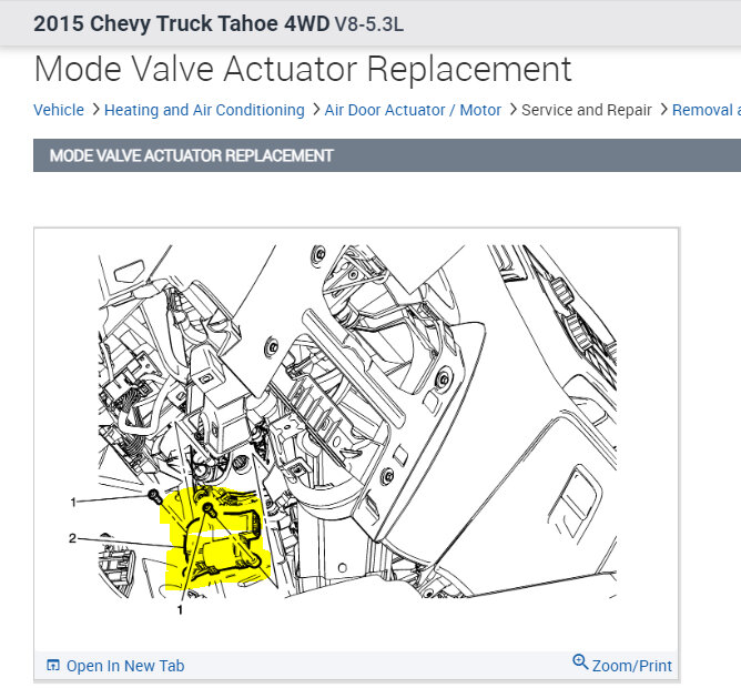

Hello, I just replaced my blend door actuator. As well as replace my condenser. However, I am still not getting air out of my front vents. I get air out of the foot and defrost vents though. So I am assuming I need to replace my mode door actuator. Does anyone know where it is located and can provide an image? As well as a part number.

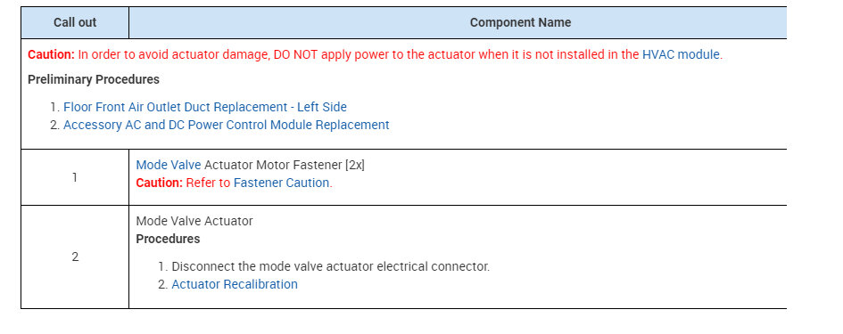

To access the mode door actuator, you need to remove the floor duct on the driver's side of the vehicle.

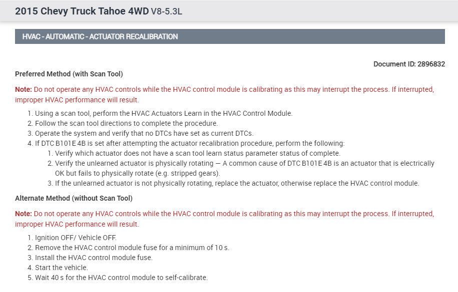

If you look below, I attached the directions for replacing it. (see pics 1 and 2). Once the new one is installed, it will need to be calibrated. Pic 3 below provides the directions for recalibration.

I did that and still didn’t get anything using the alternate calibration. Can the doors become dislodged or something else block the vents or ducts?
