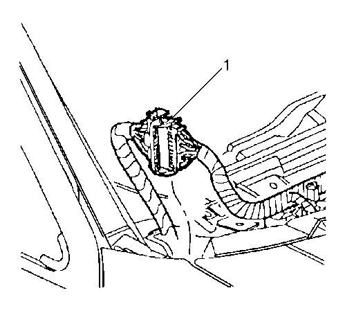

What has to be removed in order to really get to the mode door actuator to get it out and replace it? Does the whole IP have to come out? Is there a recommended shortcut?

Step one in the directions for mode door actuator replacement is to remove the IP carrier. Basically, that means remove the dash. As far as a short cut, I don't know of any. I wish I did.
___________________________________
Here are the directions for the IP carrier. The directions are listed as removal and replacement of the instrument panel. The attached pictures correlate with the directions. I will also include the directions for replacing the actuator. That will be second.

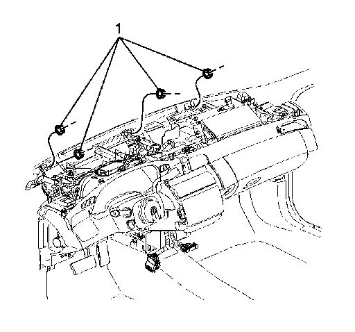

pic 1
11. Disconnect the body to IP electrical connectors (1) at the top, outside corners of IP.
12. Disconnect all other electrical connectors from the IP to body.

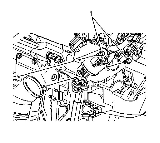

13. Disconnect the steering column shaft from the steering column.
pic 2
14. Remove the steering column to body bolts (1). Refer to Steering Column Replacement (Floor Shift) Steering Column Replacement (Column Shift) in Steering Wheel and Column.
15. For a DeVille base model, or the DeVille DHS, disconnect the shift cable from the steering column.
16. Disconnect the Steering column to body connectors.

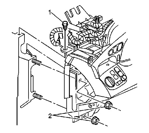

pic 3
17. Remove the IP center support bracket bolts (1) to floor bracket.

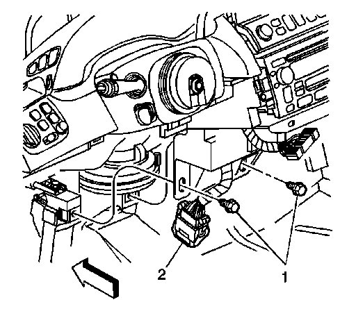

pic 4
18. Remove IP carrier (1) to cowl nuts.

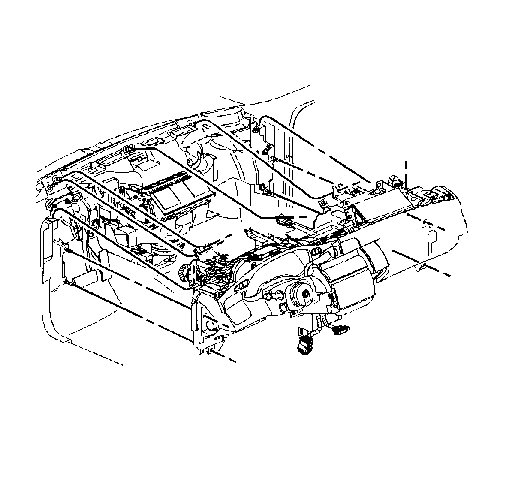

pic 5
19. Remove the bolt (1) and nuts (2) from the left and right IP carrier to hinge pillar.

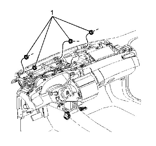

pic 6
20. Remove the IP and carrier assembly from the vehicle.

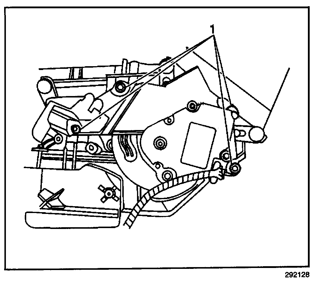

pic 12
1. Remove the IP carrier.
IMPORTANT: The left air temperature actuator does not need to be removed in order to remove the mode actuator motor.
The left air temperature actuator is removed in the graphic in order to show the screw locations.
2. Remove the mode actuator retaining screws (1).
3. Remove the mode actuator.

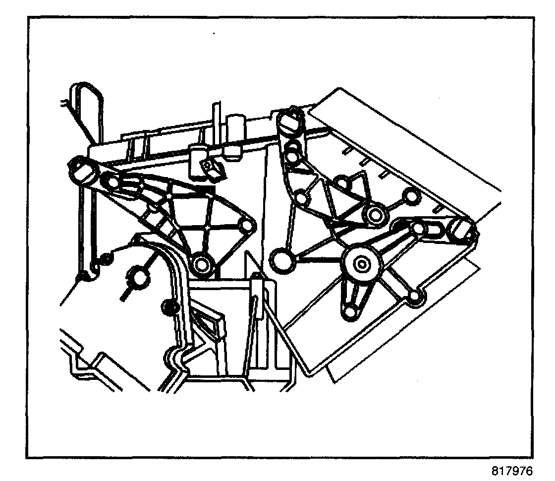

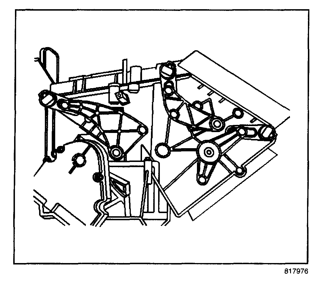

pic 13
4. Note the position of the door levers to the cam. The mode door levers must be in the same position in order to reassemble the mode actuator to the HVAC case.

1. The mode door levers must be in the this position in order to reassemble the mode actuator to the HVAC case.

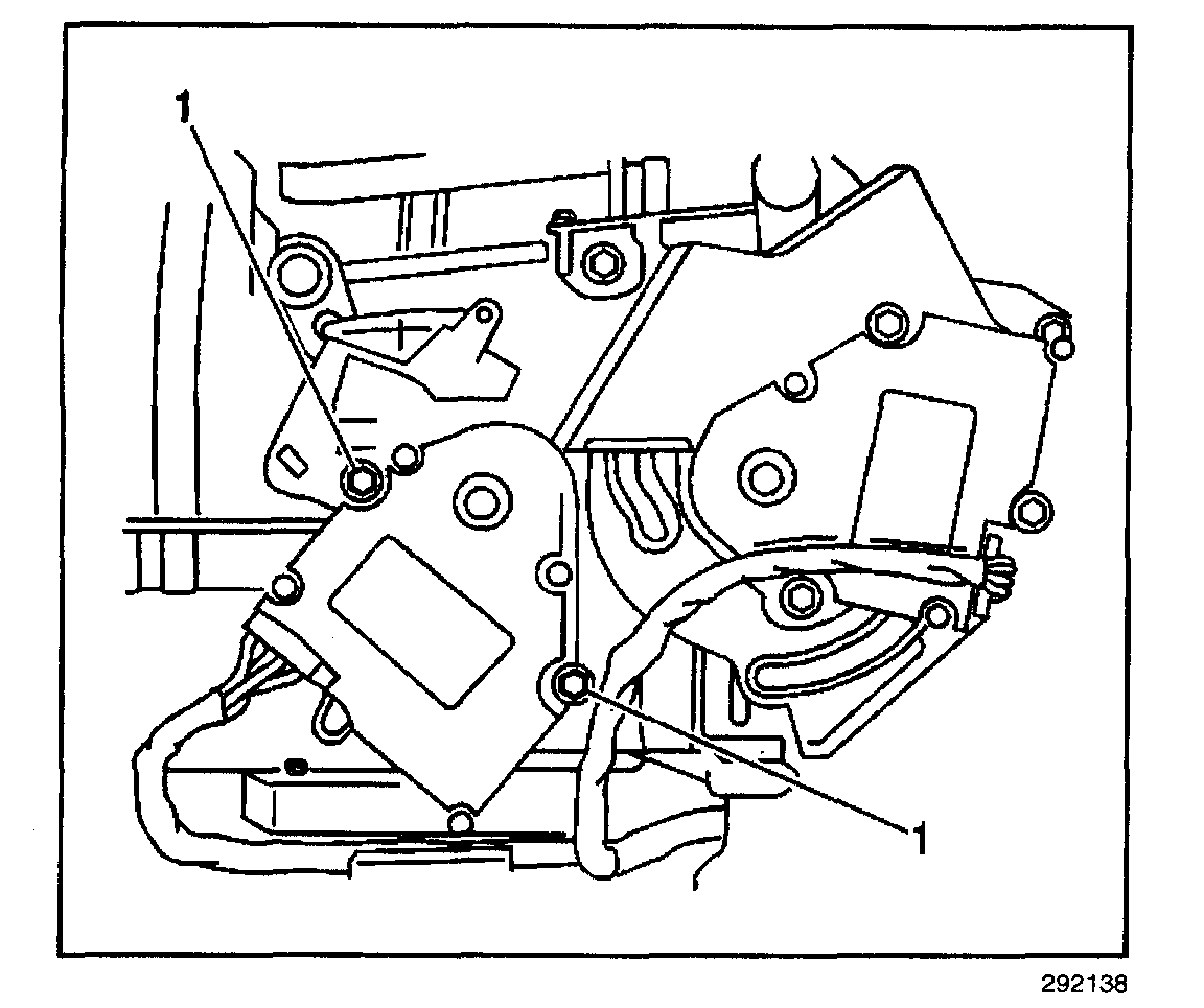

pic 15
2. Lubricate the pivots on the mode door levers and the channels on the mode motor cam before reassembling.
3. Align the mode door levers with the cam slots, as noted on disassembly.
4. Install the mode actuator to the HVAC module.
NOTE: Refer to Fastener Notice in Service Precautions.
5. Install the mode actuator retaining screws (1).
Tighten
Tighten the screws to 1.4 N.m (12 lb in).
