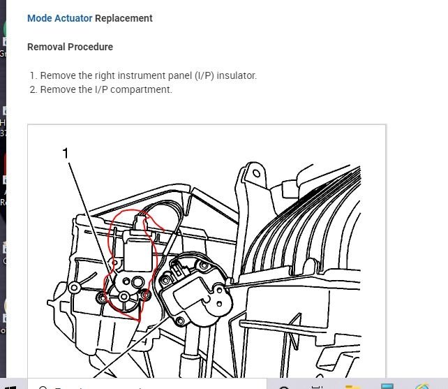

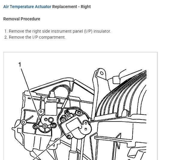

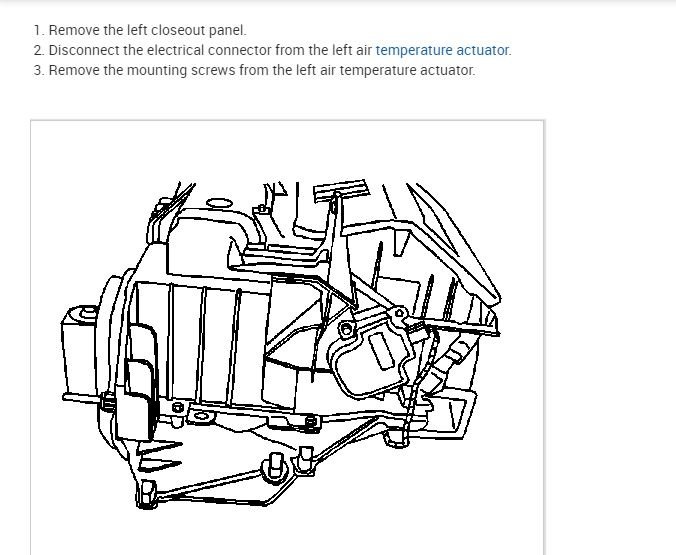

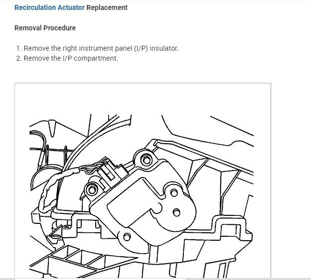

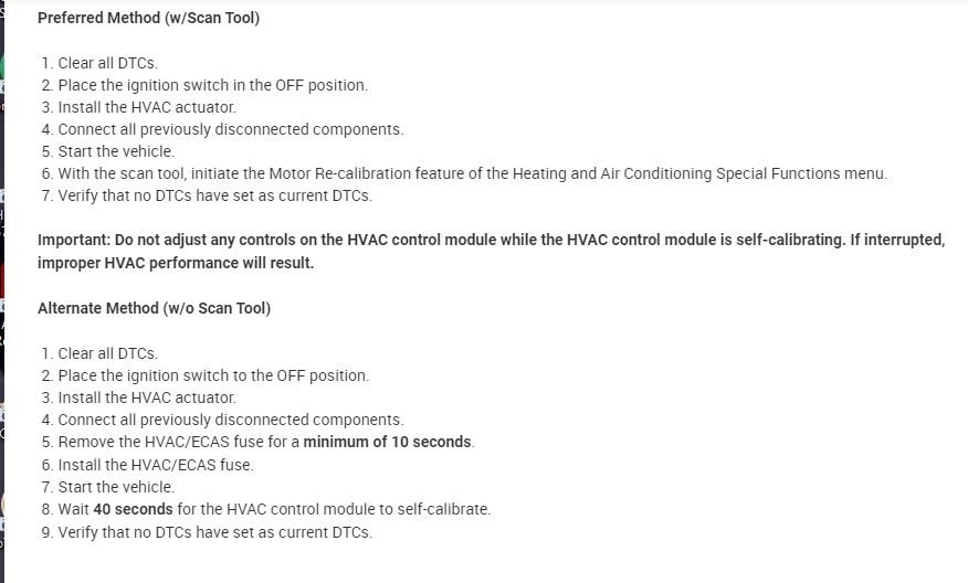

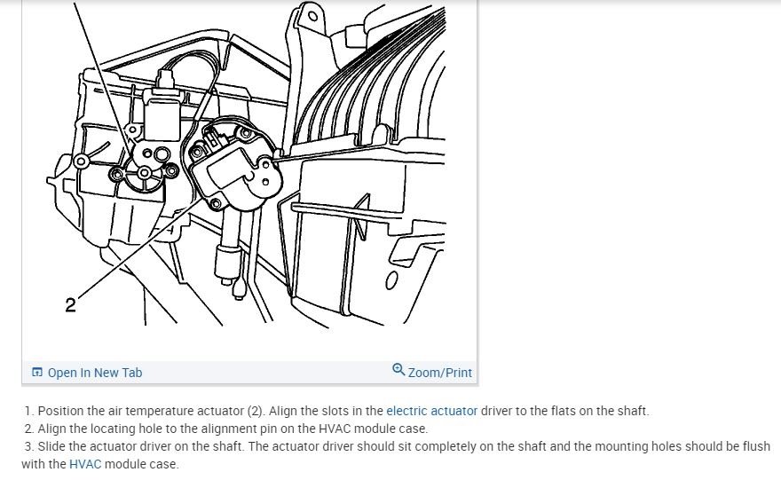

Where are the mode and blend doors actuators located on a dual temperature control on the car listed above? Also, the same question for the recirculation actuator.
Nov 1, 2021 at 8:01 AM
Good afternoon,

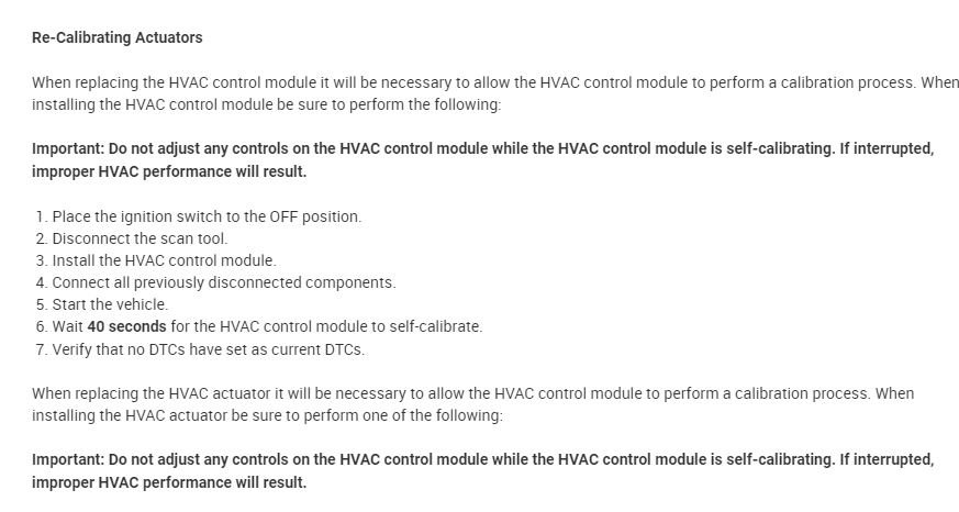

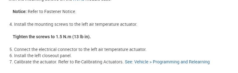

I attached the location and the procedures for replacing the motors including the calibration that is required to be performed at the end.
Let me know if you have any other questions.
