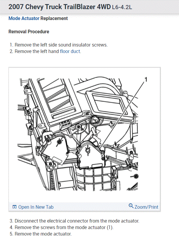

my air does not bow out front vent.s we have a mode actuator but do not know where it goes and how to get there.
Jul 1, 2021 at 9:59 PM
  • 110,194 POSTS

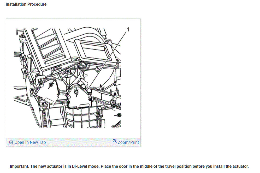

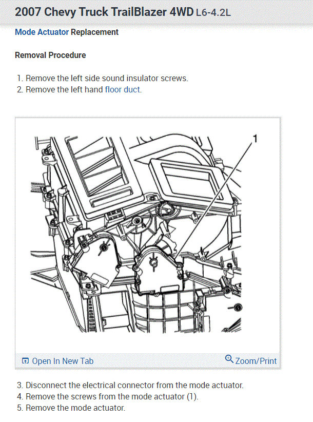

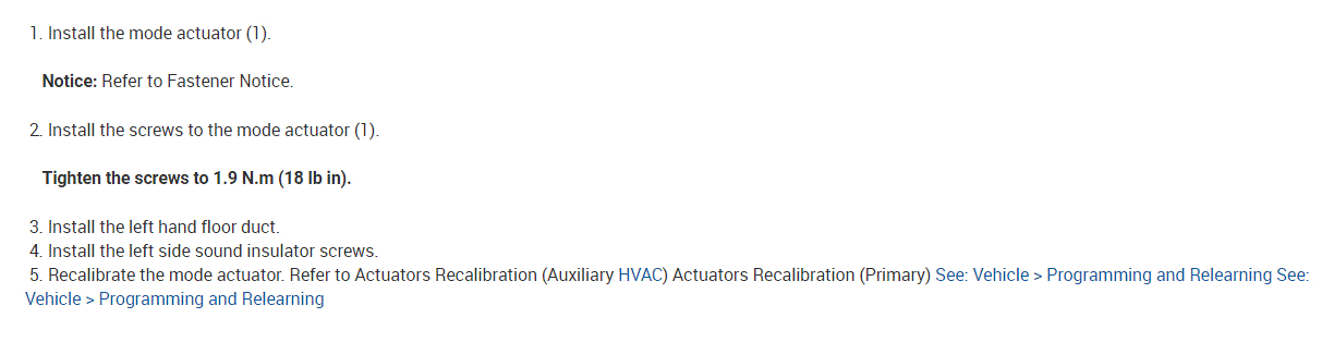

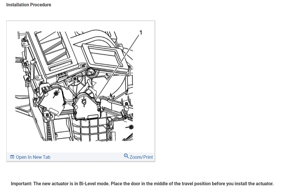

The mode door actuator is located under the dash on the left side of the HVAC box.

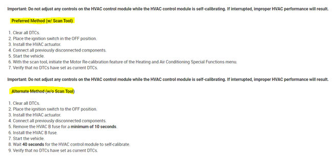

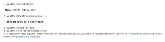

If you look below, I attached the directions and pics for replacement specific to this vehicle. I am basing this on a manual temp control system. If the vehicle has automatic temp control, let me know.

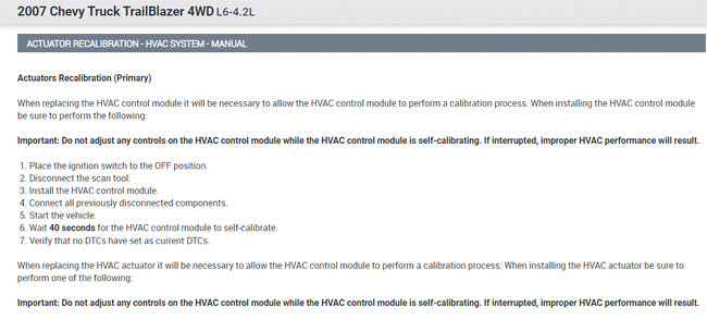

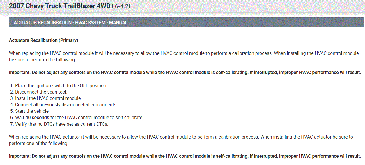

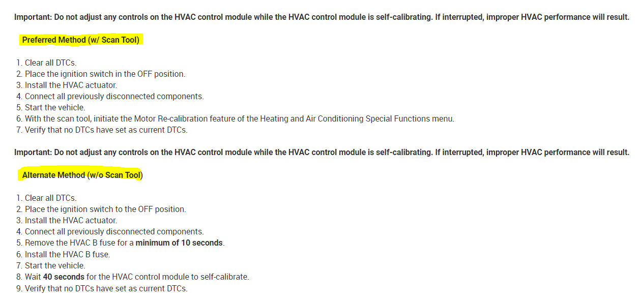

The last two pics are the recalibration procedure. One way is with a scan tool and the other is without.
