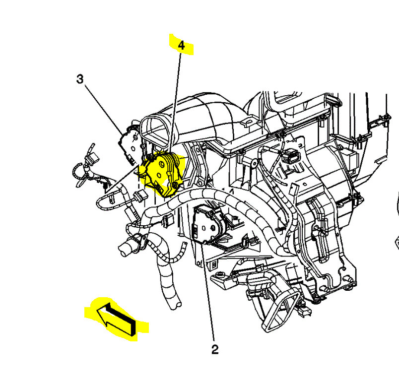

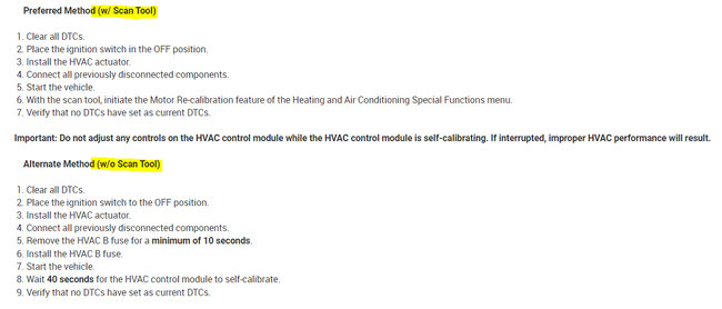

which one is mode actuator and how to take it out?
Jul 4, 2021 at 4:28 AM
  • 110,241 POSTS

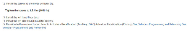

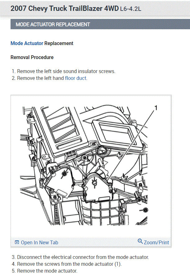

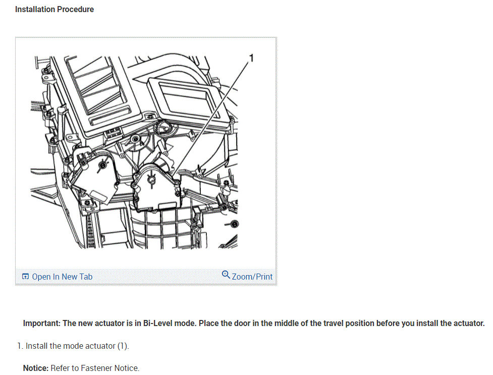

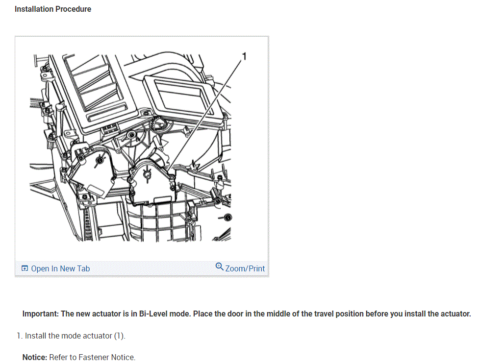

It is located under the dash on the left side of the HVAC unit. If you look below at pic 1, I highlighted the actuator and the arrow I highlighted indicates the front of the vehicle.

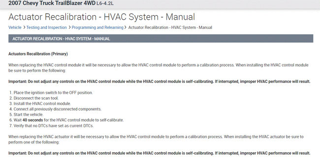

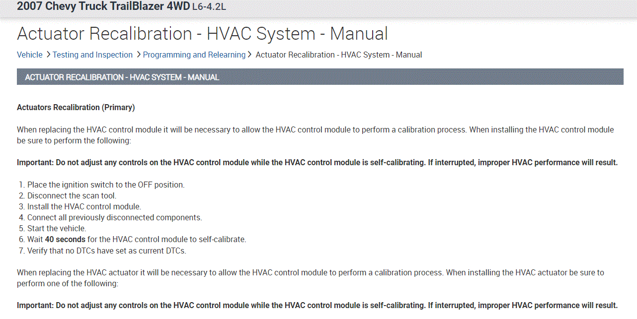

The remaining pics are the directions for removal and replacement. Once it is installed, you will need to calibrate it. I included those directions as well. You can do it using a scanner or without one. I included both.
