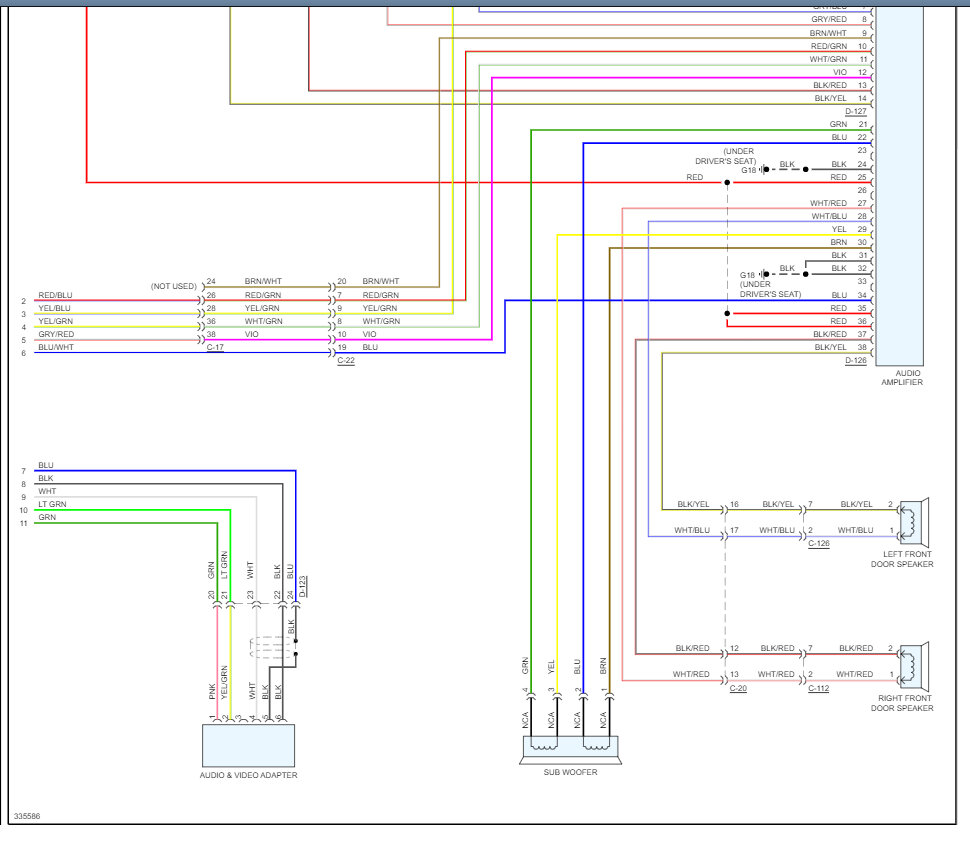

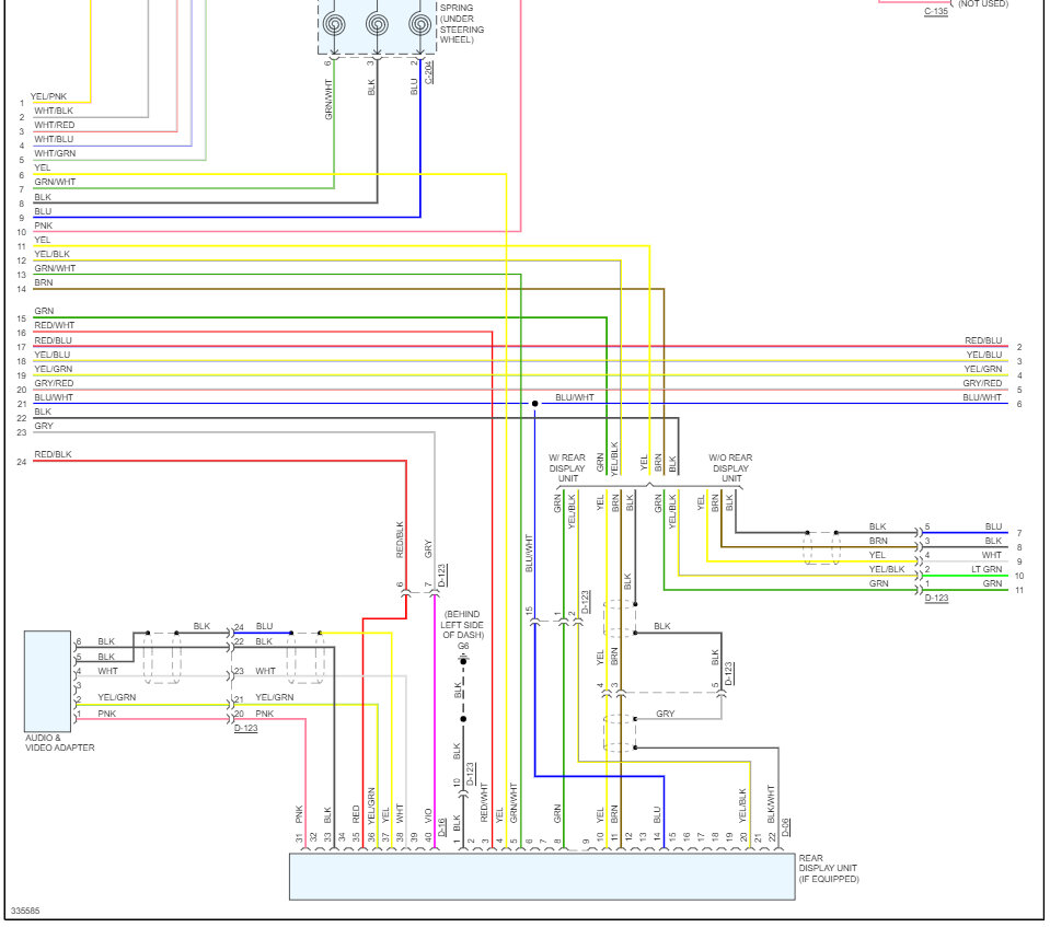

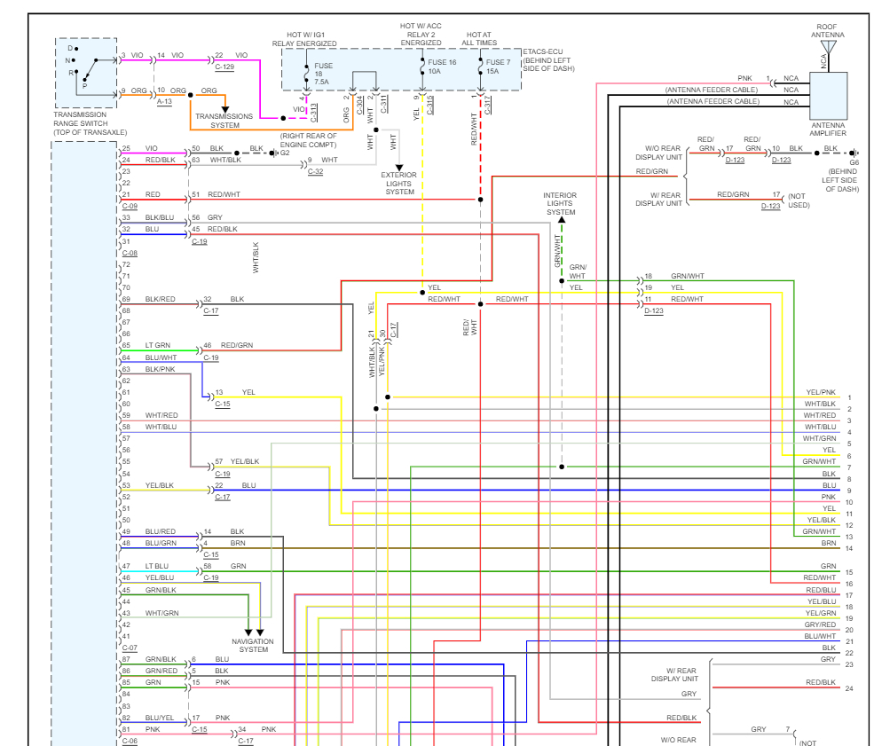

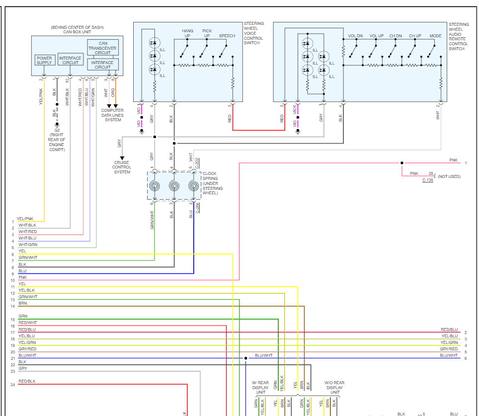

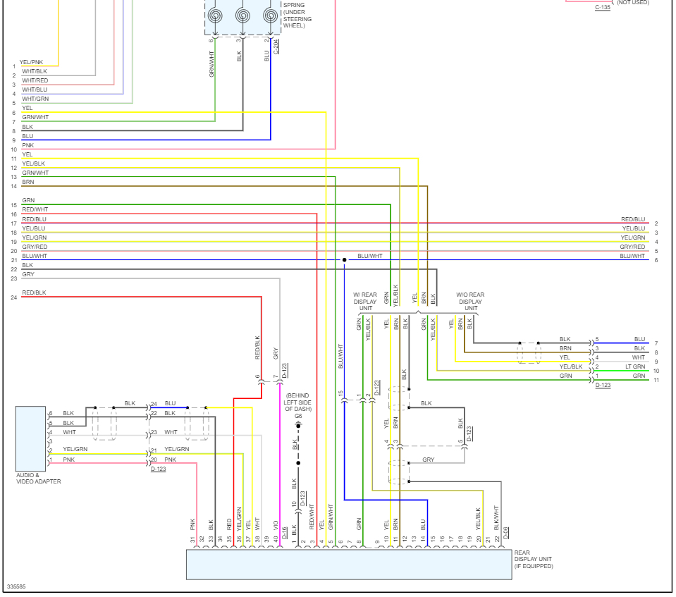

Hi. I was trying to replace the car stereo on one of my friend's' cars with a touch screen Android system. I made the mistake of taking out the wires from a connector and did not take a picture before. Now I don't have any clue in what order I should put back the wires. It is the black and white 32 pins connector, but it only uses 13 wires.
Feb 11, 2023 at 8:43 PM
  • 55,402 POSTS

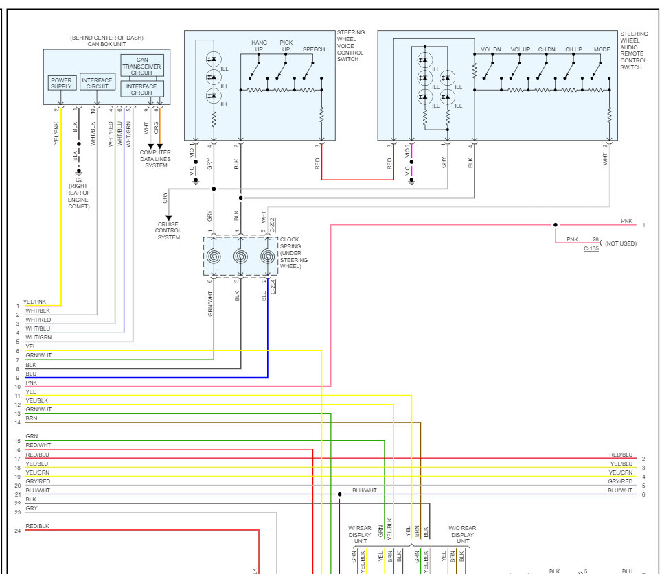

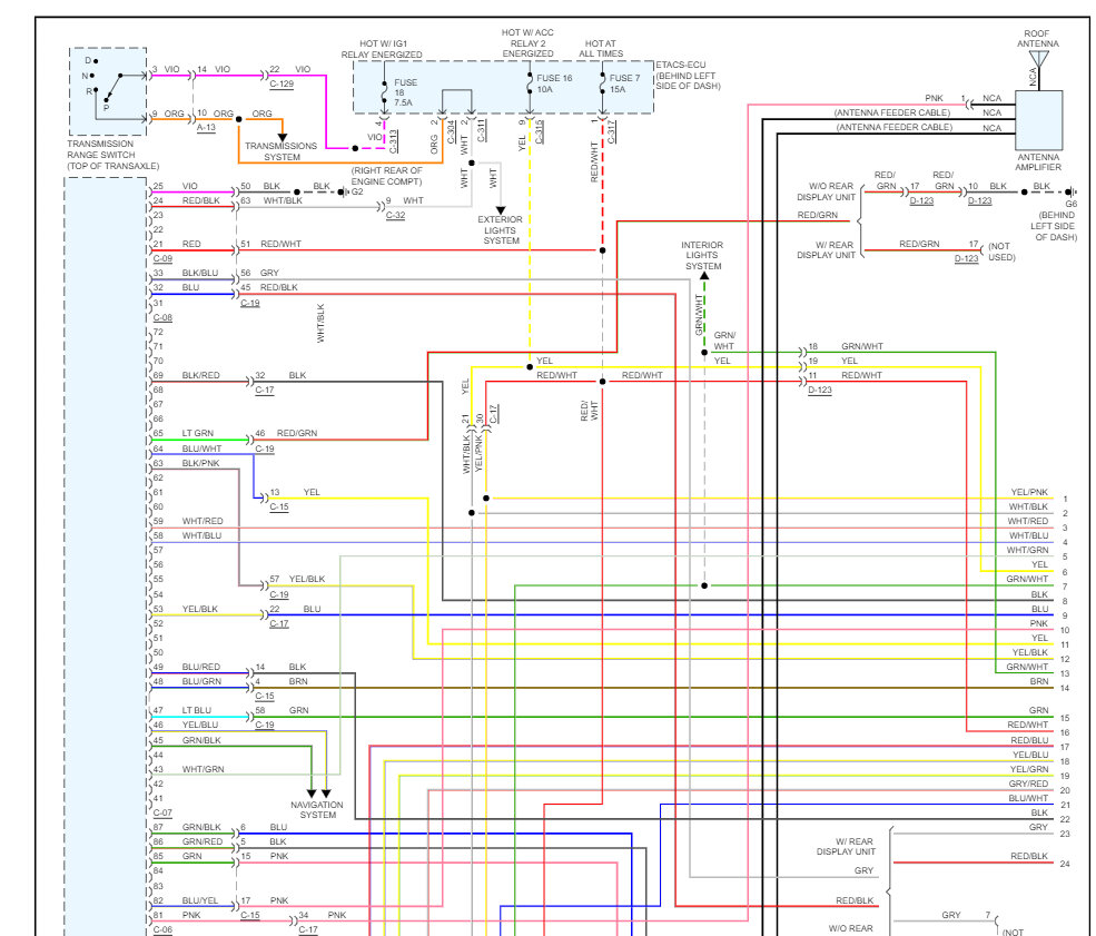

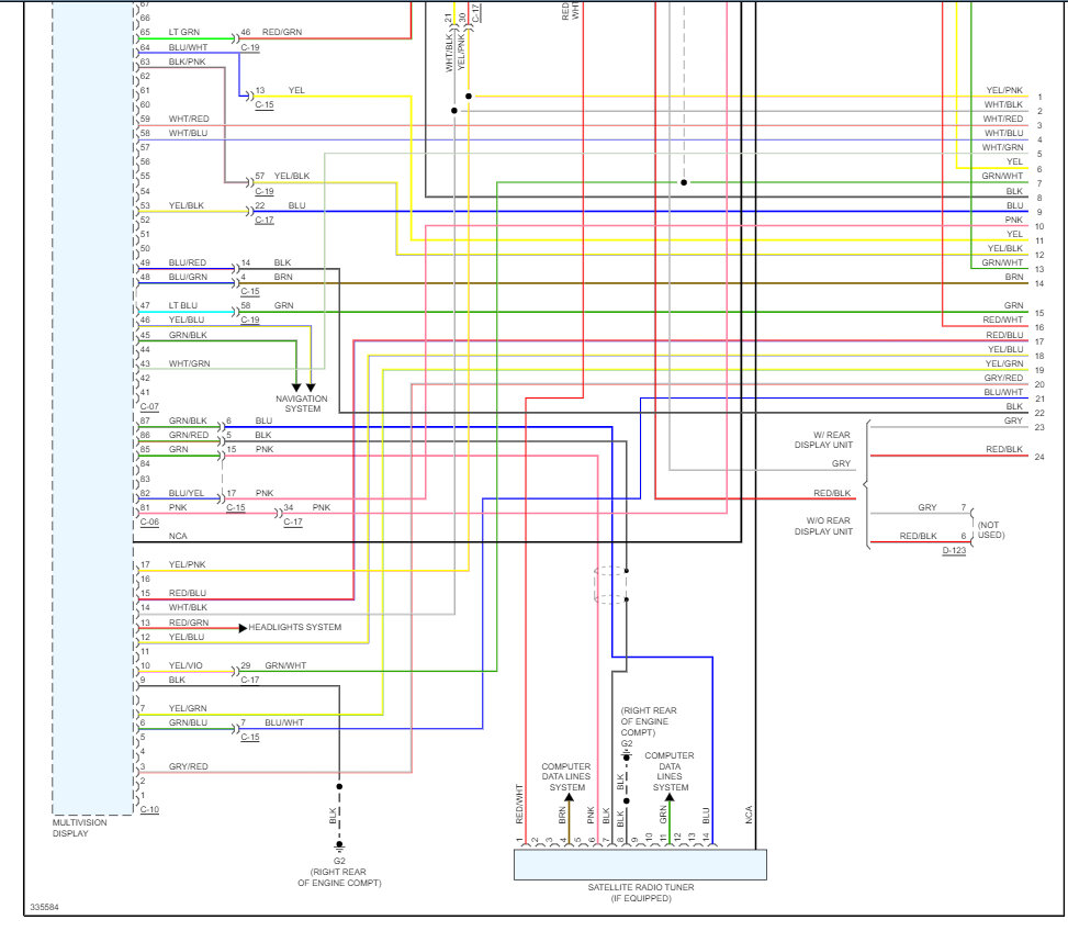

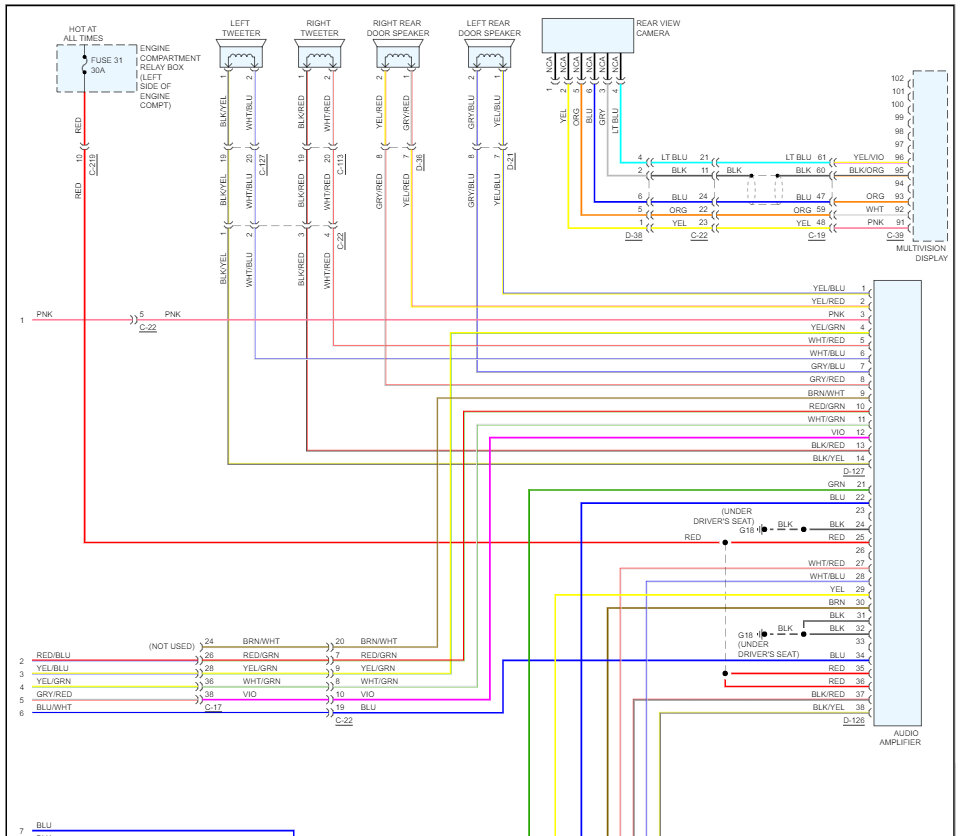

Yep, here are the radio wiring diagrams you have requested. There are three different options, but I think I got the correct one but if not let me know and i will upload the remains options. Please check the images below.
