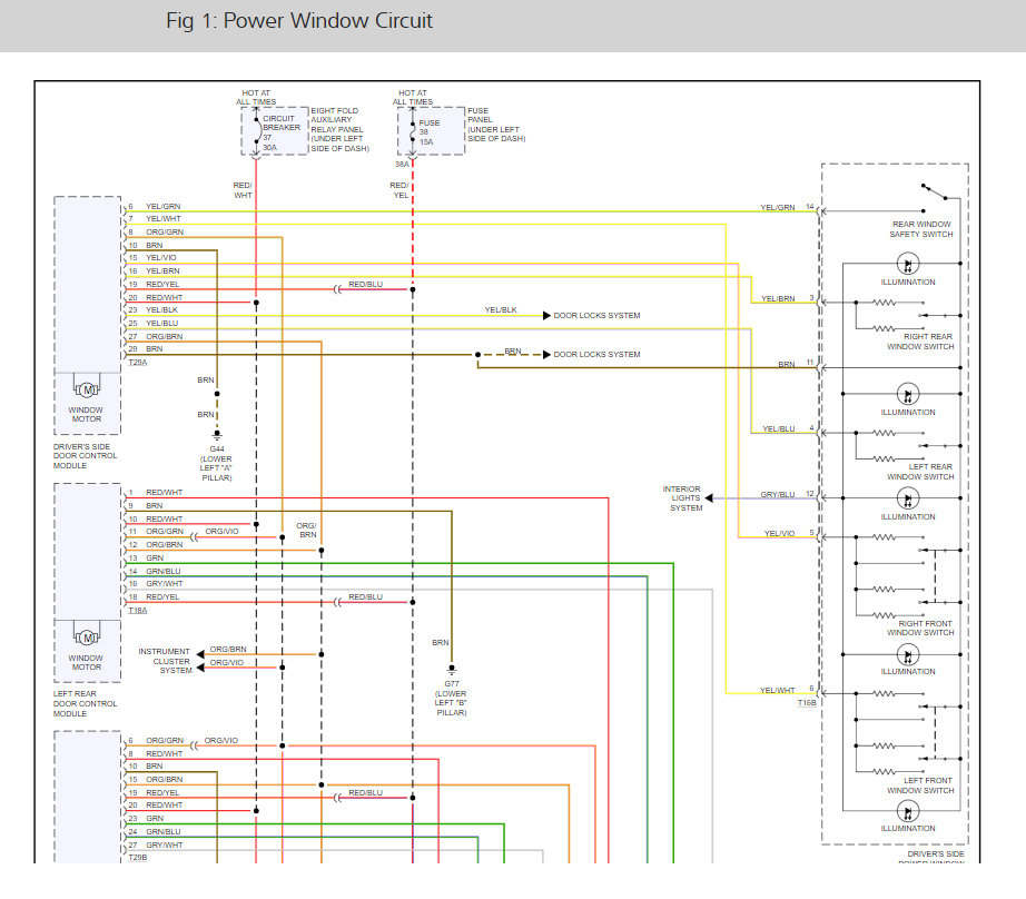

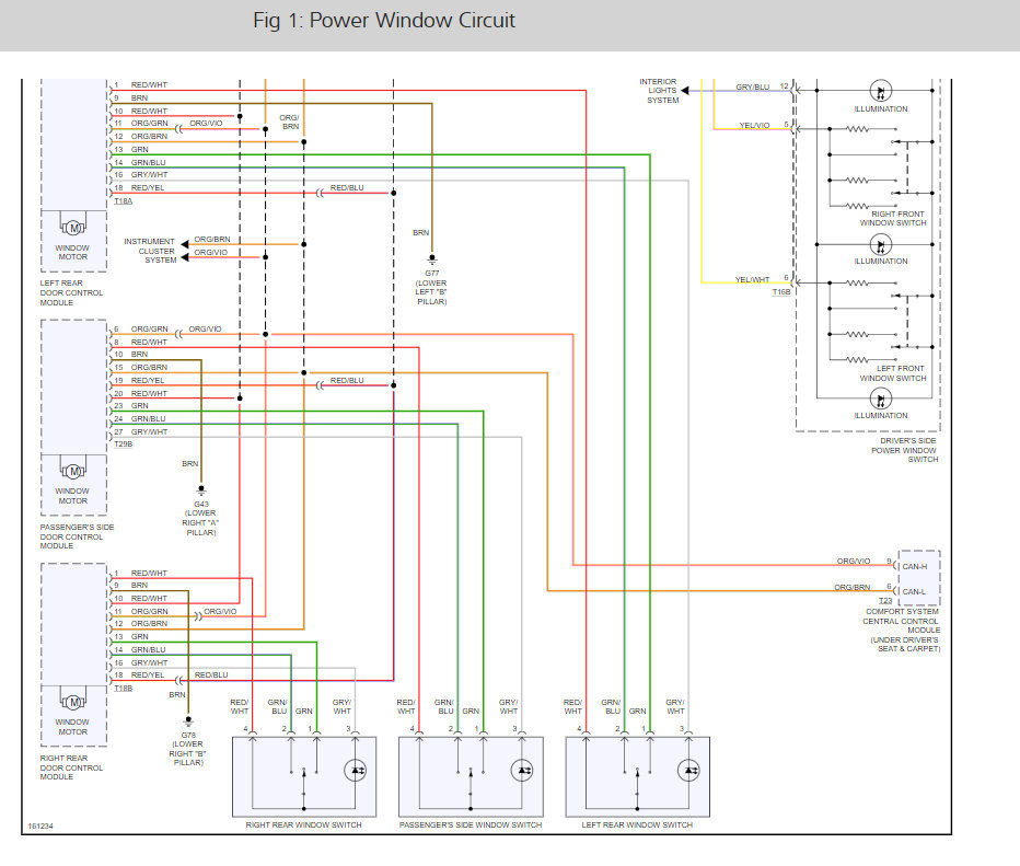

Windows are not working
190,000 MILES • 1.9L • 4 CYL • TURBO • 2WD • MANUAL
MLADEN
The door only sounds like that and that is it. they are not fuses and is not a window motor.
Jan 20, 2020 at 2:45 AM
  • 55,710 POSTS
It sounds like a ground or the window switch is not working. To be sure here is the window wiring diagrams and a guide to help you check for power and ground and to be able to see how the system works:
and
https://www.2carpros.com/articles/electric-window-repair
Jan 21, 2020 at 3:28 AM
