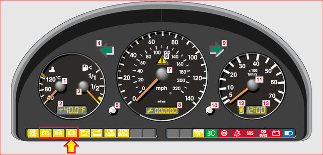

When we start engine and after seven minutes, three lights comes on (see attached)
then gear change to R or D strongly!
Also, if we drive the car , transmission will not change (stuck in one gear only)
but if we turn engine off and on again every thing will be fine for the next seven minutes.
After scanned we found following code :
C1142 : B24/2 (ESP LATERAL ACCELERATION SENSOR (LAS)
Note : check engine light do not appear at any time (I think it is removed or canceled).
Note two : ABS and speed sensors , ABS connector (all) has been removed and cleaned. All relays and fuses checked.
Any advice please.

The ESP Lateral Acceleration Sensor is most likely faulty and needs to be replaced. I am not sure of the exact location for your vehicle but should be mounted in the trunk behind the rear seat under a plastic panel.
