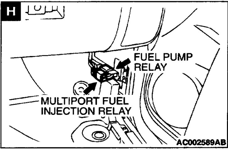

Does my vehicle listed above Sport XLS 3.5 have an inhibitor switch and if so location? thanks

I found no such switch for your particular vehicle. What is the particular issue you are having with your vehicle? Hope this helps and thanks for using 2CarPros.

My vehicle listed above shut off on me while driving. it will crank but not start. we put new fuel filter on and camshaft sensor on it's not getting spark or fuel to the fuel pump.when they take the fuel pump off and direct hooked it up it was pumping fuel so maybe you could help.i thank you so much for trying to help me..

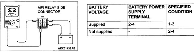

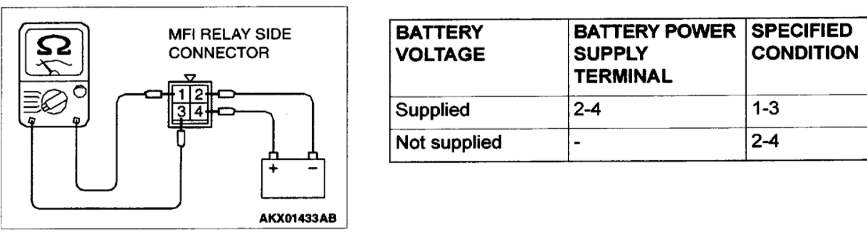

First thing I suggest to test would be the fuel pump relay.It is located at the right side kick panel. I've attached a picture below of its location.Here is a tutorial showing how to test a relay:
https://www.2carpros.com/articles/how-to-check-an-electrical-relay-and-
wiring-control-circuit
Hope this helps and keep me updated.Thanks for using 2CarPros.
