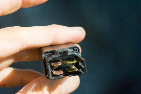

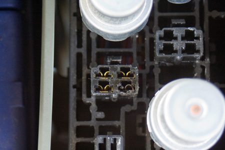

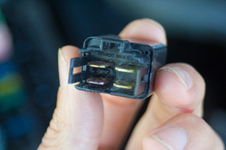

Here, I just took some pictures, it might help with the orientation process of which number is which.
https://images.2carpros.com/forum/automotive_pictures/505242_IMG_1032_1.jpg
Looking at the relay in a good light, I noticed that the two right pins (looking at it from the bottom) are redder, and the plastic is not as even. Is it always like that or is that evidence of corrosion or burning? The bottom left socket plastic is also uneven (it might be because of all the taking out putting back in though...
https://images.2carpros.com/forum/automotive_pictures/505242_IMG_1034_1.jpg
https://images.2carpros.com/forum/automotive_pictures/505242_IMG_1033_1.jpg
Anyway, can you direct me which is terminal #1 and #3 with that picture?

The 2 terminals that are redder would be 1 and 3. They are subjected to high current and the heat is causing the difference in color. It can also mean the relay is bad.
You can try pulling another relay to swap with it and test.
As long as the relay has 4 pins, it is the same type. The 2 round relays in the picture should be 4 pins as well.

Problem solved!
I tried bypassing the relay with some wire and the lights turned on! So I ordered a new one and it arrived today. Put it in and everything is back to normal!
Thanks for all the back and forth help!
Funny thing though, the two connector pins on the new relay are also discolored. So I guess that it wasn't an overload problem.. Oh well
