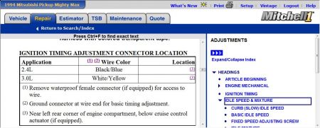

Electrical problem
1994 Mitsubishi Truck 4 cyl Two Wheel Drive Manual
I'm haveing a problem finding the wireing plug you unplug to set the timing?
Aug 22, 2009 at 11:36 PM
  • 75,992 POSTS
See below
https://images.2carpros.com/forum/automotive_pictures/12900_timing_29.jpg
