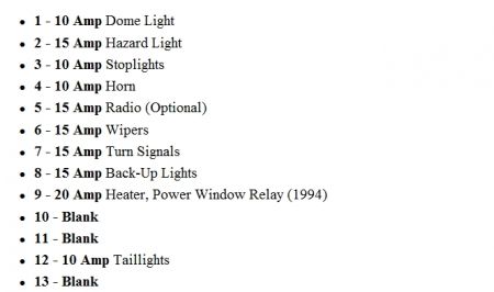

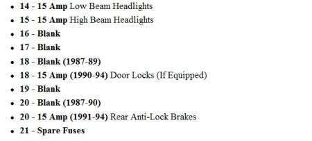

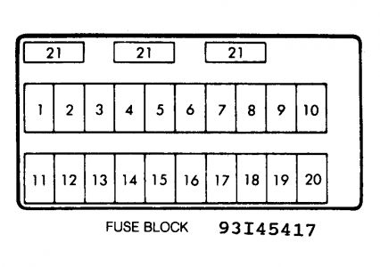

Just got this truck and been fixing it up although it did not come with the manual. The person that had it removed all the fuses and I have no way to know the locations or fuses sizes for me to put new ones in...I need the line up/diagram for the fuse box...Help...

Here are the fuse panel diagrams with a guide to help you test for power https://www.2carpros.com/articles/how-to-check-a-car-fuse
https://images.2carpros.com/forum/automotive_pictures/261618_Graphic_668.jpg
https://images.2carpros.com/forum/automotive_pictures/261618_Noname_2638.jpg
https://images.2carpros.com/forum/automotive_pictures/261618_Noname2_861.jpg
