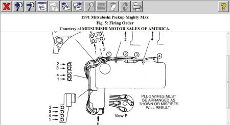

1991 Mitsubishi Truck 4 cyl Two Wheel Drive Manual
I am working on a 1991 Mitsubishi Truck with a 2.4L. I have replaced the coil, distributor cap, rotor, and plugs. The belts are good. It is not firing and I suspect the wiring on the distributor cap is wrong. What is the firing order for the cap (where is 1)?
Apr 18, 2009 at 8:32 PM
  • 75,992 POSTS
There you go buddy
https://images.2carpros.com/forum/automotive_pictures/12900_fo_47.jpg
