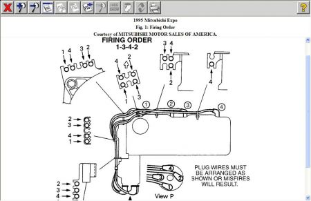

hello could you tell me the order in which the ht leads connect from the sparks to the distribuor cap?
