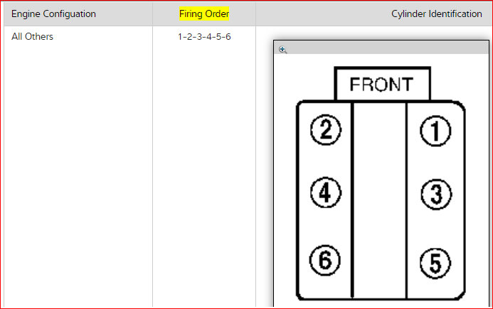

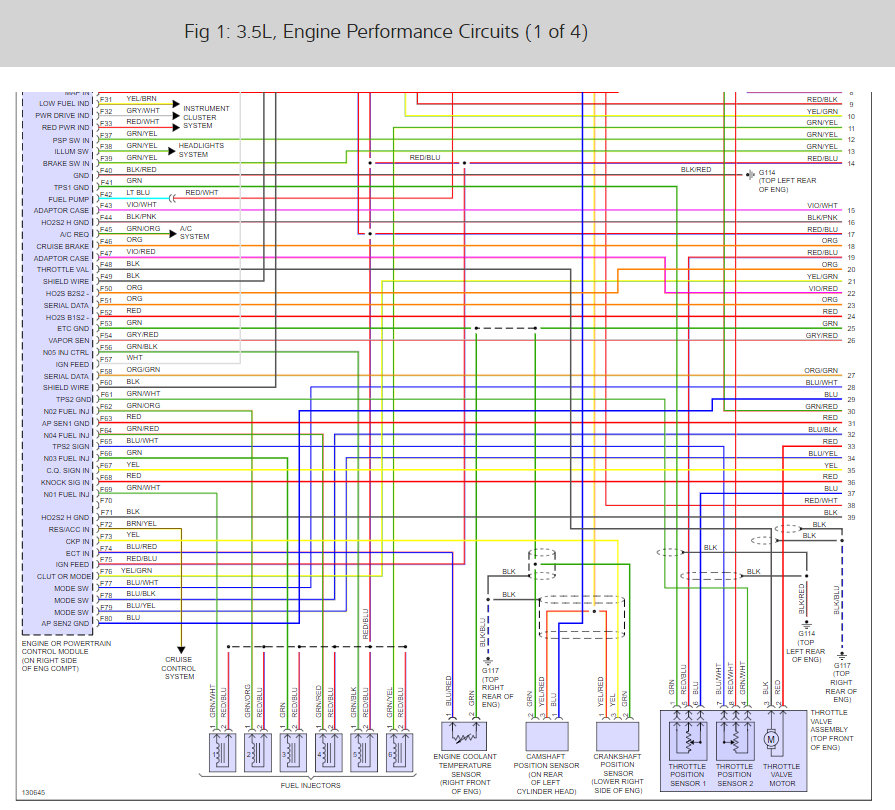

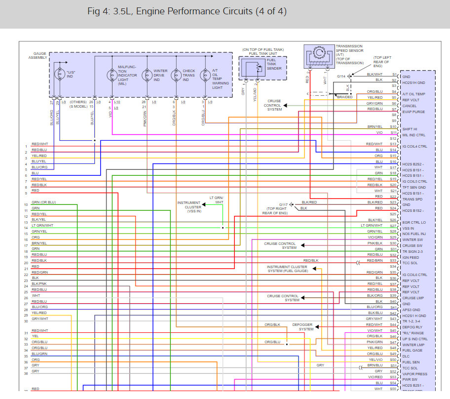

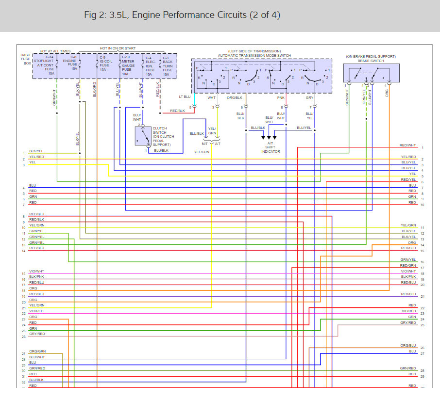

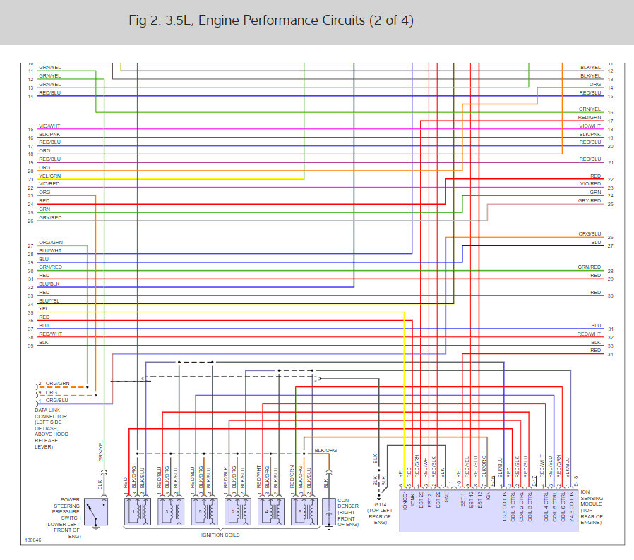

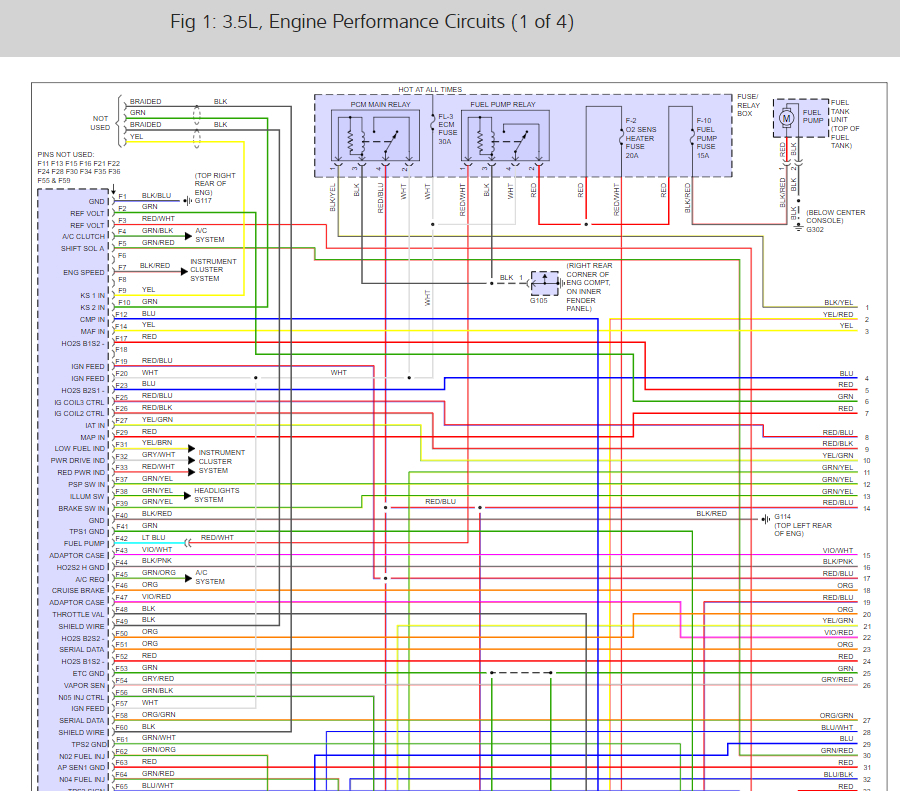

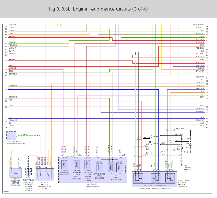

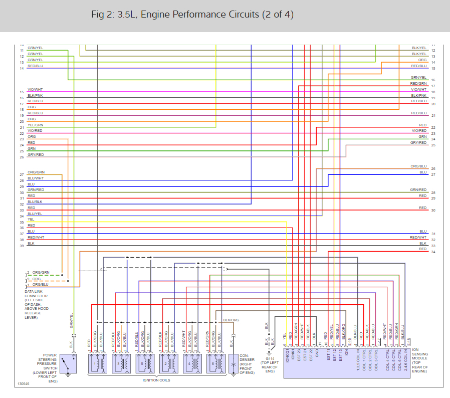

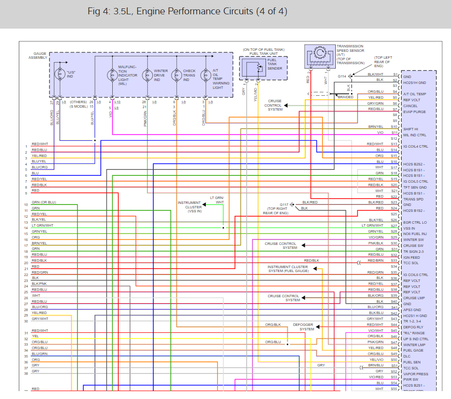

I would like to know the firing order of my vehicle listed above, GDI 6g74 engine. And how the injector harness is connected?
Sep 6, 2018 at 3:36 AM
DANNY L
  • 5,648 POSTS
Hello, I am Danny.
I have attached a picture of your firing order. Not sure what you are asking of the injector harness? Hope this helps and thanks for using 2CarPros.
Danny-
Sep 6, 2018 at 2:45 PM
  • 55,649 POSTS

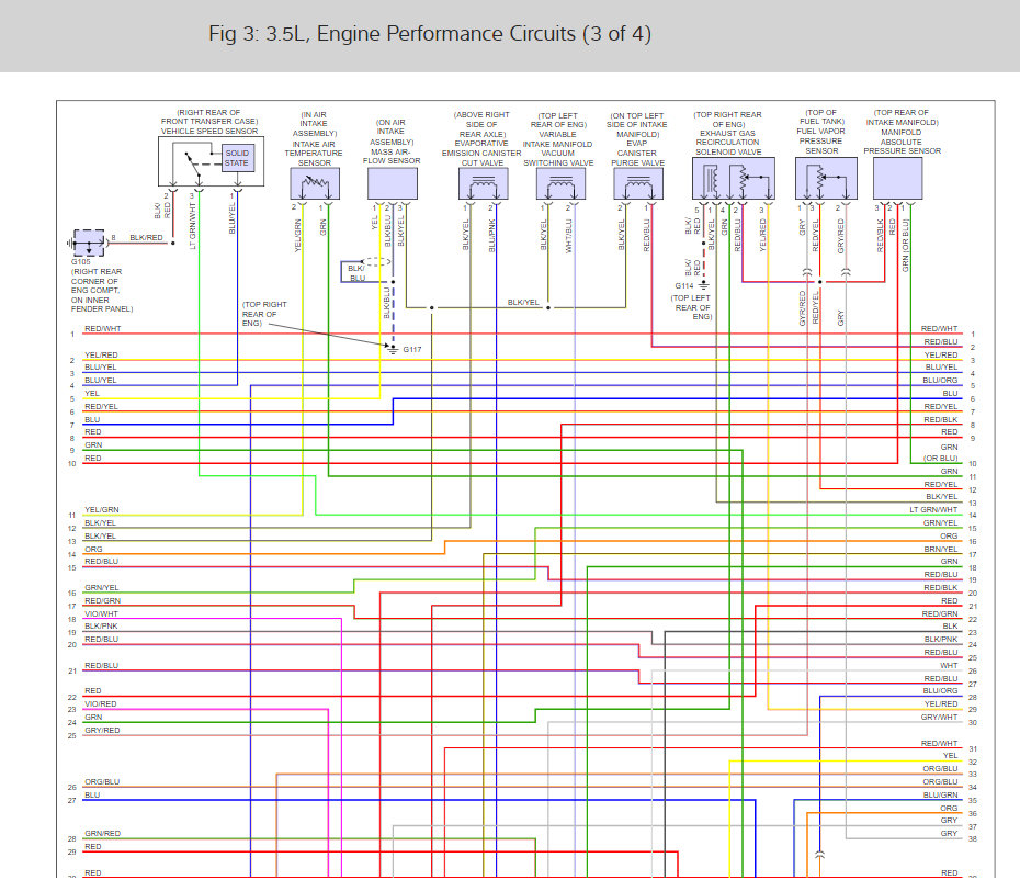

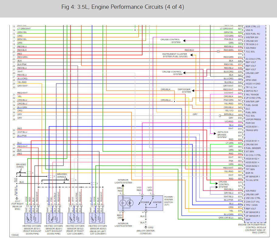

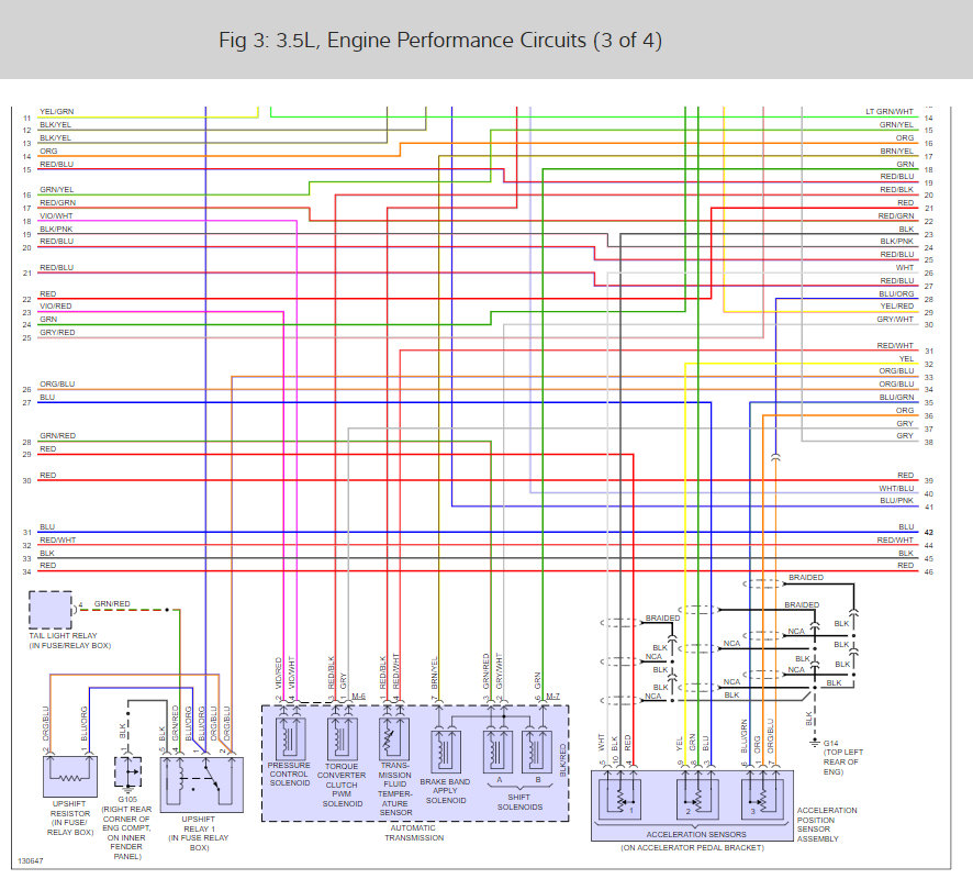

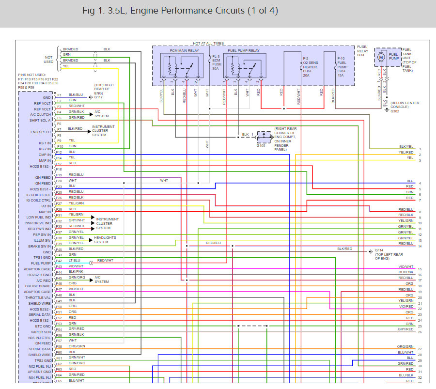

I found the engine wiring diagrams for you so you can see how the injectors are wiring up. This guide will help you test the wiring:
