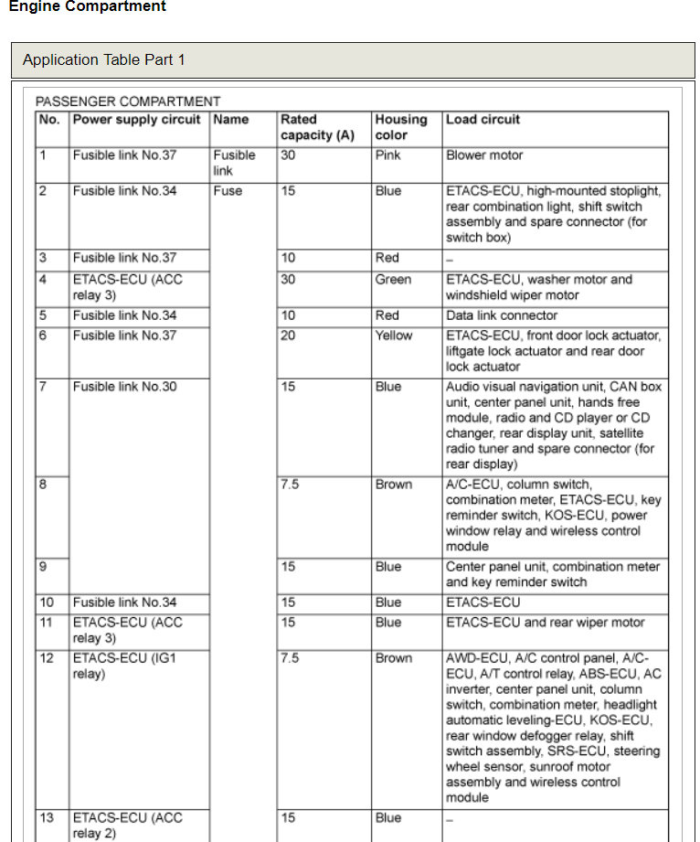

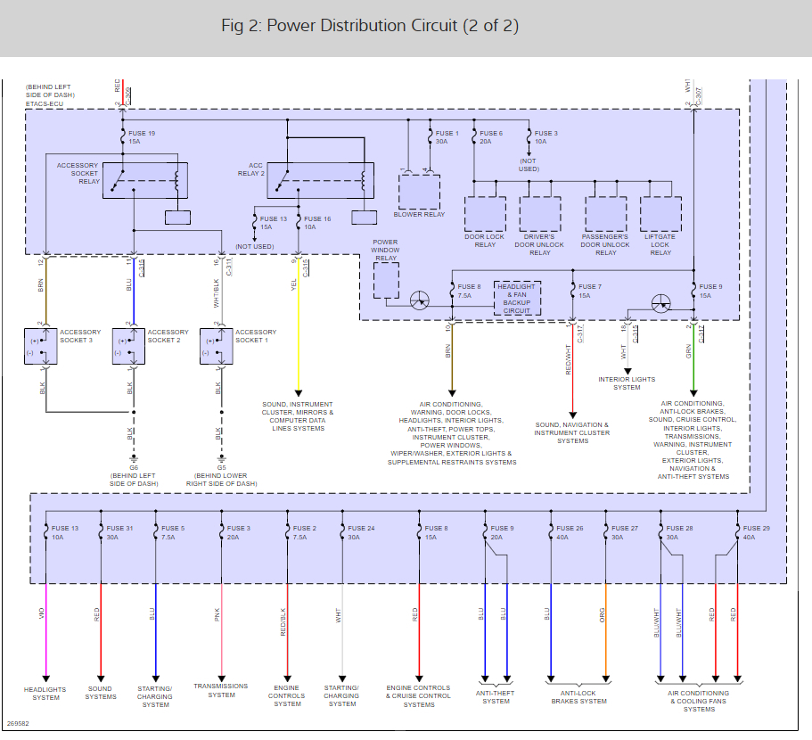

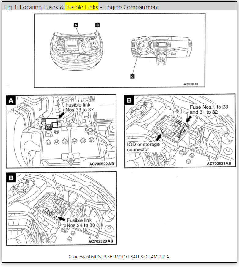

After plugging in an adapter and running a computer as well as a navigation system, the cigarette lighter ceased to work. Replaced the fuse even though it did not appear to be blown, and still not working. Any other troubleshooting tips? Or will I need to get the cigarette lighter replaced?
Sep 19, 2010 at 11:11 AM
  • 55,385 POSTS

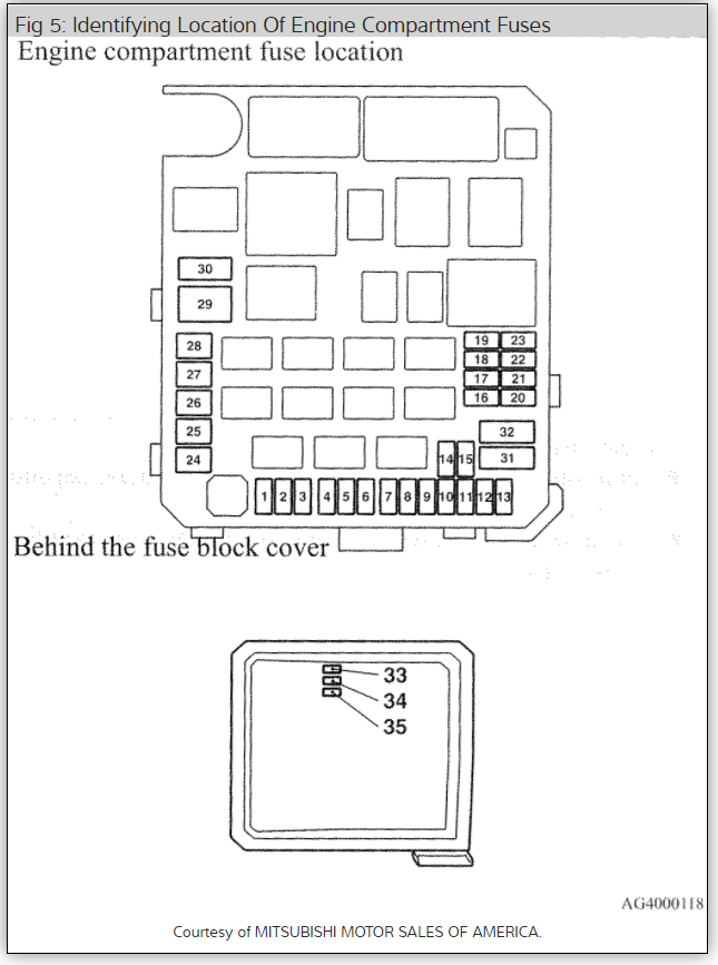

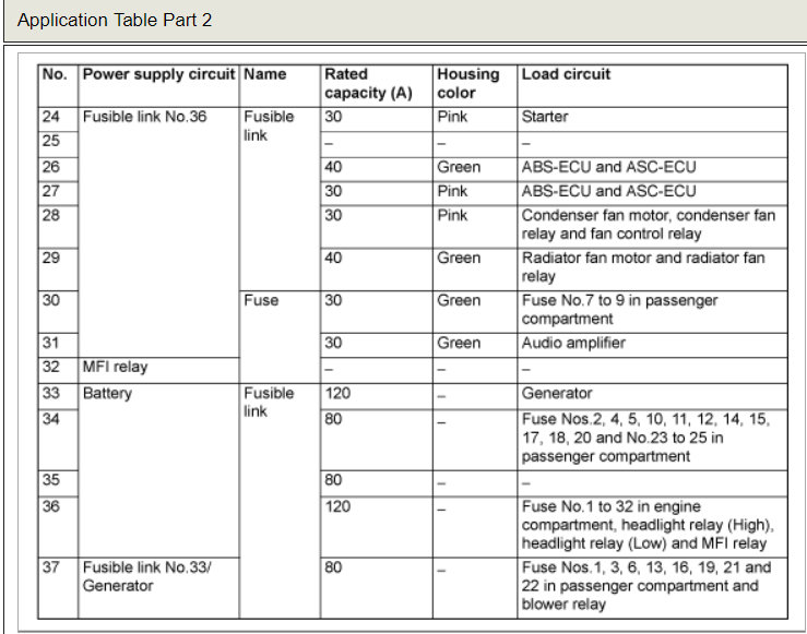

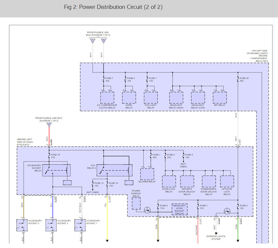

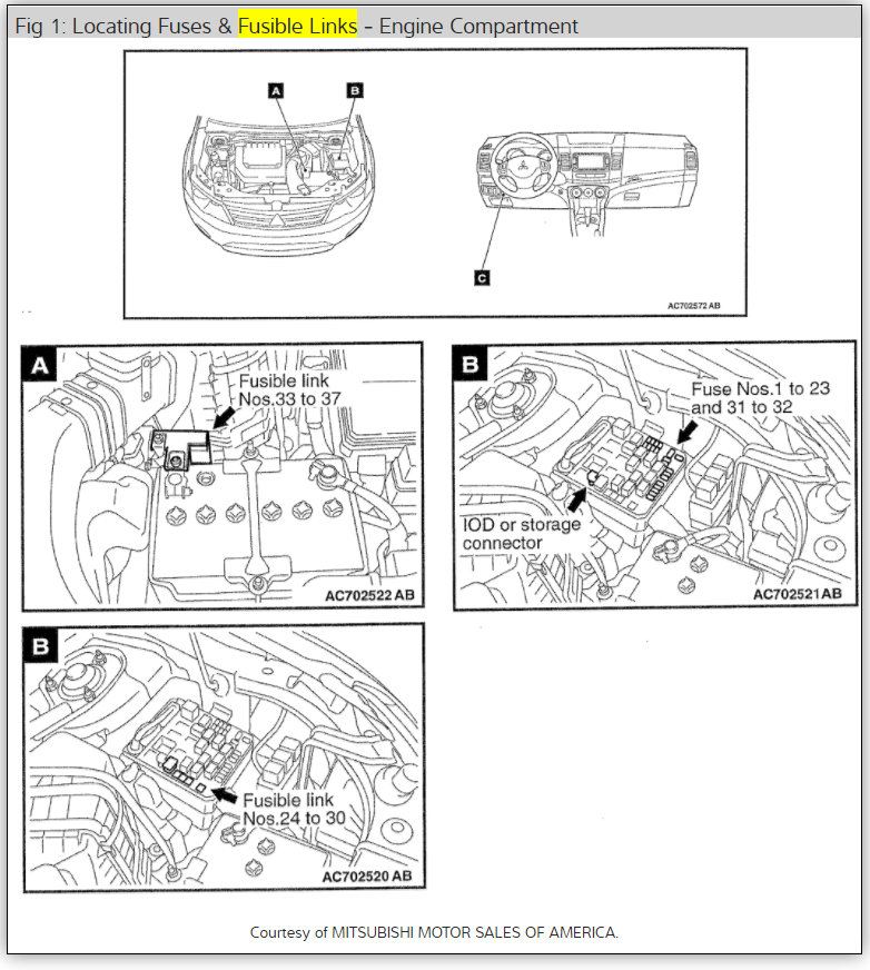

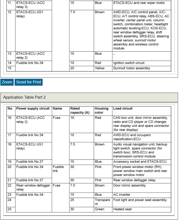

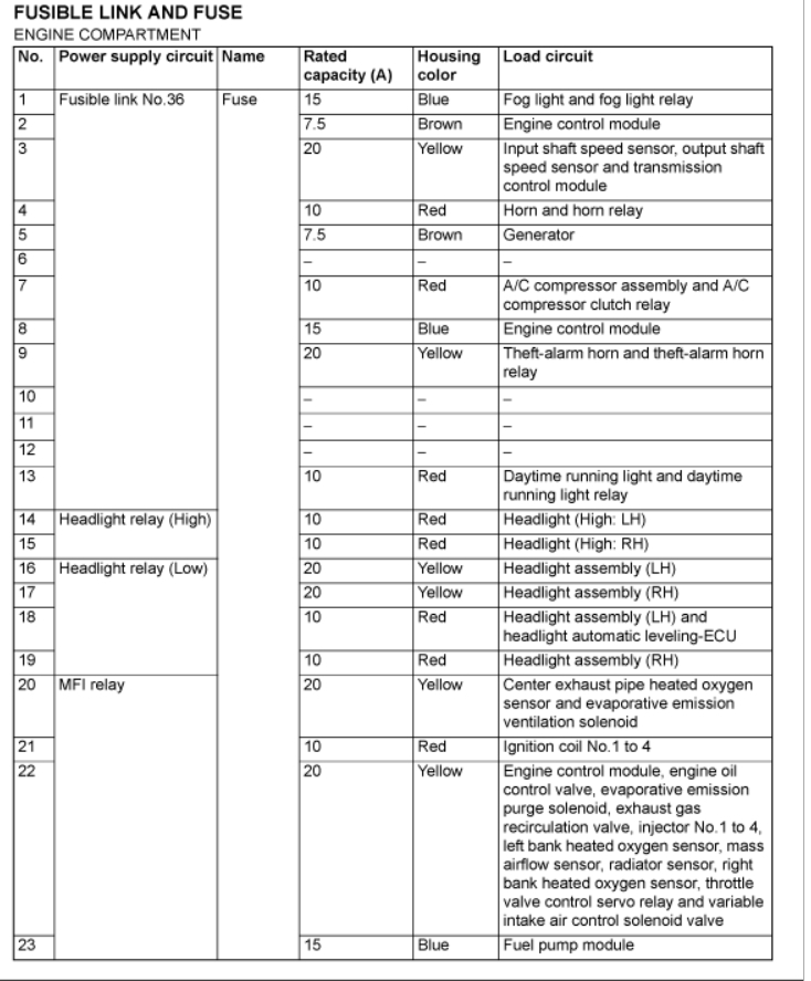

There is an accessory relay that is on the left side of the dash relay panel that needs to be checked or replaced. There are 3 accessory sockets in the car all controlled by the relay.
Here is a guide to confirm the failure.

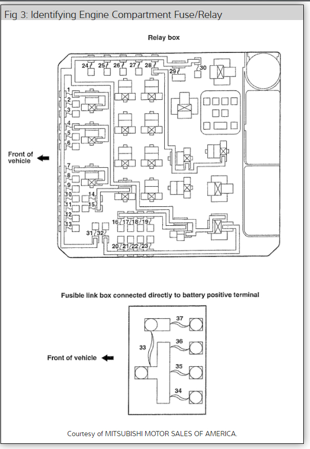

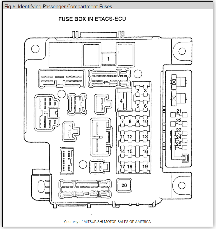

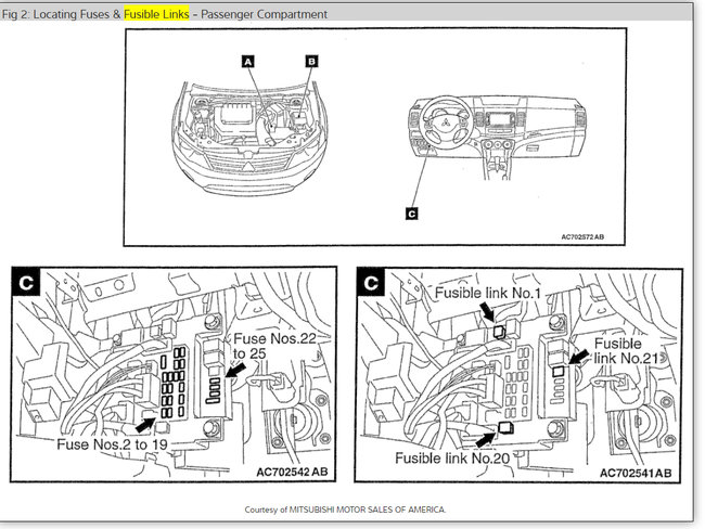

Here are the cigarette lighter wiring and fuse panel, and relay location diagrams (below)
