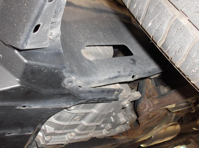

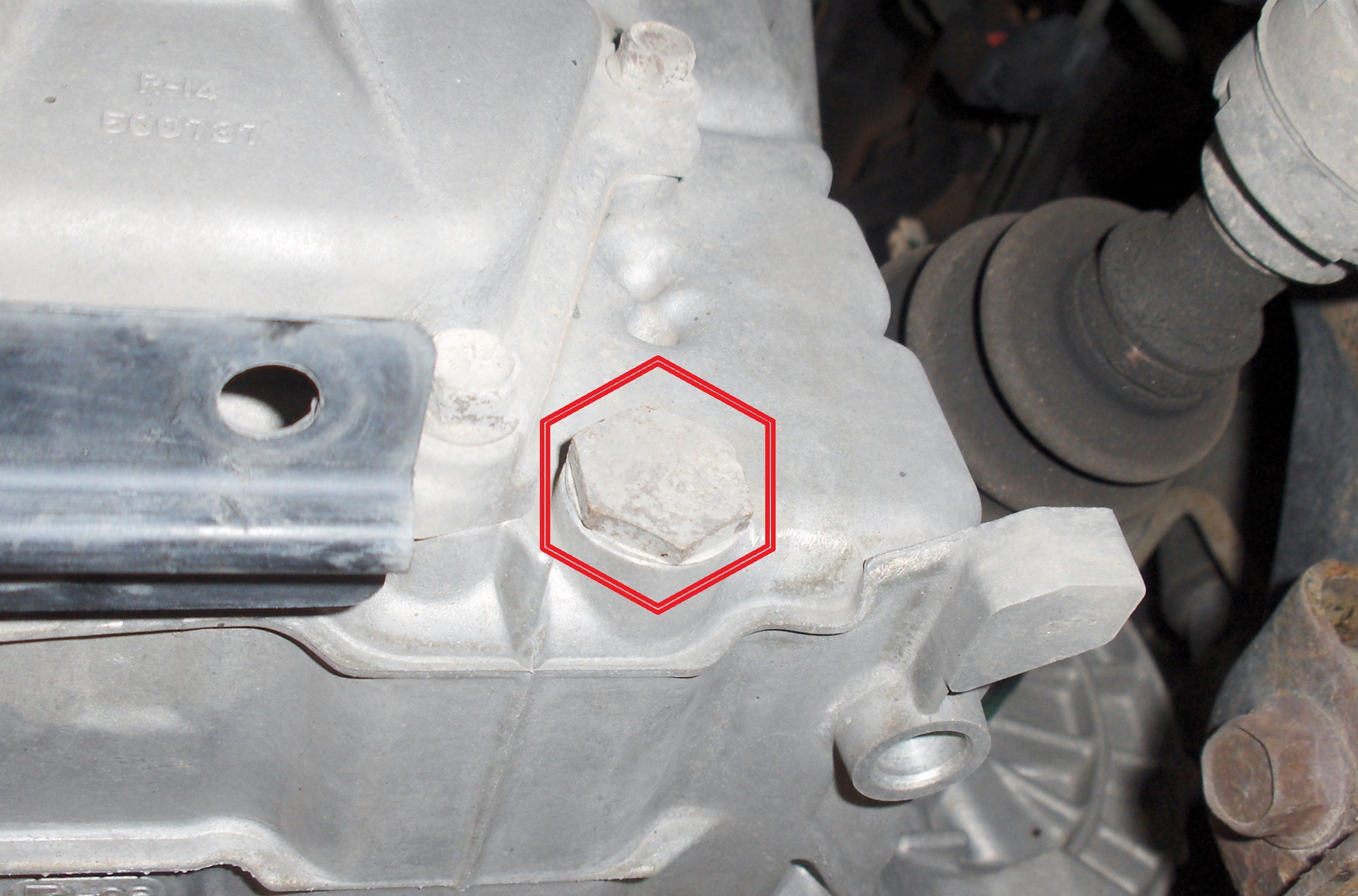

I was wanting to drain my transmission fluid, and was wondering if anyone could tell me where the Transmission Drain Plug is. Thanks.

Drain plug is located @ the bottom of the transaxle case.See below:

2003 Mitsubishi Outlander transmission drain plug is located at the bottom of the transaxle case
