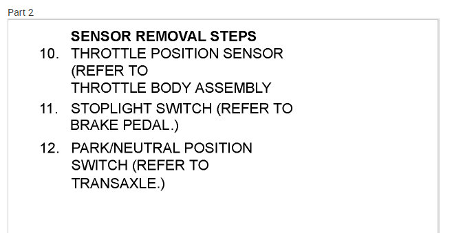

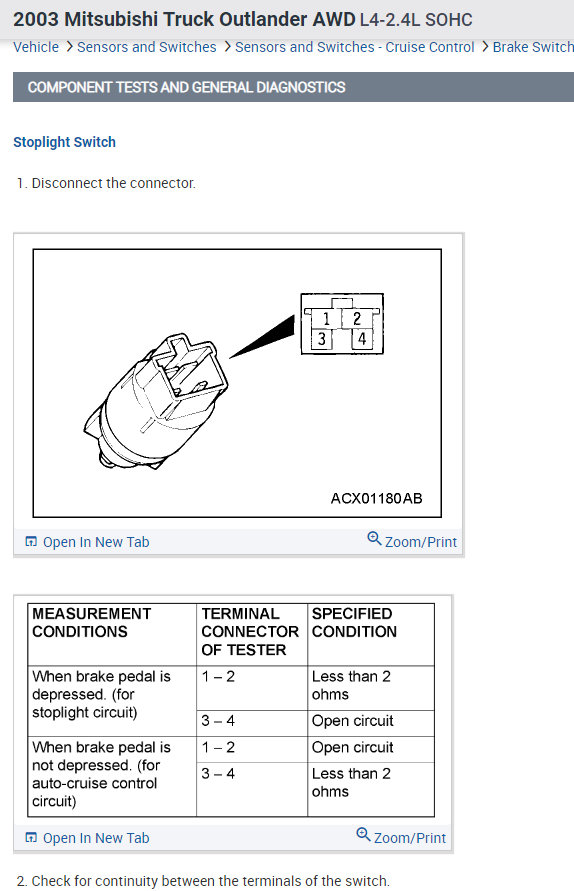

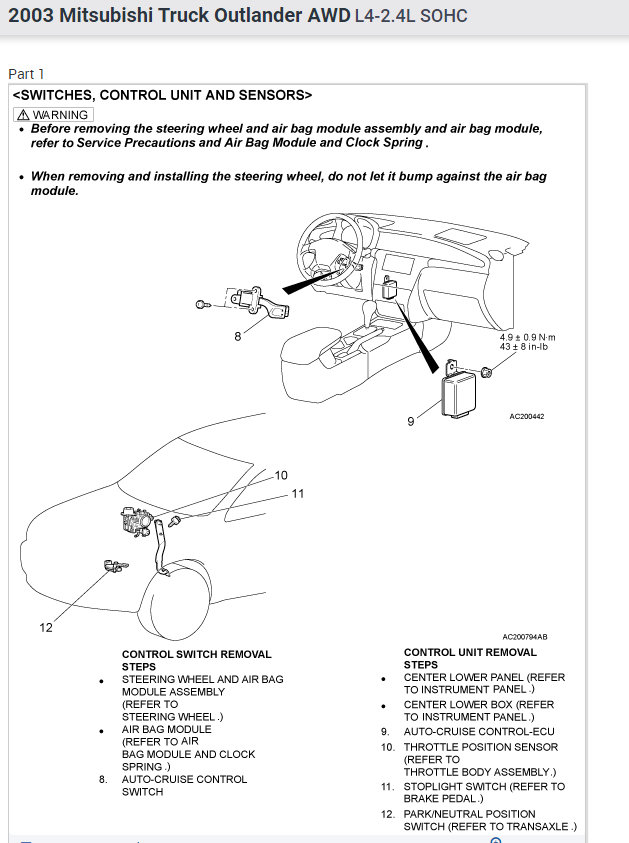

When you have an inoperative cruise control, one of the first item to check is the brake light switch.
As you know when you press the brake pedal the cruise control disengages, it is due to the brake light switch being depressed, which has connection to the cruise control module.
So first check the brake light switch connector for any corrosion or loose wires.
