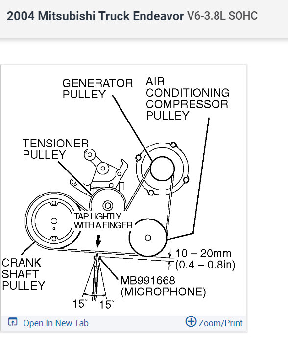

I have a 2004 Mitsubishi Endeavor XLS with 83,000 miles and a 3.6 engine. It started to make a squealing noise when I hit 35 mph and get louder after 40mph. Sounds like a belt squealing. When I back of the gas, and the odometer hits 35mph the noise stops instantly. I tried to make the noise with the car in park and just give it gas, but it didnot squeal, only when I am driving. Could it be belts or a water pump. Both are original.
Thanks

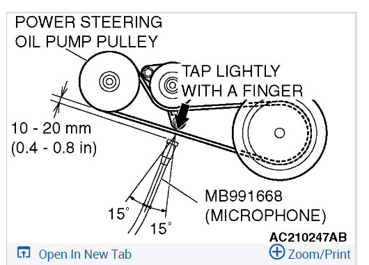

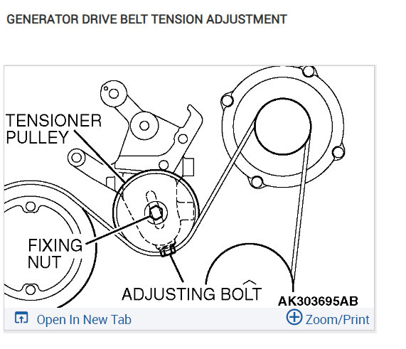

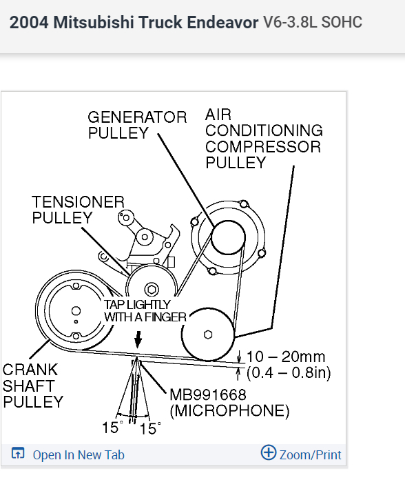

It still can be the belts, I would open the hood to inspect the tension and condition of the belt and replaced it if needed, here is how in the images below. Check out the images (below). Please upload pictures or videos in your response of any problems so we can see what to help you with.
