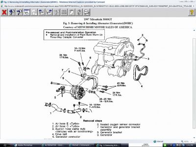

HELLO GUYS,I HAVE A 1997 MITSUBISHI 300GT BAS MODEL,MY ALTERNATOR CURRENTLY WENT BAD,IS THIS A FIX I CAN DO MYSLEF IF SO HOW CAN I DO IT,ANF IF NOT HOW LONG WILL IT TAKE AN ACTUAL MECHANIC TO DO IT ,IT HAS 58000 MILES

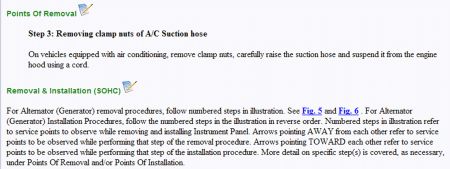

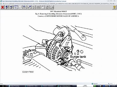

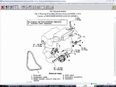

Not knowing how handy you are I couldn't say...2 concerns are DOHC or SOHC? Gen or alt/gen?
