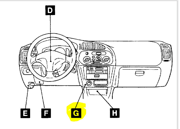

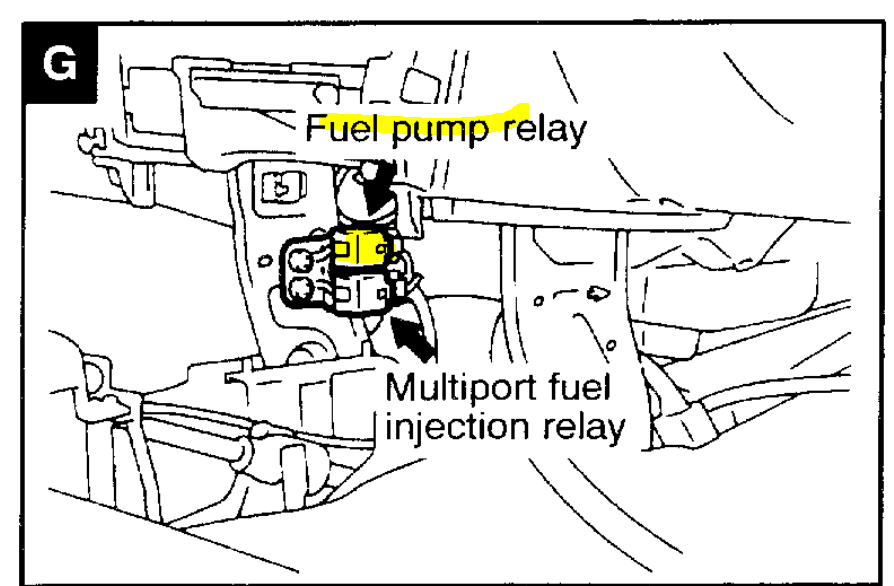

Where would I find the Fuel Pump Relay on my Mitsubishi Mirage 2000?

The fuel pump relay is located inside the vehicle, under the dash. It is approx centered in the vehicle.
If you look below, pic 1 shows the location. Note that the relay is behind the dash in that area. Pic 2 identifies the fuel pump relay.
