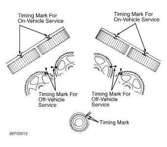

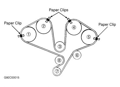

Im in the process to replace the timing belt for it's 60K maintenance. i have removed everything and am now reassembling the car with all new parts. i made marks of where the timing belt meets the pulleys but just to make absolutely sure, what marks are there on the timing belt pulleys that i can use as a reference to confirm the timing is correct before i start it up and have it go BANG! ?

Hi there,
I will need a model & engine displacement to get the correct information.
Mark (mhpautos)

Sorry, i forgot to mention it is a 1996 3000gt 3.0Litre dual OHC

Hi there, I am having trouble locating a clear picture so i hope that these will help. Mark (mhpautos)

Thank You mhpautos. I found the timing marks putting the engine back together and now it purrs like a cat.
