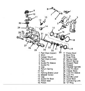

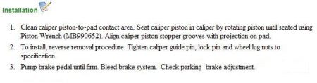

need instruction on how to replace rear brake pads on a 1994 eagle talon

https://images.2carpros.com/forum/automotive_pictures/261618_Noname_941.jpg
https://images.2carpros.com/forum/automotive_pictures/261618_Noname2_256.jpg
FIG. 3
https://images.2carpros.com/forum/automotive_pictures/261618_Graphic_167.jpg
