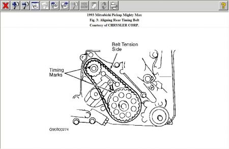

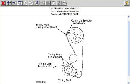

I have a 93 Mitsubishi the timing belt went out, but now I need to put a new belt in but it has 4 pulleys and they all have timing marks but they are all over the place. So if anyone has a diagram to see where they go it'd be appreciated.
Aug 22, 2008 at 6:07 PM
  • 75,992 POSTS
Put the engine no.1 piston on its compression stroke/TDC and line everything up as you see below
